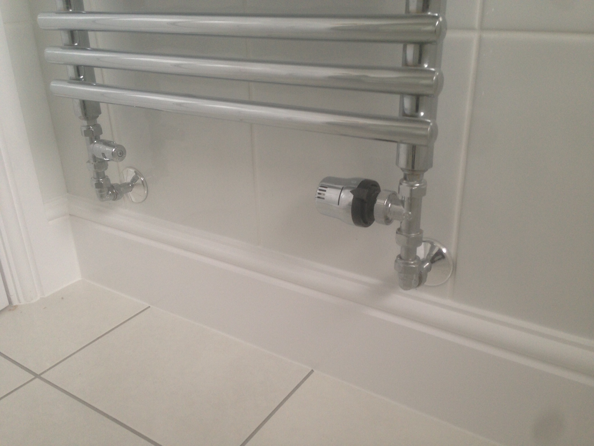

Nickfromwales Posted May 30, 2016 Posted May 30, 2016 You wouldn't want to create high spots / points by going up behind each rad and then back down to the valve. That would, particularly with Microbore and its lower velocity, create air locks. I come up from underneath directly on the centre of the rad valve and have a small piece of pipe between the wall and the valve. I know this is a towel rad, but same principle. Same thing just 15mm and chrome. You can get 10mm white plastic covers and pull bends in the 10mm copper to make them look as neat as possible.

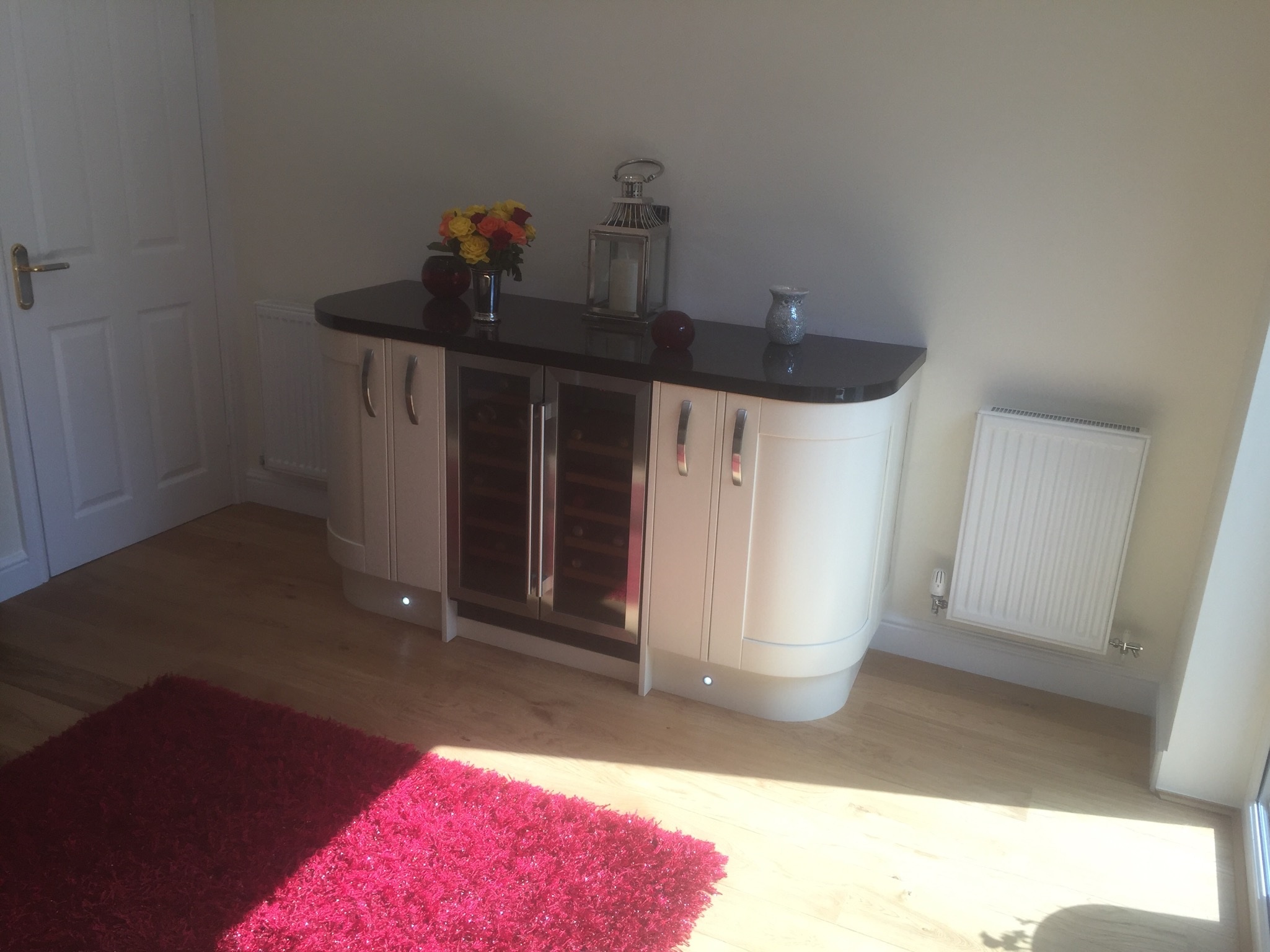

Nickfromwales Posted May 30, 2016 Posted May 30, 2016 Ok. Just switched my iCloud picture sharing back on.....hadn't realised it was off. Bloody kids. the perspective makes it all look out of square but it's just because it was a close up. That's the way I pipe rads up. I'm not a fan of the bent irons in the valve with the pushfit going in tbh. Looks lazy to me These were rads I fitted on the last kitchen fit, either side of the wine servery so had to look good 18 bags of self leveller went in under that oak floor. 0-19mm over 3 metres.

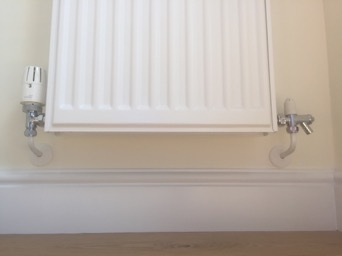

Nickfromwales Posted May 31, 2016 Posted May 31, 2016 Either by looping the pipe up behind or by fitting a bend and a male to female ( M&F ) bend back to back. This is mostly done on site to speed up a build, and is very typical of mass produced or commercial builds. Then the pipe goes behind the rad and into one of these angled rad unions.
Oz07 Posted May 31, 2016 Author Posted May 31, 2016 I wondered about the air lock of looping it up behind. Perhaps it doesn't cause a problem if they're prepared to do it
Barney12 Posted May 31, 2016 Posted May 31, 2016 These are pretty standard on new builds these days. IMHO they look awful and the big developers don't always manage to hide them behind the radiator, let alone put them on level or central! BODGE! (My 2ps worth!, sorry!)
Nickfromwales Posted May 31, 2016 Posted May 31, 2016 Yup. Lazy way of piping imho. Typical of new mass produced builds......quick and easy, and as long as it works until the cheques cleared. I'll stick to my method. OZ, the writings on the wall..,,,,.plate
