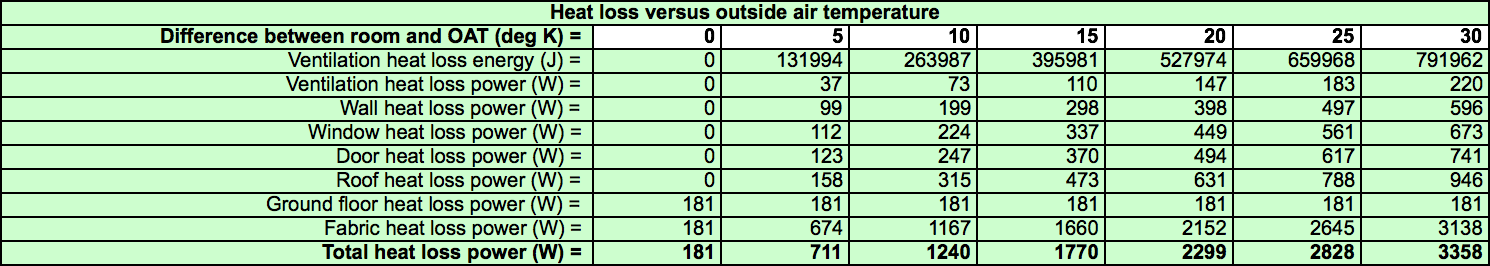

Chanmenie Posted May 8, 2022 Share Posted May 8, 2022 So have filled in Jeremy's Heat loss spreadsheet does this mean my heat loss is 3.4 KW per day in December 2 -10deg ? if so what size heat pump should I be looking at Link to comment Share on other sites More sharing options...
ProDave Posted May 8, 2022 Share Posted May 8, 2022 It means when it's -10 outside and +20 inside the house will need a continuous heat input of 3.4kW or averaged over 24 hours 81.6kWh Sizing the heat pump, you have to allow for it also heating hot water (when it won't be heating the house. So a 5kW ASHP for instance, assume it will be heating hot water for 2 hours per day, and lets guess that it might only manage 4kW output at the low temperature, it could deliver 88kWh so should be adequate. But would need to run almost 24/7 to manage when it is that cold. So if you wanted the heating off over night for instance you might consider something a little larger. I don't imagine it gets that cold for very long in Norwich so you might not need that much heat very often. Link to comment Share on other sites More sharing options...
JohnMo Posted May 8, 2022 Share Posted May 8, 2022 If you read MCS manual it states "Heat pumps should be selected as closely as possible to the design heat demands. MCS Standard MIS 3005, requires the unit to achieve 100% of the duty at an external temperature condition exceeded for 99.6% of the year, if reasonably practicable. " So the delta T of 25 should really be used - 2.8kW. not 30 degC which possibly only occurs for a day or so per year. So you need to look at the data sheets and make sure at the output can match that. You need to make sure you can turn down enough at warmer temperatures (much more normal than the lowest extreme) so that you don't short cycle 1 Link to comment Share on other sites More sharing options...
