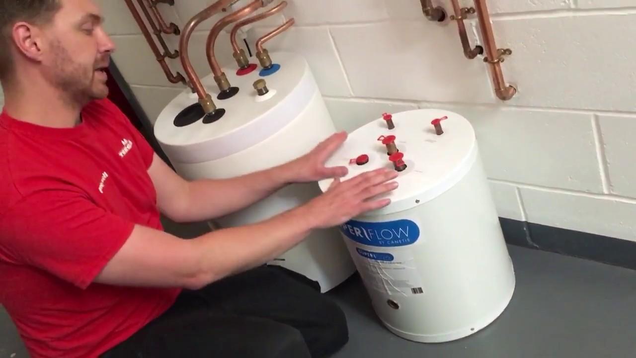

JohnMo Posted August 8, 2023 Share Posted August 8, 2023 47 minutes ago, JamesPa said: Nevertheless I have been trying in parallel to reimagine the vented cylinder. I'm thinking Rectangular footprint so it fits in a cupboard Fully sealed except the overflow Pumped hot water (with option for matched cold water to deal with combining outlets). Pump would need a small accumulator so that the tank could be below the outlets. No header tank Overflow to convenient drain or outside if available at user option Is this one they inverted earlier - but round. Available in direct and indirect. Filling controlled by ballcock. https://www.screwfix.com/p/rm-cylinders-indirect-vented-combination-cylinder-85ltr-900-x-450mm/58056?tc=TA5&ds_rl=1249404&gclid=Cj0KCQjwz8emBhDrARIsANNJjS5MEl-8asvGrJRypWI7b_-_BttGe55t0lnawxdP2fAMuuTmHtrhWFgaAgM3EALw_wcB&gclsrc=aw.ds Link to comment Share on other sites More sharing options...
JamesPa Posted August 8, 2023 Share Posted August 8, 2023 8 minutes ago, JohnMo said: Is this one they inverted earlier - but round. Available in direct and indirect. Filling controlled by ballcock. https://www.screwfix.com/p/rm-cylinders-indirect-vented-combination-cylinder-85ltr-900-x-450mm/58056?tc=TA5&ds_rl=1249404&gclid=Cj0KCQjwz8emBhDrARIsANNJjS5MEl-8asvGrJRypWI7b_-_BttGe55t0lnawxdP2fAMuuTmHtrhWFgaAgM3EALw_wcB&gclsrc=aw.ds Not quite, this has a cold header tank above. Link to comment Share on other sites More sharing options...

JohnMo Posted August 8, 2023 Share Posted August 8, 2023 1 hour ago, JamesPa said: Rectangular footprint so it fits in a cupboard - easily doable Fully sealed except the overflow - isn't that an UVC Pumped hot water (with option for matched cold water to deal with combining outlets). Pump would need a small accumulator so that the tank could be below the outlets. Starting to get complicated and more expensive No header tank - cannot see any alternative to some form of heater to allow building regs compliance Overflow to convenient drain or outside if available at user option - easy done So basically an insulated cistern. That's heated without anywhere to expand into I'm struggling with: a. the fill mechanism - simple and tried and tested is a ballcock b. keeping the vent hygienic to avoid the 'rats' objection Basically the full needs to be like a cistern, but with bottom entry for stratification. I'm not sure if there is a mechanical valve that does this and will work in a hot environment, it could perhaps be done with a level sensor and electric valve but mechanical would be better. Maybe a metal bodied torbek valve with a tube from outlet to bottom? Keeping the vent hygienic might be just making it small enough and putting a stainless steel mesh on it. Certainly that is better than an open, or even lidded, header tank in the loft Some comments in bold above Link to comment Share on other sites More sharing options...
Beelbeebub Posted August 8, 2023 Share Posted August 8, 2023 4 minutes ago, JohnMo said: Some comments in bold above I think @JamesPa means, is "Fully sealed" - a tight fitting lid for hygiene rather than pressure sealed. The pumps are commodity items, they have a small accumulator and check valve built in. Fit and forget. If it breaks, swap out. "No header tank" - i think he means not the traditional large F&E tank in the loft. If you have a pumped system you don't need the F&E tank in the loft anymore. It doesn't need to be as big as an 8l capacity would be ample to account for expansion. That could be easily integrated into the top of the tank even if it's nitnthe highest point in the system. The ballcock would probably do, but you'd probably want something a bit more advanced, both to start and stop quicky and to deliver high flows quietly. Maybe something more like modern toilet fill valves (also more compact). Link to comment Share on other sites More sharing options...

JohnMo Posted August 8, 2023 Share Posted August 8, 2023 Not really seeing anything different from the link provided to that drawn above. Except the expansion tank is very small. Although similar to my previous link, this is smaller could be positioned where a combi boiler came from (900x400mm), on a simple shelf. It has a heating coil, and everything after that is customisation friendly, maybe even get a bigger coil if you asked and if there enough space for it. https://newarkcylinders.co.uk/product/newark-indirect-combination-cylinder/ Link to comment Share on other sites More sharing options...
Beelbeebub Posted August 8, 2023 Share Posted August 8, 2023 32 minutes ago, JohnMo said: Not really seeing anything different from the link provided to that drawn above. Except the expansion tank is very small. Although similar to my previous link, this is smaller could be positioned where a combi boiler came from (900x400mm), on a simple shelf. It has a heating coil, and everything after that is customisation friendly, maybe even get a bigger coil if you asked and if there enough space for it. https://newarkcylinders.co.uk/product/newark-indirect-combination-cylinder/ Yeah, not much difference, except packaging. Key bit would be that it was a "box on the wall" hanging where the boiler was. The pipes from outside would come in via the flue (possibly in an insulated duct, so looking exactly like a flue) Flow and return would come out the bottom, cold feed in and DHW out would also come out the bottom. The drain would go where the condensate line goes. Plus a bigger 10kw freed from the consumer unit. This is for the "direct swap with a combi" cases. Gives near as possible to combi like performance and packaging. People existing tanks or space for a new tank could have a UVC or VC as they desire. Link to comment Share on other sites More sharing options...
