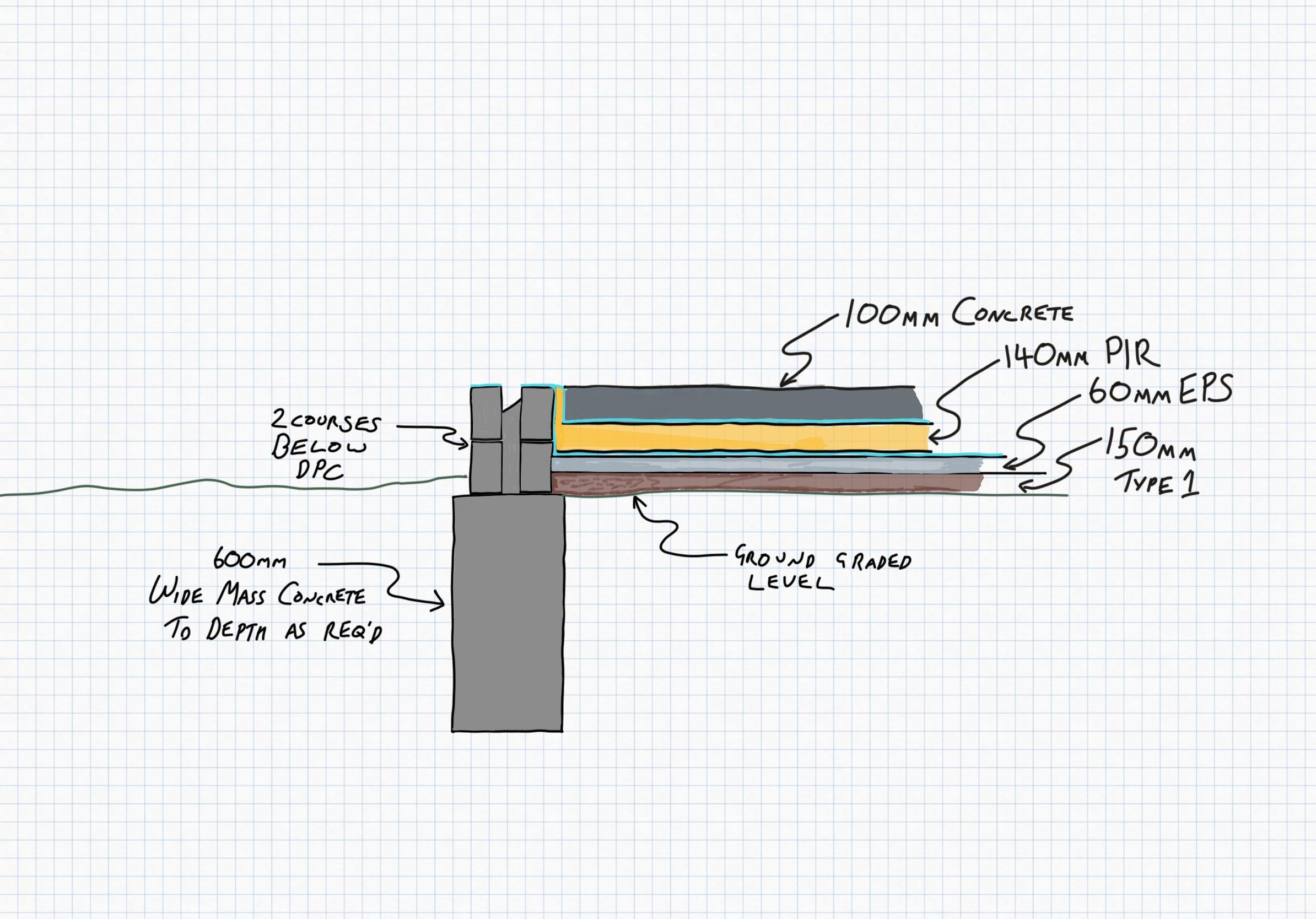

HughF Posted April 23, 2022 Posted April 23, 2022 (edited) Providing I can figure a solution to get air to the air bricks on the back of the house, for ventilation under the suspended timber, how does the following build up sound: 75mm reinforced concrete with 16mm al-pex tied to mesh slip membrane 140 pir dpm 60 eps sand blind 150mm type 1, whacked Bought a job lot of cheap 140 pir on impulse the other night so trying to figure out how best to use it 😂 Will the bco be happy with that buildup given that we’re building over a sewer, the long way, all the way to our boundary. This is a standard rear extension on an end of terrace. Edited April 23, 2022 by HughF
jayc89 Posted April 24, 2022 Posted April 24, 2022 You could probably do away with the sand blinding given you have EPS under the DPM too. Where did you get the cheap PIR from?
tonyshouse Posted April 24, 2022 Posted April 24, 2022 I hate sand blinding as it percolates through the hardcore like sand flows through an egg tier over time leaving voids min 100mm concrete, depending on size of the space could bev125mm.

HughF Posted April 26, 2022 Author Posted April 26, 2022 On 24/04/2022 at 20:51, Russell griffiths said: I would want 100mm concrete minimum. I’ve got 100 in my garage and have high point loads (machinery), 100mm in a residential floor should be fine, surely? 1

HughF Posted September 12, 2022 Author Posted September 12, 2022 Been getting used to using concepts on the iPad for sketching, this is the planned floor detail.
