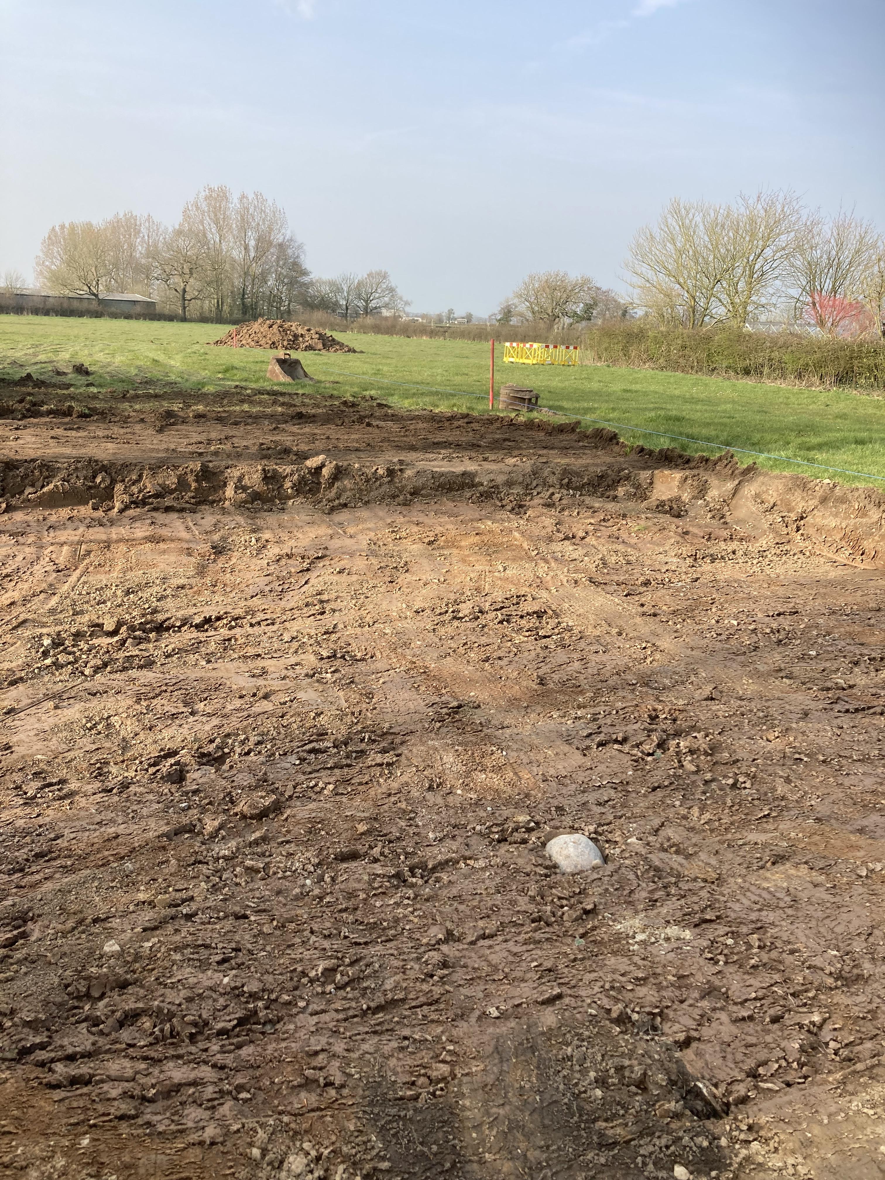

nod Posted April 21, 2022 Posted April 21, 2022 We’ve just start our second build -third We have purchased three acres of open country side Difficult but not impossible
Zmarie Posted April 22, 2022 Author Posted April 22, 2022 13 hours ago, nod said: We’ve just start our second build -third We have purchased three acres of open country side Difficult but not impossible Exciting! Purchased with planning or did you do yourselves? Under Paragraph 80 I'm assuming?
nod Posted April 22, 2022 Posted April 22, 2022 It had planning in principle for two detached homes Just the £500 type couple of squares on a field But lots of work done by us to get full planning
