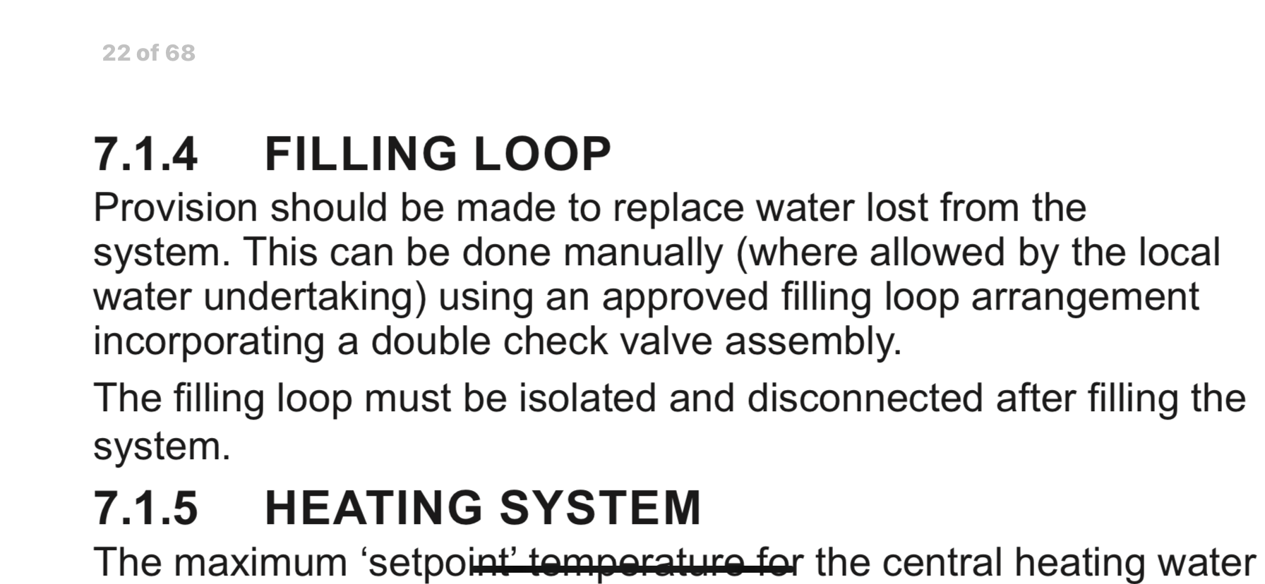

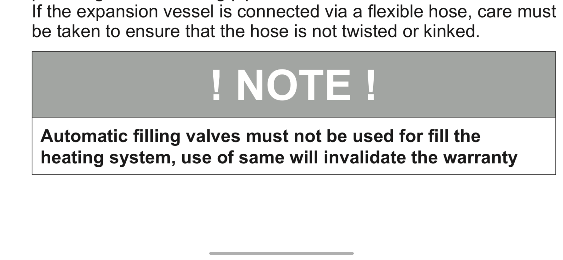

Nickfromwales Posted April 20, 2022 Posted April 20, 2022 9 hours ago, Bemak said: It's a GRANT VORTEX MODULE 50-90 HE Thanks. OK, the valve you’re fiddling with…..STOP! That is an automatic filling valve which allows the system to self-maintain pressure in the system to a pre set value. Not seen one before, but I have installed these before by buying the components and forging them in. Interfering with that valve is BAD. So, You should have an external filling loop, OR your system is “open pipe” and gets filled by a header tank aka F&E ( feed and expansion ) tank usually up high or in attic space. You need to look for a silver flexible hose with 2 chrome valves either end with taps on one or both. We need to know if this is a sealed and pressurised system or not. Having the automatic fill valve and a pressure gauge does not mean that you have a pressurised system. The plumber is a cock if he didn’t fully explain all this to you. 😑🙄 3
