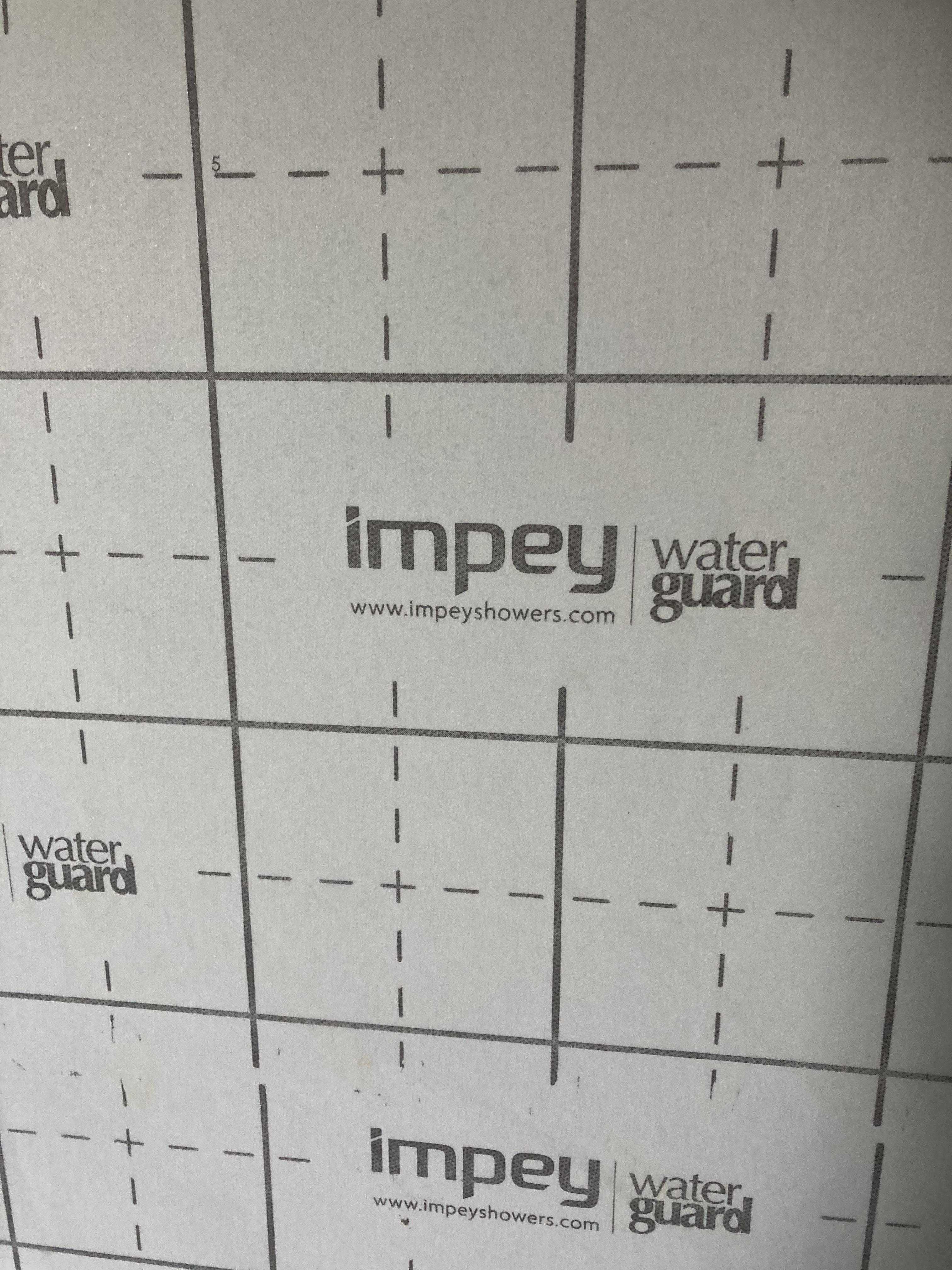

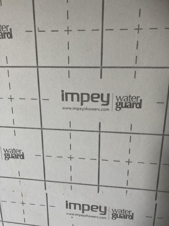

nod Posted April 14, 2022 Share Posted April 14, 2022 I’ve used Impey water guard amongst others Cost effective without any issues Link to comment Share on other sites More sharing options...
