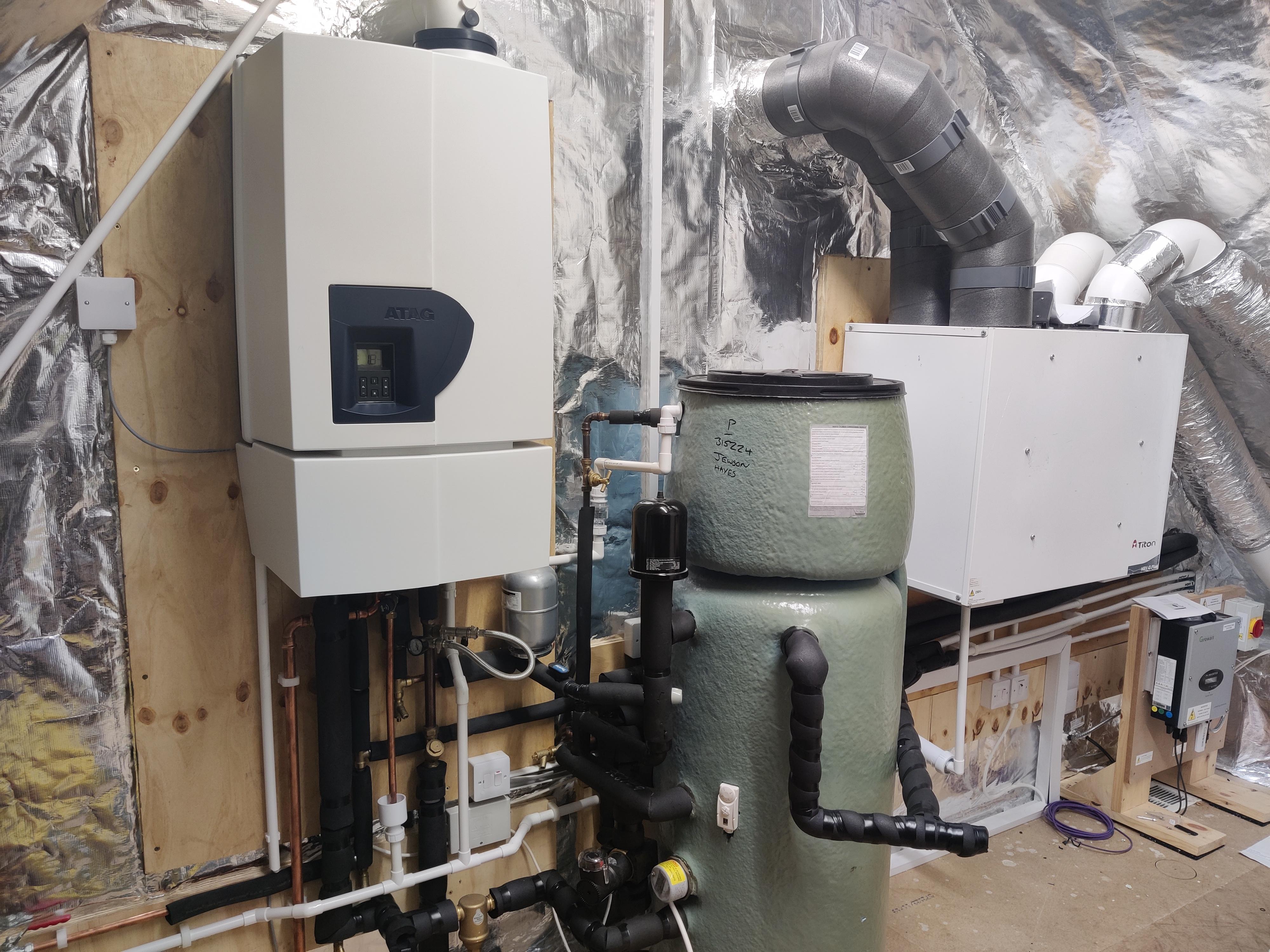

Posted (edited)
To expand on what Nick has said.
Our system is pretty much as described above, minus the accumulator.  Which I have thought about also.
Our combi heating circuit is connected to the heating coil in the thermal store only. The cylinder is heated to 34 degs with a 4 deg hysteresis. Boiler heating temp is set to 35 degs with a max temp of 55 degs.  On our boiler we are able to set the gradient of the heat input, so have set as low as possible.  The boiler starts when the cylinder is at 30 degs, and takes around 20 mins to heat the cylinder to 34 degs, very slowly ramping up the temperature output of the boiler.  Boiler stays in full condensing mode at all times.
UFH pipes are connected to thermal store.  UFH manifold temp set at 30 deg.
We have an immersion in the cylinder also connected to solar PV and will be adding solar thermal in the summer, to displace some gas usage.
DHW goes through the DHW coil at the top of the thermal store prior to going in to the boiler.
Edited by JohnMo
Add photo

I'm a real novice, do you mean you have a thermal store and a cylinder, or are they the same? What's the white box in your picture? I have space for a cylinder (or similar) and the boiler in my outside store) cupboard.
thanks again
Posted
The green/blue cylinder is actually a thermal store, which I referred to as a cylinder.  Sorry this may have confused.
The white box on the left is the combi boiler.  The one on the right is part of the ventilation.
Posted (edited)
Thanks for clarifying, yes, I meant the box on the right. Thought it was heating related
