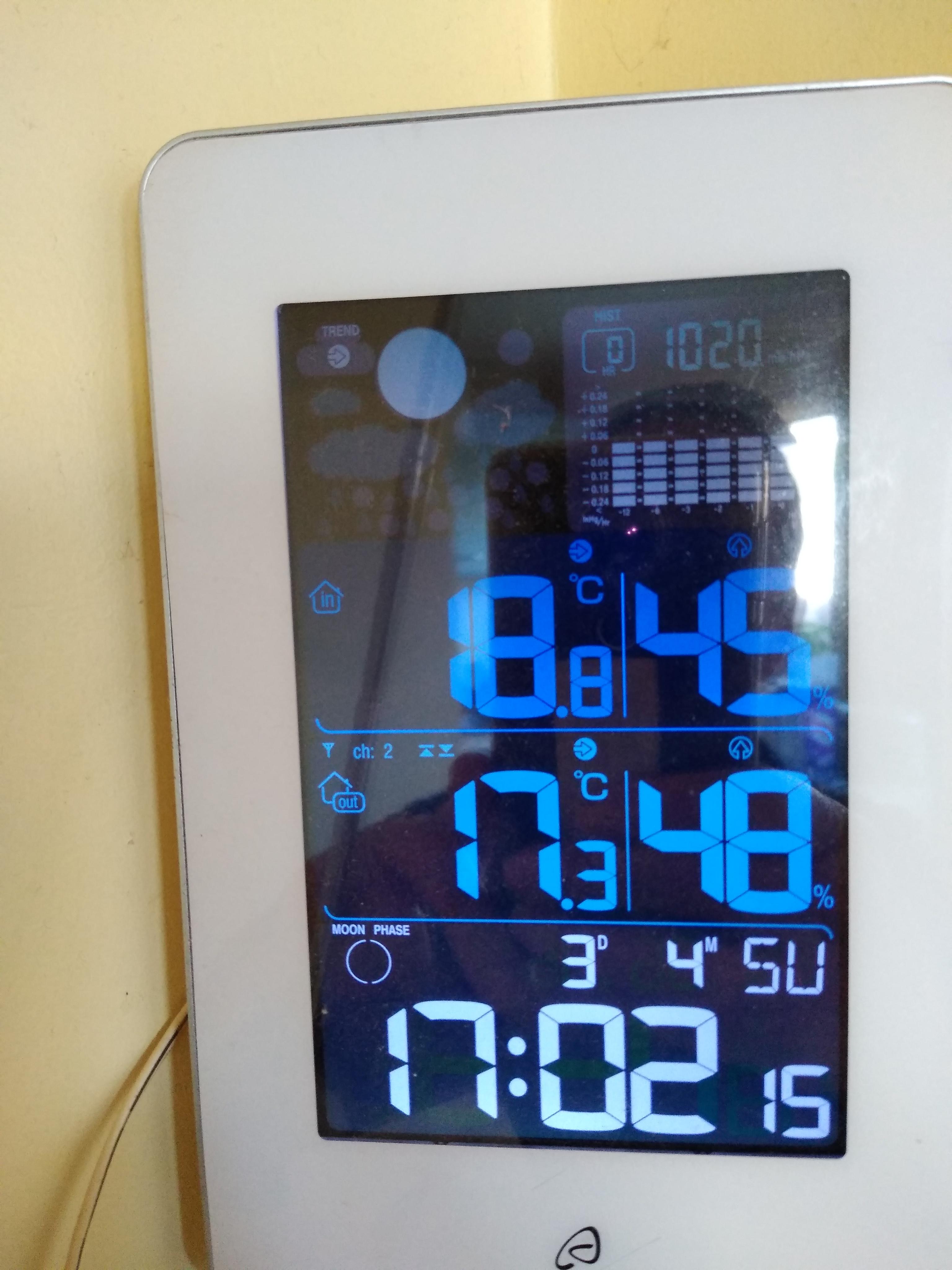

SteamyTea Posted April 3, 2022 Posted April 3, 2022 (edited) 41 minutes ago, Radian said: sophisticated prediction algorithms So does my cheap Lidl weather station. And it is spookily accurate. Except for the time, but UTC is better. Edited April 3, 2022 by SteamyTea
Radian Posted April 3, 2022 Posted April 3, 2022 Is your outdoor probe just lying on the floor by any chance?
SteamyTea Posted April 3, 2022 Posted April 3, 2022 1 hour ago, Radian said: Is your outdoor probe just lying on the floor by any chance? Yes. I forgot to put it back outside when I changed the battery, it is somewhere under the workbench I think.
