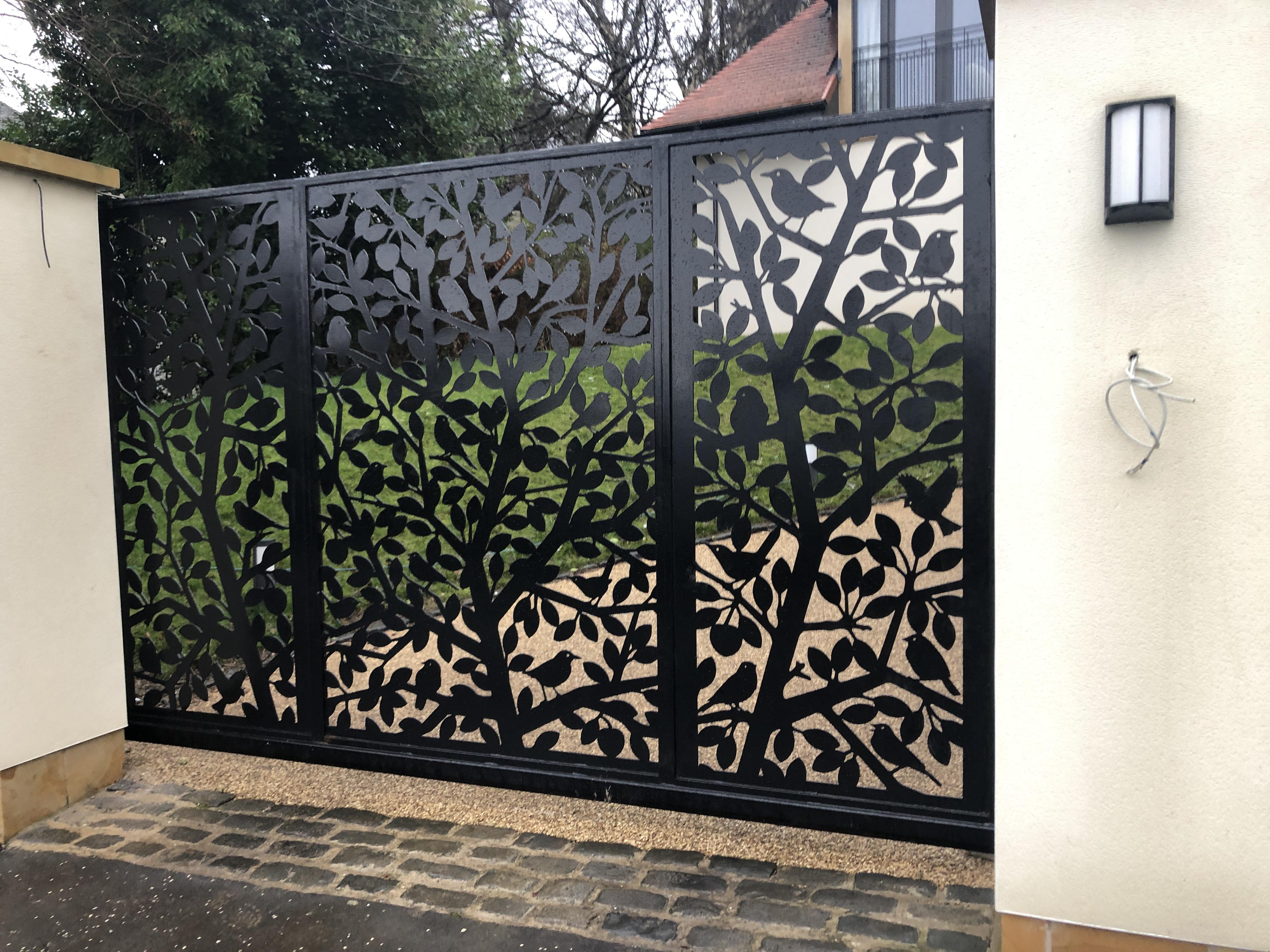

The old roads in Edinburgh are made of granite setts. We have three rows under our gate.
They are slippery to cars but I have never had an issue walking on them, even when wet. Looks like a high number is better slip resistance. Our riven sandstone paving slabs are more slippery when wet.

1/10 is a steepish slope. Looking at them they have quite a rough surface so I think you are OK. The granite setts in Edinburgh are smooth and lethal in frost. The ones you are looking at are much rougher than the ones under my gate.

Nice entrance!
