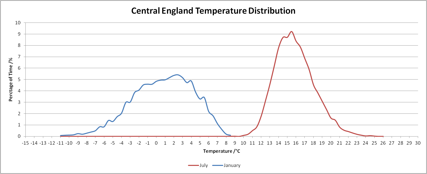

SteamyTea Posted March 23, 2022 Posted March 23, 2022 (edited) On 23/03/2022 at 07:23, ReedRichards said: Does being more oversized cause a heat pump to lose efficiency Expand Generally no. There has to be a distinction between oversizing for the worst case, and over sizing the the most likely case. This is why knowing your local weather profile is important. An example, based on the Central England Temperatures for January and July shows several things. January is, on average, colder than July (3.5°C, 16°C. January has a larger spread of temperatures than July (19.5°C, 16.5°C). Both months are pretty evenly distributed around the mean (0.91, 0.89), but the kurtosis is visually quite different, with January being flatter (platykurtic) than July (leptokurtic), though the number, which really measure the tails, not the peaks, are not so different (0.3, 0.2), showing that the distribution is normal. So to get 99% heating via an ASHP, you need to find a model that does not drop below a CoP of 1 down to -6°C for your given flow temperature i.e. 35°C. DHW heating will have a different (higher) flow temperature i.e. 55°C. That is where you may struggle. Edited March 23, 2022 by SteamyTea

ReedRichards Posted March 23, 2022 Posted March 23, 2022 (edited) I'm never sure about the correct way to interpret such temperature distribution curves @SteamyTea. It's typically coldest in the middle of the night and I use a night time set-back temperature of 2.5 C so my heat pump can cope with a colder outside temperature overnight because I'm not asking it to work so hard. And that is if it comes on at all, almost always the retained heat is sufficient that it does not need to come on until it starts warming up the house in time for me to get up. Given that my heat pump is rated to keep the house at 21 C down to -3.8 C outside, I would only be in real difficulty if the temperature did not get as high as -3.8 C for 24 hours or more. Edited March 23, 2022 by ReedRichards
SteamyTea Posted March 23, 2022 Posted March 23, 2022 (edited) On 23/03/2022 at 08:59, ReedRichards said: I'm never sure about the correct way to interpret such temperature distribution curves Expand We all struggle. The y-axis is the probability (or time, occasions, count), the x-axis is the classes (usually called bins) that demarcate the data (temperature, speed, wind direction). Taken at their most basic, all they show is the probability of something happening, and how often. This does not mean that something will happen, and if it does, it will last the same amount of time as it did previously. If you want to do that, then the usual way is to divide the time series into blocks i.e. 4 hours, pick the mean temperatures of the two previous blocks and see what those mean temperatures where. Then see if there is a correlation i.e. if it is 10°C now, what were the temperatures 4 and 8 hours ago. You can, if you want to get really predictive, look at historical data and see what the temperature are during the following two blocks. Edited March 23, 2022 by SteamyTea
