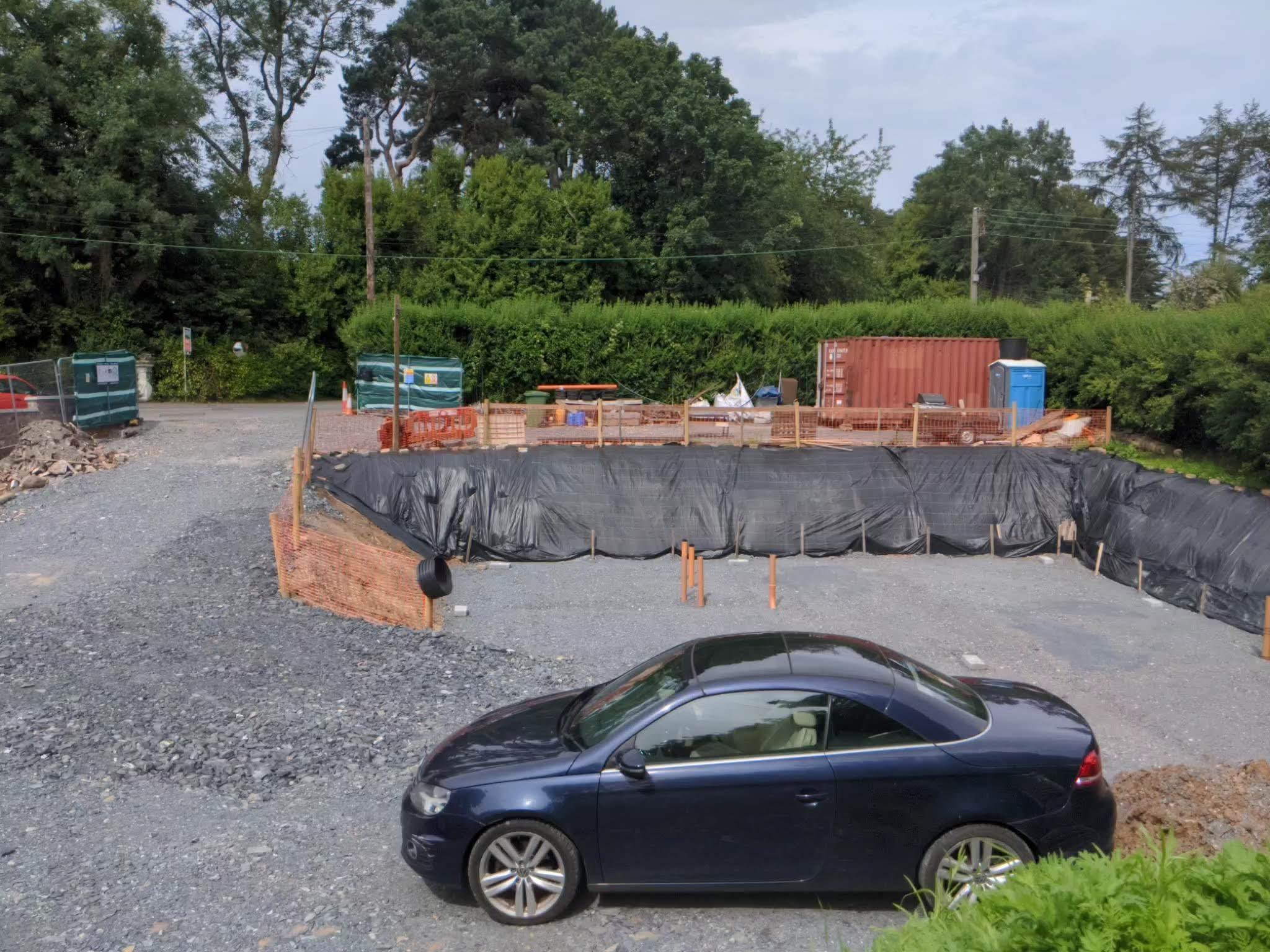

jimmyharris80 Posted March 22, 2022 Share Posted March 22, 2022 Hi all, Recent joiner here looking for some advice on our foundations/retaining wall/semi-basement on our sloping site. Here’s a pic of our site, I’ve marked on it approx where the new dwelling will be sited: We have PP for a three story dwelling, the ground floor is less than half the area of the first floor, you can see a few design 3D’s on my intro post here of how the dwelling is situated on site and what we are proposing, here is a sectional diagram showing the split level: The architect has added notional B&B flooring on both floors for BRs, I think we need to look at slab for ground floor as we will have UFH throughout (we're off grid so ASHP in the plans), first floor could be a little more complex as approx. half of it is over ground that slopes away. I’m struggling to see how this will all hang together and want to be clear on possible options we have and requirements when I instruct our SE. We only envisaged excavating for the ground floor, building up retaining walls and ground floor in blockwork with timber frame from 1st floor up. If we excavated the whole house footprint there would be considerable additional muckaway, retaining walls, etc for what would effectively be a ground floor void with no light and reduced head height. Any input you guys have would be hugely appreciated, if there's any other info, floorplans, etc that would help please shout and I can add them up. Thanks Link to comment Share on other sites More sharing options...

Bitpipe Posted March 22, 2022 Share Posted March 22, 2022 Did you get an actual topological survey of the site that can be imported into a cad tool? Our architect insisted on one before starting any work and it was a useful tool thereafter. Anyway, your GF looks over complicated. Why not push the retaining wall to the back of the build and have a contiguous slab and steal some extra space while you're at it? Could be a useful location for a TV/cinema room / plant / gym etc. The step down into dining room looks awkward and will restrict your usage if/when mobility becomes an issue. Easy enough to put ground level light wells back there too We built a passive TF on-top of a basement and it worked well, we just mimicked the passive slab design with SE specced EPS under the slab and on the outside of the concrete walls. Essentially you'd be doing a 3 sided version of this in block, ICF or cast concrete then have TF to the front and for the first floor upwards. Alternatively you could have the retaining wall discrete from the house structure and have a simple slab and TF construction from slab upwards. Link to comment Share on other sites More sharing options...
Conor Posted March 22, 2022 Share Posted March 22, 2022 (edited) We have a sloping site. Looked at all options, no basement, patrial basement, split level. Went for full basement with slab raft foundation. Worked out more expensive but we got much more floor area and a simpler build. And extra £19k for an additional 50m². Either do the same or at least get rid of the roasted bit adjacent to the dining. And speak to your SE sooner rather than later about foundation and retaining wall options. They will be able to advise on the best methods. Edited March 22, 2022 by Conor Link to comment Share on other sites More sharing options...
jimmyharris80 Posted March 22, 2022 Author Share Posted March 22, 2022 (edited) Hi Bitpipe, 54 minutes ago, Bitpipe said: Did you get an actual topological survey of the site that can be imported into a cad tool? Our architect insisted on one before starting any work and it was a useful tool thereafter. Yes, we did get a topo survey done and this was passed to our architect. 54 minutes ago, Bitpipe said: Anyway, your GF looks over complicated. Why not push the retaining wall to the back of the build and have a contiguous slab and steal some extra space while you're at it? Could be a useful location for a TV/cinema room / plant / gym etc. The step down into dining room looks awkward and will restrict your usage if/when mobility becomes an issue. Easy enough to put ground level light wells back there too This is what I was afraid of, even to my untrained eye it looks complicated. We have discussed extending the basement as an option, just need to consider additional costs of muckaway, retaining walls and slab as we're doubling the size of it if we go down this route. The step down was to increase head height in the kitchen/diner, I don't feel foregoing this would be a huge issue, the 1st floor would all then be on the same level with a ceiling height throughout of 2575mm which I think would be workable. 54 minutes ago, Bitpipe said: Alternatively you could have the retaining wall discrete from the house structure and have a simple slab and TF construction from slab upwards. This is what MBC suggested as the way to go when I spoke with them, it would mean a passageway around the basement level and bridges to access the garden from the 1st floor, we're getting into fairly significant redesign territory here I fear! Edited March 22, 2022 by jimmyharris80 Link to comment Share on other sites More sharing options...
Bitpipe Posted March 22, 2022 Share Posted March 22, 2022 (edited) 32 minutes ago, jimmyharris80 said: Hi Bitpipe, Yes, we did get a topo survey done and this was passed to our architect. Great, that will be useful for your SE also. 32 minutes ago, jimmyharris80 said: This is what I was afraid of, even to my untrained eye it looks complicated. We have discussed extending the basement as an option, just need to consider additional costs of muckaway, retaining walls and slab as we're doubling the size of it if we go down this route. Get a few quotes, you may be surprised. There are often economies of scale in groundworks. You may also save by simplifying other aspects of the design. Also, if you create extra space, you don't need to fit it out initially. 32 minutes ago, jimmyharris80 said: The step down was to increase head height in the kitchen/diner, I don't feel foregoing this would be a huge issue, the 1st floor would all then be on the same level with a ceiling height throughout of 2575mm which I think would be workable. Standard ceiling height is 2400mm (conveniently the size of a plasterboard sheet) our ground floor is just a smidge under this at 2350mm and it feels fine. First floor is 2300, also feels fine so 2575mm should feel spacious. 32 minutes ago, jimmyharris80 said: This is what MBC suggested as the way to go when I spoke with them, it would mean a passageway around the basement level and bridges to access the garden from the 1st floor, we're getting into complete redesign territory here I fear! Yes, works well for them as they don't do any concrete work other than the slab. However you can should get a quote for your own passive style slab & 3/4 basement wall from a groundworker - it's really just a concrete wall/slab with appropriate EPS underneath and to the sides. We did our basement like this and it was straightforward for MBC to drop their frame on the top. They waited until it was in place and came to do final measurements before putting frame into production so no surprises. You could have suspended timber floor for the dining / kitchen level also (would need some steel to support) and if you go for a low energy design then the UFH only needs to be in the ground slab - also that heating is in the slab itself, not on top, so you save on screed and on slab insulation. Edited March 22, 2022 by Bitpipe 1 Link to comment Share on other sites More sharing options...
Bitpipe Posted March 22, 2022 Share Posted March 22, 2022 33 minutes ago, jimmyharris80 said: This is what MBC suggested as the way to go when I spoke with them, it would mean a passageway around the basement level and bridges to access the garden from the 1st floor, we're getting into complete redesign territory here I fear! Not sure what value a passageway would add, you're effectively doubling up on the wall requirement (ok, in this scenario the rear wall is timber and the retaining wall more substantial). Link to comment Share on other sites More sharing options...
Thorfun Posted March 22, 2022 Share Posted March 22, 2022 I agree with @Bitpipe and @Conor here and you should think about pushing the retaining wall to the back. Makes it a lot simpler and the SE design for the load from the house to the existing planned basement retaining wall will be complicated and expensive and probably won’t be stupidly more expensive to just do a full dig out. that was the advice I was given by friends in the trade and others on this site and we don’t regret it. And like it was said above you don’t have to fit it out to start with but the space will be there when you have funds to do so. Exactly what we’re planning. (I go through a lot of this in our blog on here) Link to comment Share on other sites More sharing options...
jimmyharris80 Posted March 23, 2022 Author Share Posted March 23, 2022 (edited) Thanks for the responses guys, pushing the retaining wall back does make sense, additional costs, yes, but these would be balanced by the simplification it brings and the increase in square m on the ground floor, cinema room, gym, plant room are options here (budget won't stretch to the former two, but can leave unfinished with that as an option in the future). Plant room in here also frees up space in the utility which was doubling as our plant room. We do have a large garden where we could lose some of the soil by landscaping and we will need to backfill the SE side elevation so we can reduce muckaway cost here. A level change in the kitchen/diner would remove the need for steps/handrails and will reduce the height of the bifolds and windows, both will bring costs savings (not huge, but savings nonetheless!). First floor can then have all timber joists throughout instead of mixed timber/concrete, whether this saves cost I'm not sure but certainly looks simpler from a design/build perspective. The next logical question here is the impact on our planning permission, I would hope the change in window/bi-fold sizes would be classed a non-material amendment, but building out the basement and increasing the sq m on the ground floor and adding access to the basement rooms from the hall/bedroom 1, would that require a new planning app? Fundamentally the super-structure remains as is in size and form so I would hope the planners would be sympathetic to that, but who knows with the planners, all a bit of a lottery. Here's what we have approved at present with my amendment overlays in yellow as I see them: Any views on planning implications? I can stick a post on the planning forum to garner opinion before I have an initial chat with architect, just conscious of starting too many concurrent threads! Edited March 23, 2022 by jimmyharris80 Link to comment Share on other sites More sharing options...
