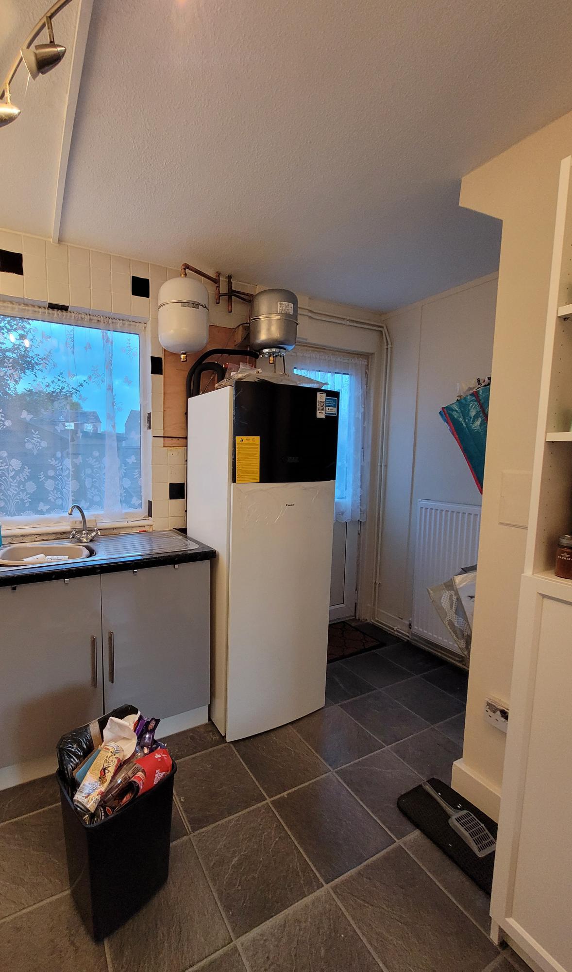

Green Power Posted October 20, 2022 Author Share Posted October 20, 2022 On 19/10/2022 at 12:45, HughF said: It’s encouraging that you’ve ended up with a cheap install, that’s good. May I ask what you’re getting for that? New ashp, uvc, rads etc? It is a hot water tank, a heat pump (internal and external unit), mostly used existing radiators but added 2 more, and all the labour and materials etc. I am not sure what you mean by uvc. Do you mean ultraviolet light to stop Legionnaires' disease developing in the water tank? If so, I don't know whether that feature was included or not. Link to comment Share on other sites More sharing options...
SteamyTea Posted October 20, 2022 Share Posted October 20, 2022 2 hours ago, Green Power said: uvc Unvented Cylinder. What stores the hot water. Link to comment Share on other sites More sharing options...

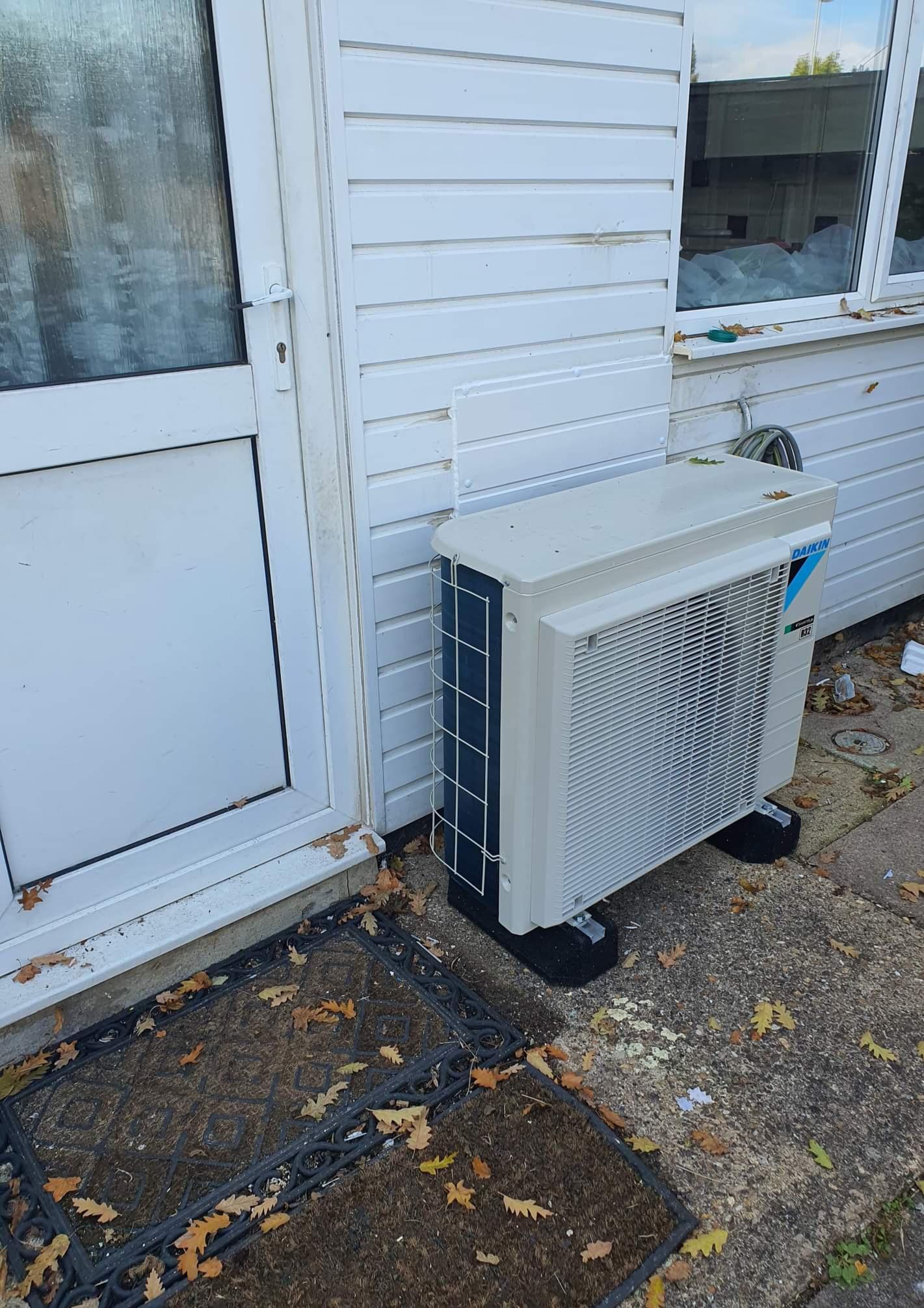

Green Power Posted October 26, 2022 Author Share Posted October 26, 2022 The internal unit includes a hot water tank and is model number EHVH04SU18E6V and has a 6kW backup immersion heater and a 180-litre tank. The external unit is ERGA06EVA and has a nominal heating capacity of 5.90kW. Daikin is the supplier. Link to comment Share on other sites More sharing options...

Green Power Posted October 28, 2022 Author Share Posted October 28, 2022 Just got some feedback from the tenant that neither they nor the next door neighbour (who is pretty close with it being a terraced house and the heat pump sited near to them) can even hear it. So that's good that the noise is low. Link to comment Share on other sites More sharing options...
PhilT Posted October 28, 2022 Share Posted October 28, 2022 2 hours ago, Green Power said: Just got some feedback from the tenant that neither they nor the next door neighbour (who is pretty close with it being a terraced house and the heat pump sited near to them) can even hear it. So that's good that the noise is low. It is now but it will get louder as the temp drops to frost levels and the fan speeds up a lot. Everyone should be inside at those times so not really a problem 1 Link to comment Share on other sites More sharing options...
