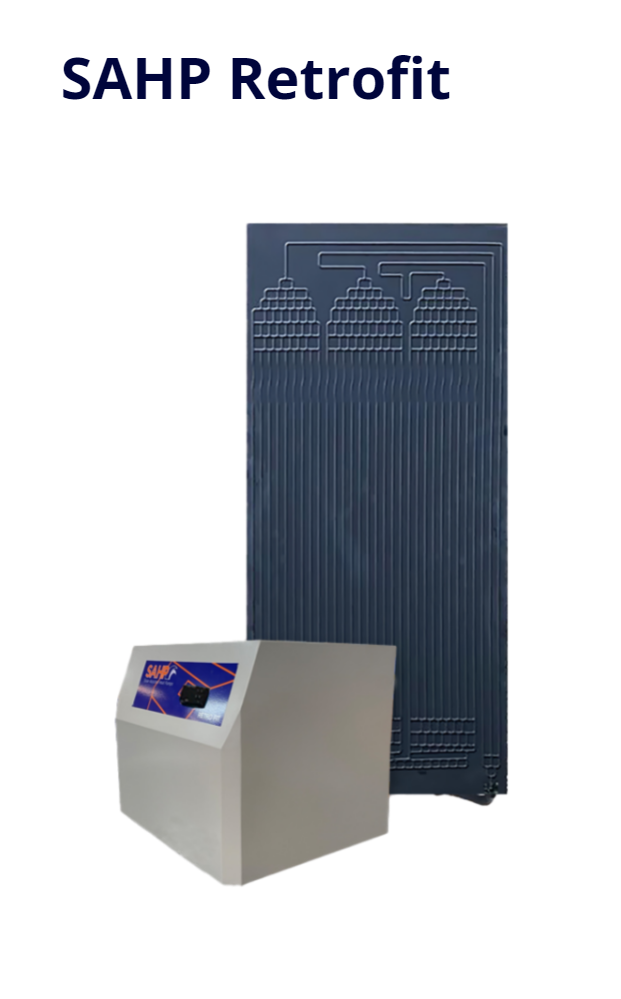

What about a solar assist heat pump, they are generally around 2kW, come with 2 off 2x1m panels for outside though and they need to be mounted. Or if you like engineering something, could you use a  car Aircon condenser and car fan, instead, mount in a custom box. Use it to heat a 50/100 litre cylinder with coil and take the UFH water from that.
Very intriguing, not seen this before!
1878181039_Screenshot2022-03-1614_27_36.thumb.png.50072f1583d0ac5210f4dae2f46e5686.png
Says the panels can be wall mounted. 2kW out for 500W in. Perfect... If only I could find a price someplace.
