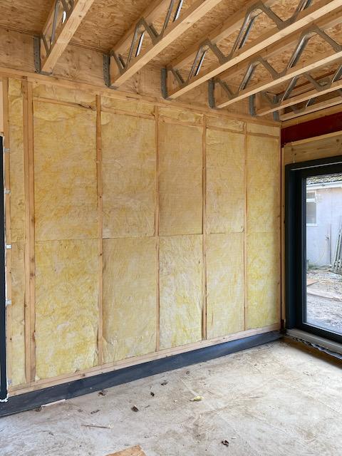

Thorfun Posted March 10, 2022 Share Posted March 10, 2022 I used Isover 32 batts and worked perfectly for 600mm centre studs. ironically though in our house there aren't too many studs that are 600mm centres due to panel joins, extra studs for support of windows etc. so we ended up having to cut a lot of it anyway. https://insulation-uk.com/products/isover-timber-frame-batt-32 this is the stuff we used. got it from Jewsons. 1 Link to comment Share on other sites More sharing options...

Mr Punter Posted March 10, 2022 Share Posted March 10, 2022 3 hours ago, DragsterDriver said: is actis hybris any good? There is quite a lot of controversy about claimed u values for multi foil type products but my main concern for this would be flammability. Even though flame should not penetrate your plasterboard I would not want to deal with an outbreak of fire in a concealed void. Get a sample and hold a match under it. 1 Link to comment Share on other sites More sharing options...
JohnMo Posted March 10, 2022 Share Posted March 10, 2022 Rockwool, Knauf and plenty others do something similar to frametherm. Look at insulation hub, they tend to have good prices and normally free delivery. Found what ever centres you have it all needs cutting. 1 Link to comment Share on other sites More sharing options...
