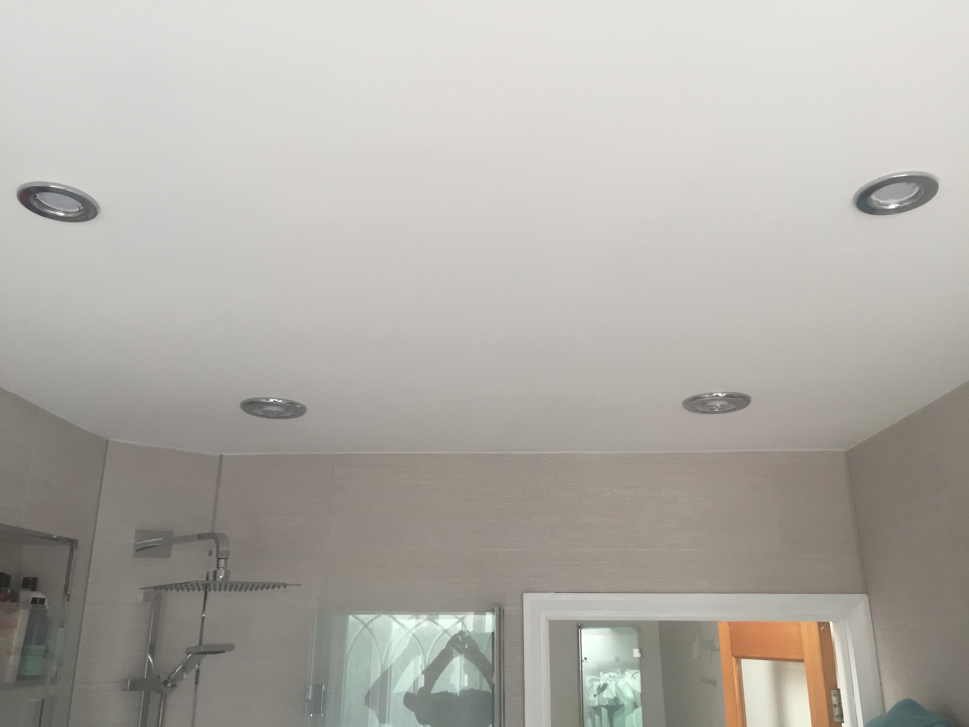

Jeremy Harris Posted May 31, 2016 Posted May 31, 2016 If the lights fall inside the SELV rules, then my understanding is that they don't need to be IP rated above IP55, and only need that if subject to water jets, if not, then IP44 is OK. The SELV rule is 12V AC or 30V DC, so LEDS running on 24V DC are inside the SELV rule. This is often overlooked or ignored, with there being lots of erroneous statements that "SELV is 12V", but that only applies to AC supplies, such as old-style halogen light transformers.
Trw144 Posted May 31, 2016 Posted May 31, 2016 Will double check on selv rules but I think the leds I m using elsewhere are ip20 rated.
Stones Posted May 31, 2016 Author Posted May 31, 2016 7 hours ago, JSHarris said: I fitted all our LEDs in the bathroom above the height limit, to avoid the need for IP-rated fittings. Then again, they are all 12V, so come under the SELV rules anyway. So provided I'm above the height limit, I could use these slim profile LED's that I originally linked to (be they the recessed or flush mounted type) without issue?
Jeremy Harris Posted May 31, 2016 Posted May 31, 2016 Yes, that's what I've done in our bathrooms. We have higher than normal ceilings, because of the room-in-roof design, so I just made sure all the lights were above the zone height limit, so no need for an IP rating.
Jeremy Harris Posted May 31, 2016 Posted May 31, 2016 If they are 24DC, yes. We have 12V DC LEDs in both our bathrooms, not IP rated, and they've been ticked off as being OK. Ours are set at 2.5m above the floor, IIRC, so well above the limit, and one of them is above the shower.

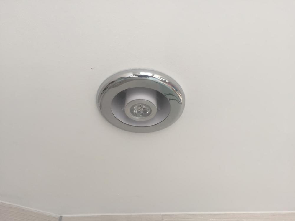

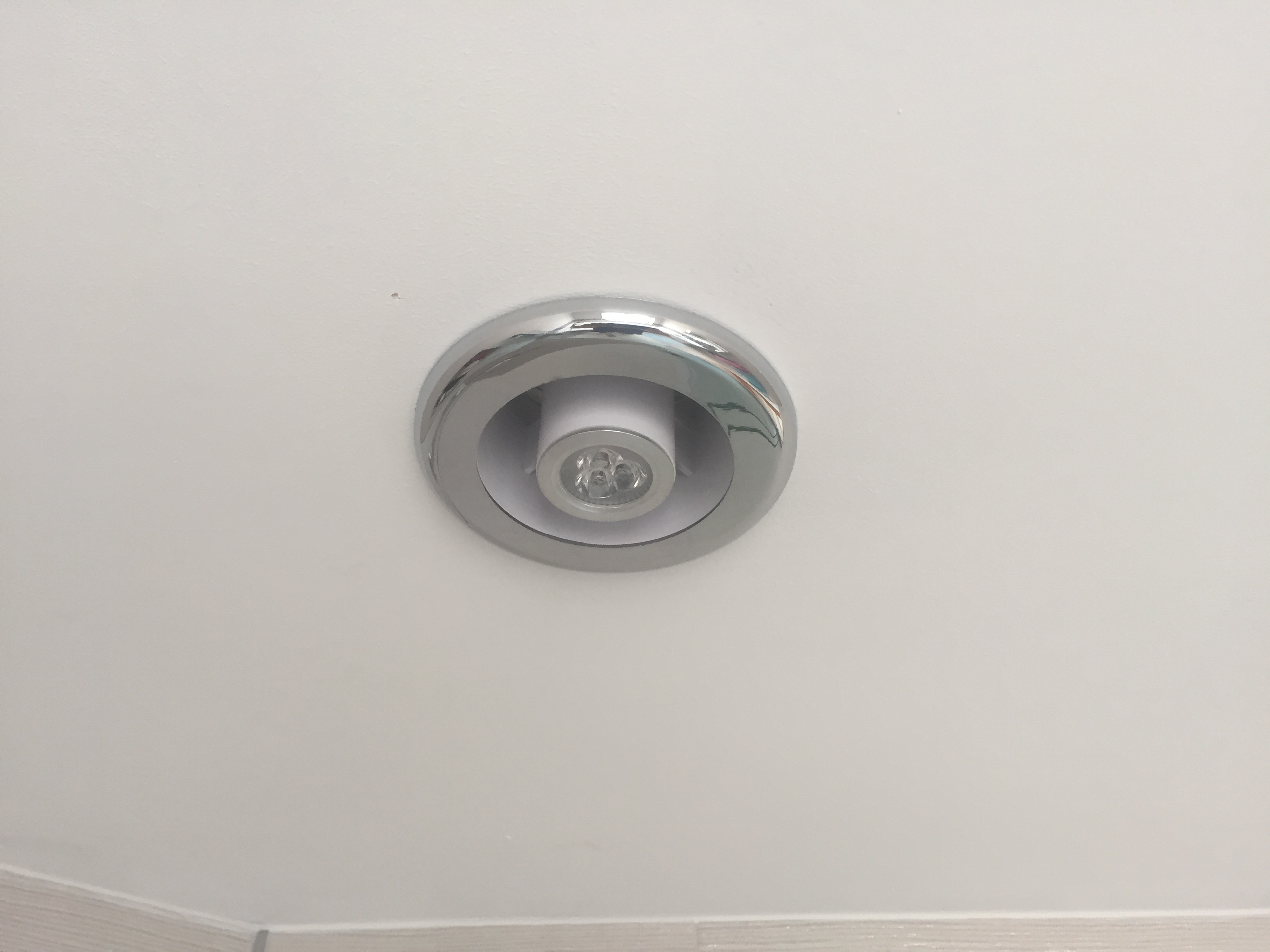

Nickfromwales Posted June 2, 2016 Posted June 2, 2016 These combined extractor / lights are what I use in every job. Maybe you could connect the mvhr to them and have one less item in the ceiling ? They come with an led lamp and driver for change of £25 each. Chrome or white bezel ( comes with both ). 1
Nickfromwales Posted June 2, 2016 Posted June 2, 2016 Cheaper than shoplifting. http://m.ebay.co.uk/itm/281298929759
Stones Posted June 2, 2016 Author Posted June 2, 2016 Nick, I'm assuming you normally install these using flexible ducting. Have you installed any with rigid ducting?
Nickfromwales Posted June 2, 2016 Posted June 2, 2016 These require a delicate touch to fit properly. A VERY snug fit in the plasterboard and then 4 x small screws trough the ring into the plasterboard, plus the two 'wing' clips that are supplied need an equally fussy eye. They're standard size for ducting and I have no doubt they'll accept some rigid pipe or other. I would say that you'll struggle not to hit these out of the ceiling whilst fitting rigid though. I can't really see any reason to try and connect rigid directly to them tbh, and it would make life 100 times easier if you just used a short piece of flexi to make this connection. You won't have issues with vacuum collapse as the flow rates are just too low with MVHR. Is that your concern. ?
Stones Posted June 2, 2016 Author Posted June 2, 2016 No particular concern, just trying to be clear in my own mind about how best to fit them.
Nickfromwales Posted June 2, 2016 Posted June 2, 2016 Flexi for the local connection, and then convert to rigid at the next convenient point. There would be nothing wrong with making the first fitting off these a bend, if you needed an immediate turn due to height constraints, and then a section of flexi immediately off that, but it would imho be a right pita to try and couple these to rigid with no 'break'
