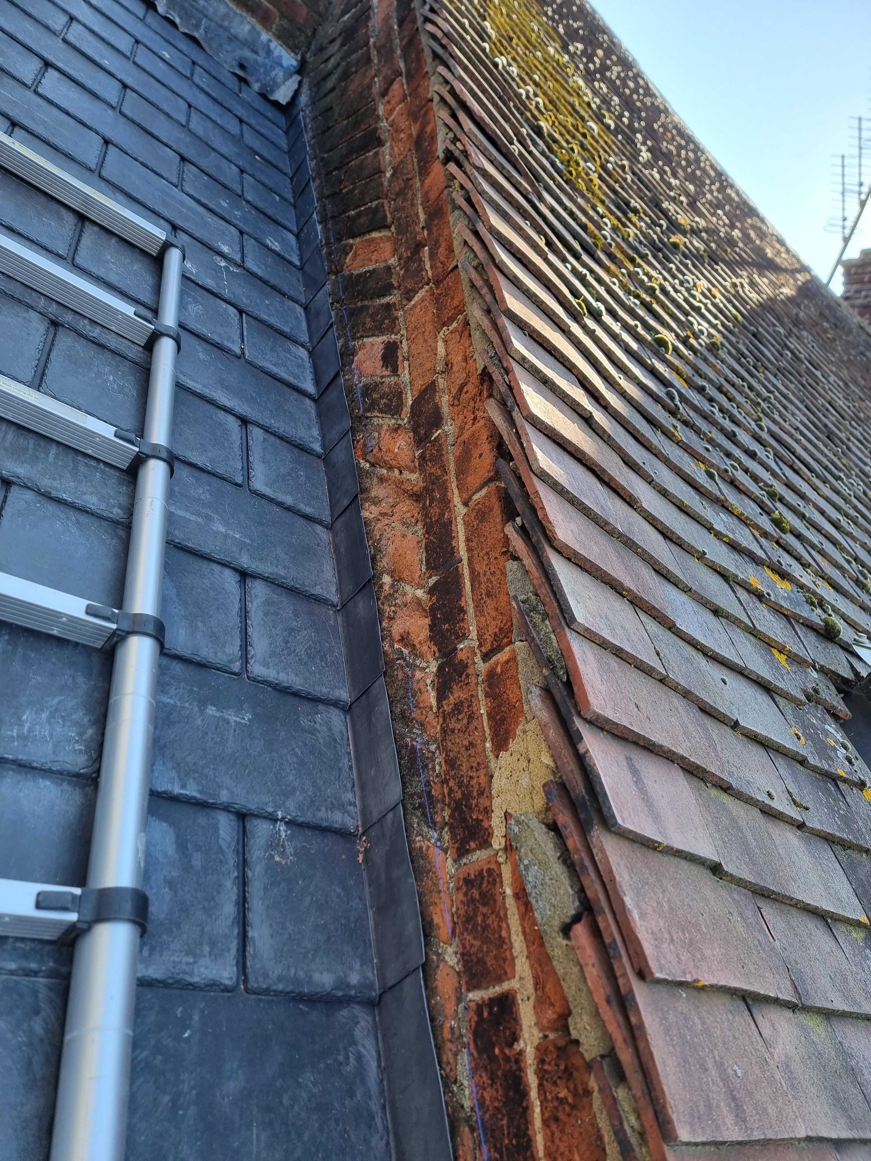

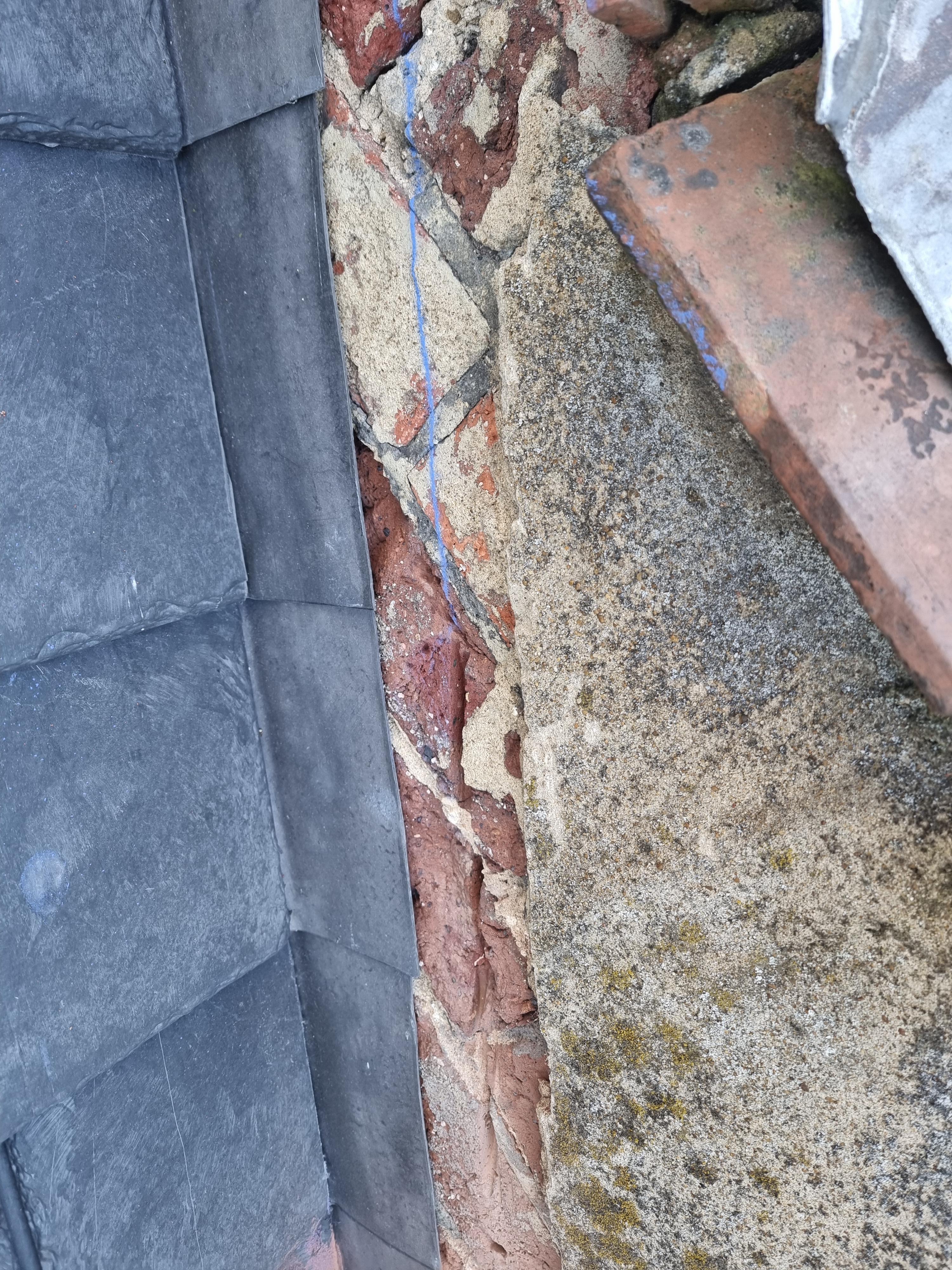

Colms Posted March 8, 2022 Share Posted March 8, 2022 (edited) Hi everyone. I had planned to add a diagonal lead flashing, down the wall, over my lead soakers. The issue however is the wall I want to put the diagonal flashing on, is not in a great state. In certain parts the gap in the bricks are white deep, so I don't think normal lead would work. I dont think Sticky 'lead' tape would work either. Is there any other way?. Some sort of render over the lead soakers. I'd rather not render the whole wall, as it's the neighbours and like I said, its not in great nick. Once again the wall is really quite soft and old. I dont want to mess about too much with it, or I could be opening a can of worms for myself. Any ideas are appreciated. Cheers. Jim Edited March 8, 2022 by Colms Spelling mistake Link to comment Share on other sites More sharing options...
Simplysimon Posted March 8, 2022 Share Posted March 8, 2022 seems to be a helluva steep roof? so top two course are laid in direction of fall, i certainly wouldn't want to disturb them in case they decide to slide. what about running a quick cut parallel to the edge of soakers and carefully fitting lead into that? may not look too odd as both roofs at differing angles Link to comment Share on other sites More sharing options...
Colms Posted March 9, 2022 Author Share Posted March 9, 2022 I did try to cut parallel, but the bricks are so soft that they wouldn't really take the lead very well. Also, some of the bricks are blown so much that the lead 'lip' in the brick work would have to be 50mm +. No easy solution here. I may end up trying to use some sort of render and then using that lead tape. Link to comment Share on other sites More sharing options...

Gus Potter Posted March 9, 2022 Share Posted March 9, 2022 To excuse the pun. Rather than interfering with your neighbours tiles can you create a rain screen effect. Here you would fix maybe a metal channel type section to the good bricks, could be timber protected by dpc. The rain screen would belong to you but over sail the neighbour's tiles. You could run Code 4 lead vertically, say in 900mm lengths so manageable and easier to fold neatly. That may be enough to solve any problem and allow air up behind the "rain screen" lead? If you are using lead don't forget to coat with patination oil on both the front and back of the flashing. You would need a wee nifty bit at the top but if it looks promising in principle the you should be able to devise some kind of capping flashing? Link to comment Share on other sites More sharing options...
tonyshouse Posted March 9, 2022 Share Posted March 9, 2022 Single angle grinder cut as blue line, angled slightly upwards into the bricks. 1.2m sections overlapped 100mm leadmated in Link to comment Share on other sites More sharing options...
Colms Posted March 9, 2022 Author Share Posted March 9, 2022 Thanks for the replies guys. Unfortunately, TEMP, next doors roof is very old. The mortar is already coming loose , so don't want to touch it. GUS, I'm not totally sure what you mean, it sounds Interesting though, would you mind showing me an example of s9meyhing similar, just fir my own clarity. And Tonyshouse, that was original plan but the bricks are so soft and damaged, it work work. Link to comment Share on other sites More sharing options...
