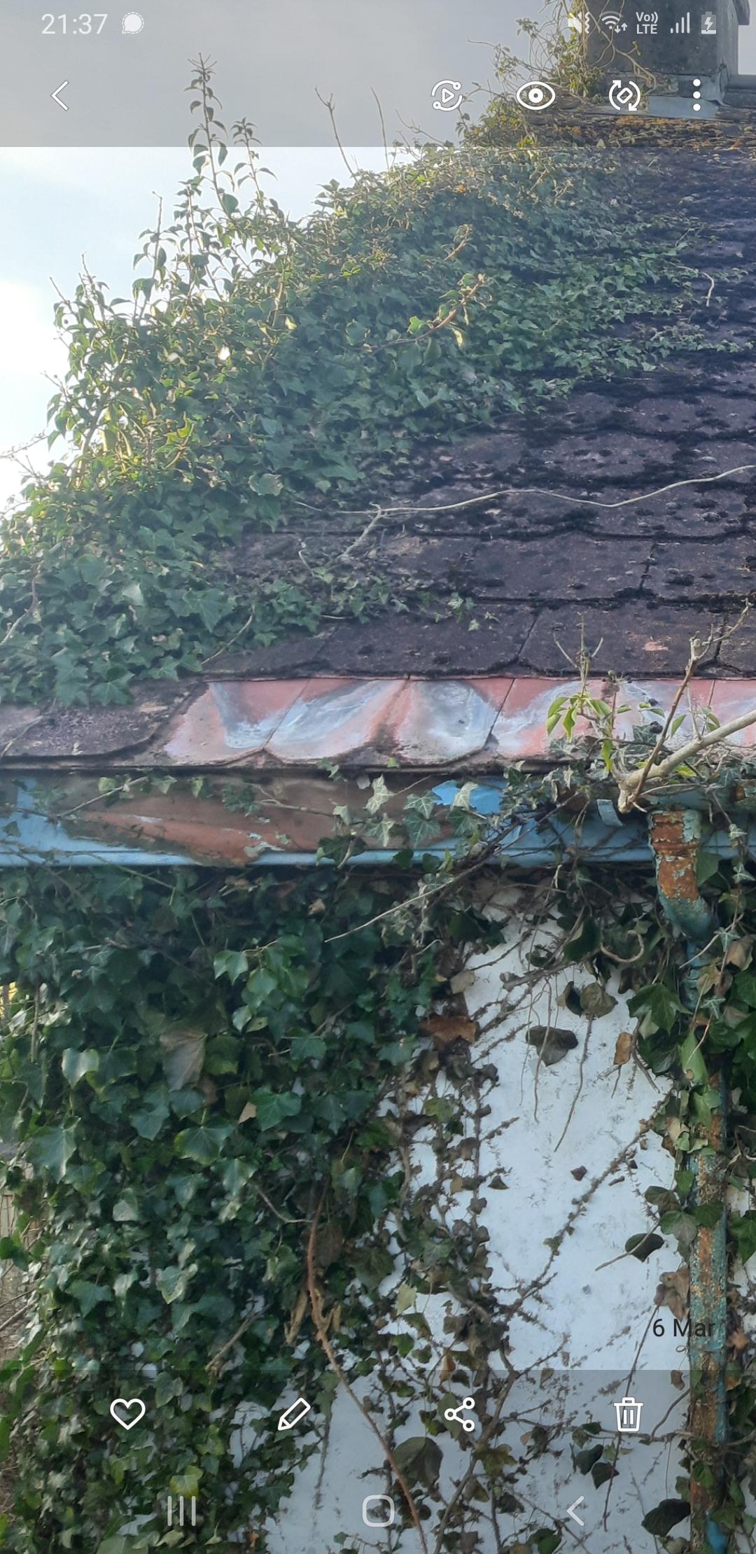

CalvinHobbes Posted March 6, 2022 Posted March 6, 2022 Hi, looking at getting the tiles/shingles off safely the cottage we are demolishing which so far involves wearing the full PPE but thinking about hiring a mii tower. (I have the bags & know to dampen them etc.) I took a few tiles off just to see how it would go and was surprised to find what looks like others underneath. Do you think this is just at the edges or on the whole roof? (Not inclined to trust the roof and the front is very sloped and a good distance from the road. )
Nickfromwales Posted March 7, 2022 Posted March 7, 2022 Usually only doubled up at the bottom courses but time will tell! 1

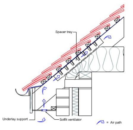

Temp Posted March 7, 2022 Posted March 7, 2022 20 hours ago, CalvinHobbes said: I took a few tiles off just to see how it would go and was surprised to find what looks like others underneath. Do you think this is just at the edges or on the whole roof? Its common to have a row of shorter tiles at the eaves and ridge. These are needed to waterproof the gaps between tiles. You can just make them out on the diagram. Not sure about shingles. 1
