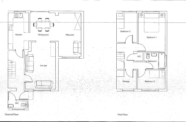

This appears to be your existing layout
I don't see an easy way to improve that without reducing the number of bedrooms.  The original developer squeezed 4 bedrooms into what should have been a 3 bedroom house. The bathroom should be in the front box room. and bedroom 3 should encompas the wrongly placed bathroom, perhaps turning the old bathroom into a small en-suite.
But as above, re submit planning, and if rejected, appeal.
 I couldnt agree more, downstairs is amazing now I have opened it up.
But upstairs I have one good rooms, an office and 2 small rooms.
