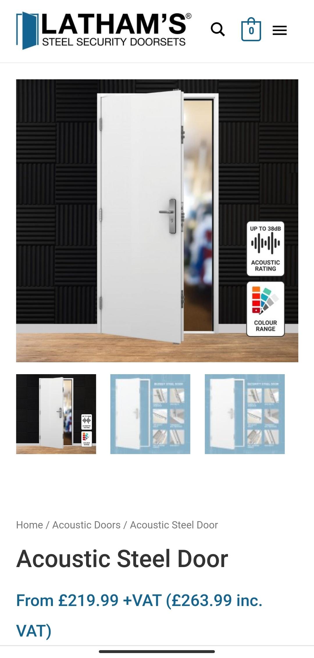

Iceverge Posted March 5, 2022 Share Posted March 5, 2022 Speaking of doors has anyone installed an acoustic one. They're not mega expensive. I was in a commercial building yesterday and I was impressed by the sound supression of a normal fire door with fire seals. Light years difference from a timber one in our house. Link to comment Share on other sites More sharing options...

Mr Punter Posted March 5, 2022 Share Posted March 5, 2022 6 hours ago, Iceverge said: I was impressed by the sound supression of a normal fire door with fire seals. I put some of the self adhesive plastic smoke seals around some doors in our house. It stops the doors making much noise when they are closed and really helps with sound, even though the doors have a 10mm gap under. Link to comment Share on other sites More sharing options...
