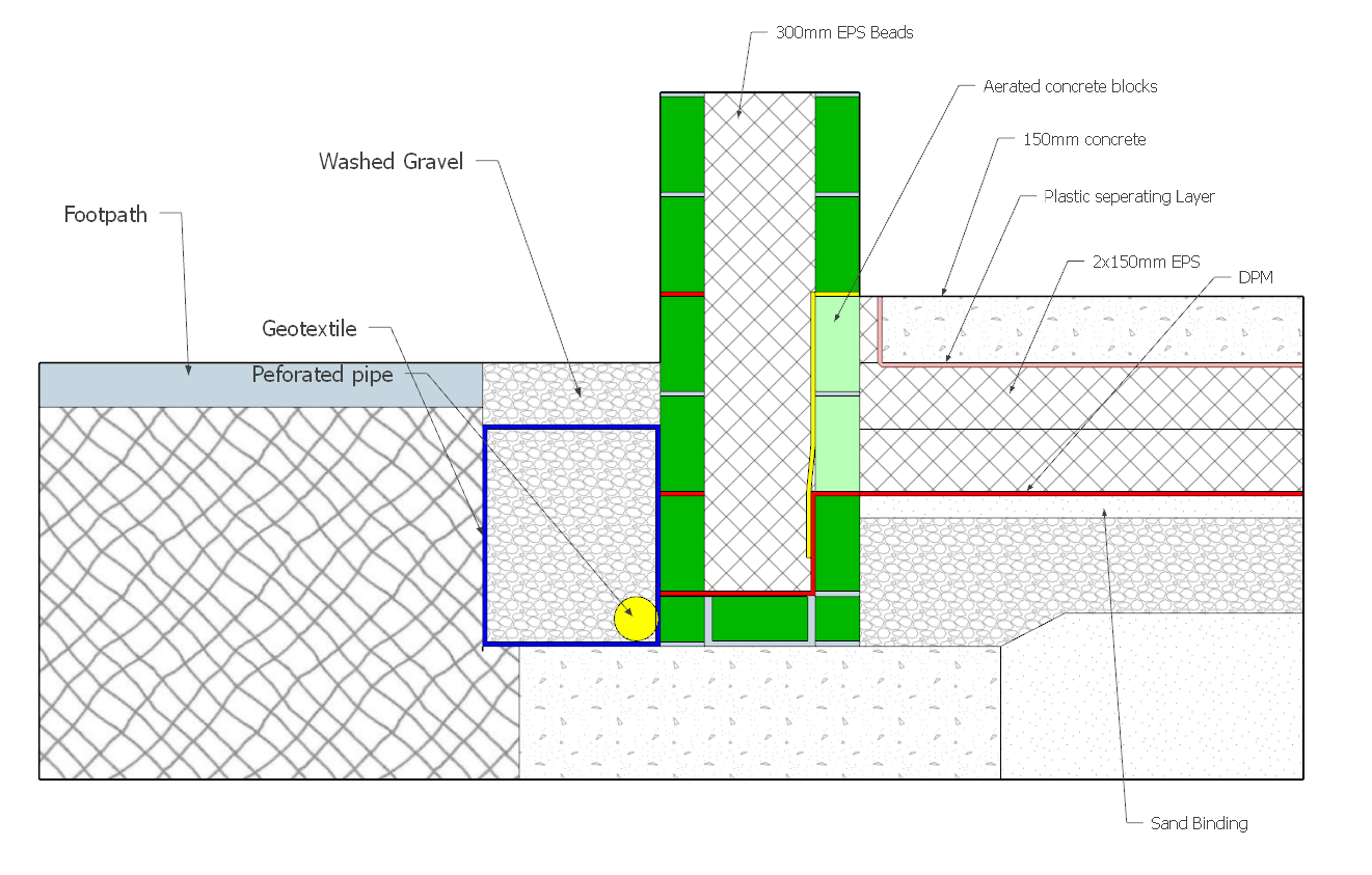

Caversham Build Posted March 2, 2022 Posted March 2, 2022 Hi all, me again, Thanks for all your help so far. I have another question I want to protect against ground water / rain water / holy water the lower 500mm of my outbuilding, as it is below GL in a quite wet area. My first detail was this : But i have come up wit this detail instead which, to me, will do a better job and much cheaper: pretty please please could you tell me if this can work / share your wisdom apart from the 'change your design so its above ground level' wisdom thank you

Iceverge Posted March 3, 2022 Posted March 3, 2022 (edited) Just have it in such a way that the water can go down and out. Relying on DPC only for keeping water out of your floor is foolhardy in my book It will get punctured during the build. . A french drain lower than the bottom of the cavity with a drainage pipe would be best. I would make your brickies life really easy and get rid of the rockwool entirely and use EPS blown beads. Above and below ground. Take the cavity as low down as your SE will allow. It will help with thermal bridging and any water will really struggle to cross the EPS beads. Here's what I think we should have done. To be honest I can't see what the overlapping yellow DPM is achieving in the real world if the french drain is operating correctly but people will get angsty if I don't draw it! EDIT the DPC in the outer leaf low down is a mistake! Edited March 3, 2022 by Iceverge
saveasteading Posted March 3, 2022 Posted March 3, 2022 1 hour ago, Caversham Build said: soil and into the gravel Yes. Or along the pipe into the gravel, and certainly down the wall and into the gravel
Caversham Build Posted March 4, 2022 Author Posted March 4, 2022 Hi all, okay i have gone back to the drawing board and simplified. how does this look? I cant make the drain lower than the DPM unless i put insulation under the DPM rather than over as i have already poured foundations and hardcore
saveasteading Posted March 4, 2022 Posted March 4, 2022 To me that should be designed as a basement, regardless of whether it is 300mm or 3m underground. Also that lower length of wall is acting as a retaining wall. So I suggest completely tanking the outside up to ground level for the former, and making the outer skin of the wall heavier for the latter. That keeps the water out and the wall stable. Then deal separately with dampness from below, so dpm and dpc all linked in the normal way. PIR is twice as effective as EPS (at twice the cost) so perhaps better in the cavity at this point where I am suggesting a narrower cavity. For interest, why correx under the slab?
Iceverge Posted March 4, 2022 Posted March 4, 2022 The PIR encompasses the concrete slab. I don't understand why? A 25 mm land drainage pipe would be very narrow, We used 110mm, The pipe was below the lowest level of the DPM.
