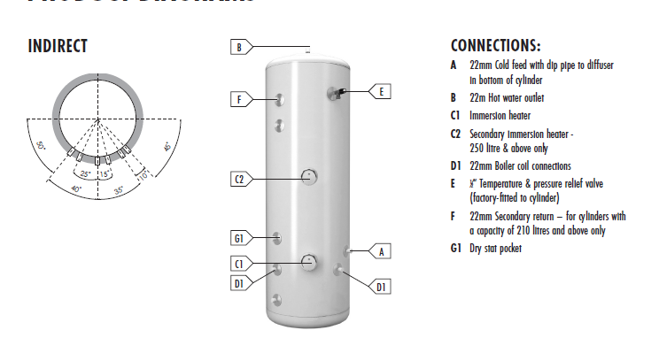

I think I've found one as standard though  - Worcester Bosch indirect - but only on the larger tanks - 250l and 300l. See image below.
The only issue might be the coil - does the coil need to be longer/have a greater surface area for ASHPs over standard boilers?

1 hour ago, dpmiller said:
what's the spec of the coil? ASHP ones do tend to be bigger
On the 300l tank it is 0.86 surface area, capacity 4.75l and 21kW
Not sure what an ASHP one would be.   But the WB solar cylinder which has 2 coils, has an identical coil for solar.

On 28/02/2022 at 17:02, dpmiller said:
remember that with an ASHP you're working with less differential between coil and tank contents which pushes the requirement for a bigger transfer area
Yes, a bit more digging and it looks as though the WB wouldn't really have enough surface area on the coil.   I found a site somewhere that said 0.2m2 per kWh which might be useful for anyone else thinking about this.
Newark have an interesting page on their site -> https://newarkcylinders.co.uk/solar-hp-cylinders.html  which says the same as you and specs their HP coil at 3.42m2 which is more like some others we've looked at.
They will also do the dual immersion heaters that we need.  So we'll investigate prices with them.
