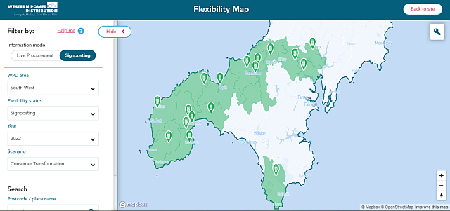

SteamyTea Posted February 28, 2022 Posted February 28, 2022 Weston Power Dirstribution has a map. Don't know what any of it means (can't be bothered to look into the detail). https://www.westernpower.co.uk/network-flexibility-map-application I shall let others look at the detail.
Radian Posted February 28, 2022 Author Posted February 28, 2022 2 hours ago, markc said: Sadly the Construction Levy is seen by planners as a way to get the infrastructure upgrades needed in an area. The Construction Levy for this development will be something in the region of 3 million but that doesn't buy much road. It's about the market value for four detached properties around here. Can't see it bringing much in the way of improvements. 2 hours ago, Conor said: A small development connecting to a major trunk network fed from a new treatment works will have no impact and the developer will just have to cover the connection costs. I have no feel for the likely capacity of the network and the way consumer usage is modelled. I know there is this wonderful notion of "Diversity" in domestic electricity loading. No doubt a similar concept applies to the other services. 1 hour ago, SteamyTea said: Weston Power Dirstribution has a map. Don't know what any of it means (can't be bothered to look into the detail). The word salad glossary didn't help me at all e.g. "This is one of 4 scenarios from National Grid’s Future Energy Scenarios (FES). WPD create Distribution-FES (D-FES) and our scenarios align with National Grids Scenarios. The D-FES translates the national FES to a regional (licence area) level. The FES scenarios are used on the flexibility map to give a scenario based view into the future as to what flexibility services may be required in an area. Users can select the a scenarios they think are most likely to play out over time. " Words like Flexibility, Scenario, hint at things like adapting to change so I guess you're pointing me in the right direction here. As I type this I'm idly looking to a distant 400kV "L12" pylon coming in from the GSP at Nursling from the sofa in my garden room and wondering how much more current the two routes into Weymouth and Portland can take before another transmission line has to be constructed. Probably enough for another 300 houses, but 3000?

SteamyTea Posted March 1, 2022 Posted March 1, 2022 8 hours ago, Radian said: I wonder where all their kVAR is going To heat the local environment. Having a quick, early morning, look at the Weston Power site, they have a value tool. https://www.flexiblepower.co.uk/locations/western-power-distribution/value-calculator Looking at Mullion you can earn £34,513.66 for connecting up 1 MW of generation (terms and conditions apply). But for Isles of Scilly it is £2,809.56 And the Hayle-Camborne is only £1,239.42 Not sure that that correlates to, but I know a flower farmer at Cury, told him 20 years ago to get some big turbines on his land.
