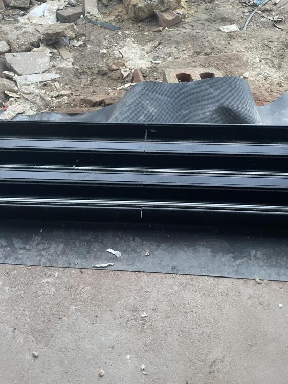

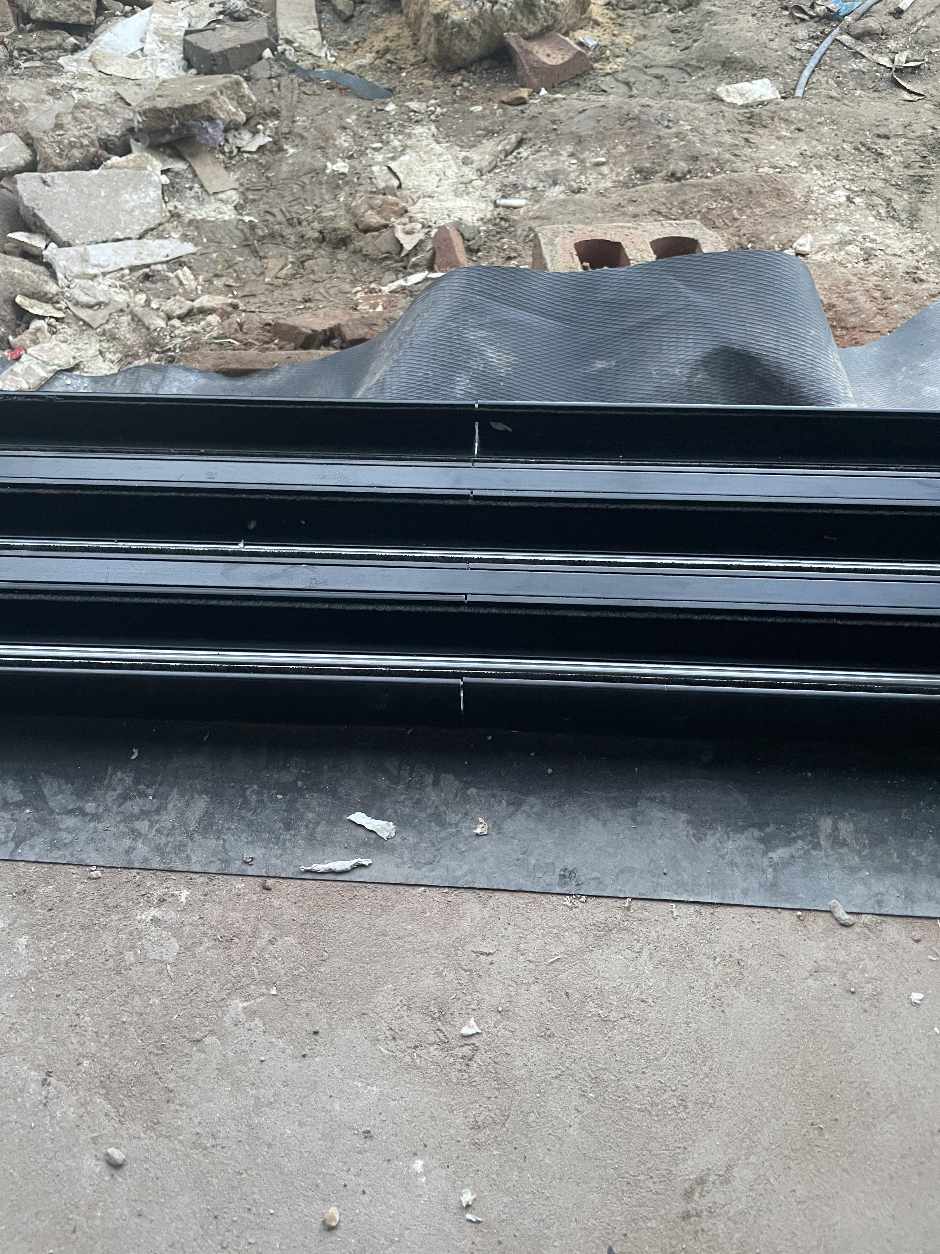

Rebel80 Posted February 26, 2022 Posted February 26, 2022 (edited) Hi all, Wanted to get the view of others on the forum here. We brought our sliding doors and yesterday they were fitted. However, just now I noticed that the track is made up from two pieces - one part is around 6 metres and the other part is around 50cms (total opening is 6.5m). As you can see from the two pics attached, this doesn’t look right - I really thought it would be one track made (not two tracks joined together). This doesn’t look right to me and looks unfinished. I’m also thinking the point where the two join can cause issues later down the road. Edited February 26, 2022 by Rebel80 ..

MJNewton Posted February 26, 2022 Posted February 26, 2022 Who is the manufacturer? Would be worth asking them about it. It might well be that the maximum extruded length they can supply is 6m.
Rebel80 Posted February 26, 2022 Author Posted February 26, 2022 I’m going to speak with installations team on Monday about this. Got this door from 1st folding sliding doors in Wembley
Rebel80 Posted February 26, 2022 Author Posted February 26, 2022 So apparently the max length is 6m. So they always have to join. They will come on Monday to make the join more cleaner/neater. Fingers crossed
MJNewton Posted February 26, 2022 Posted February 26, 2022 From what we've seen I imagine it might just be a case of flexing/persuading the two parts to be in better alignment. Perhaps some colour-coded silicone to fill any gap that might persist?
Rebel80 Posted February 26, 2022 Author Posted February 26, 2022 4 hours ago, MJNewton said: From what we've seen I imagine it might just be a case of flexing/persuading the two parts to be in better alignment. Perhaps some colour-coded silicone to fill any gap that might persist? I hope so and if done well then I think I’d be happy with this

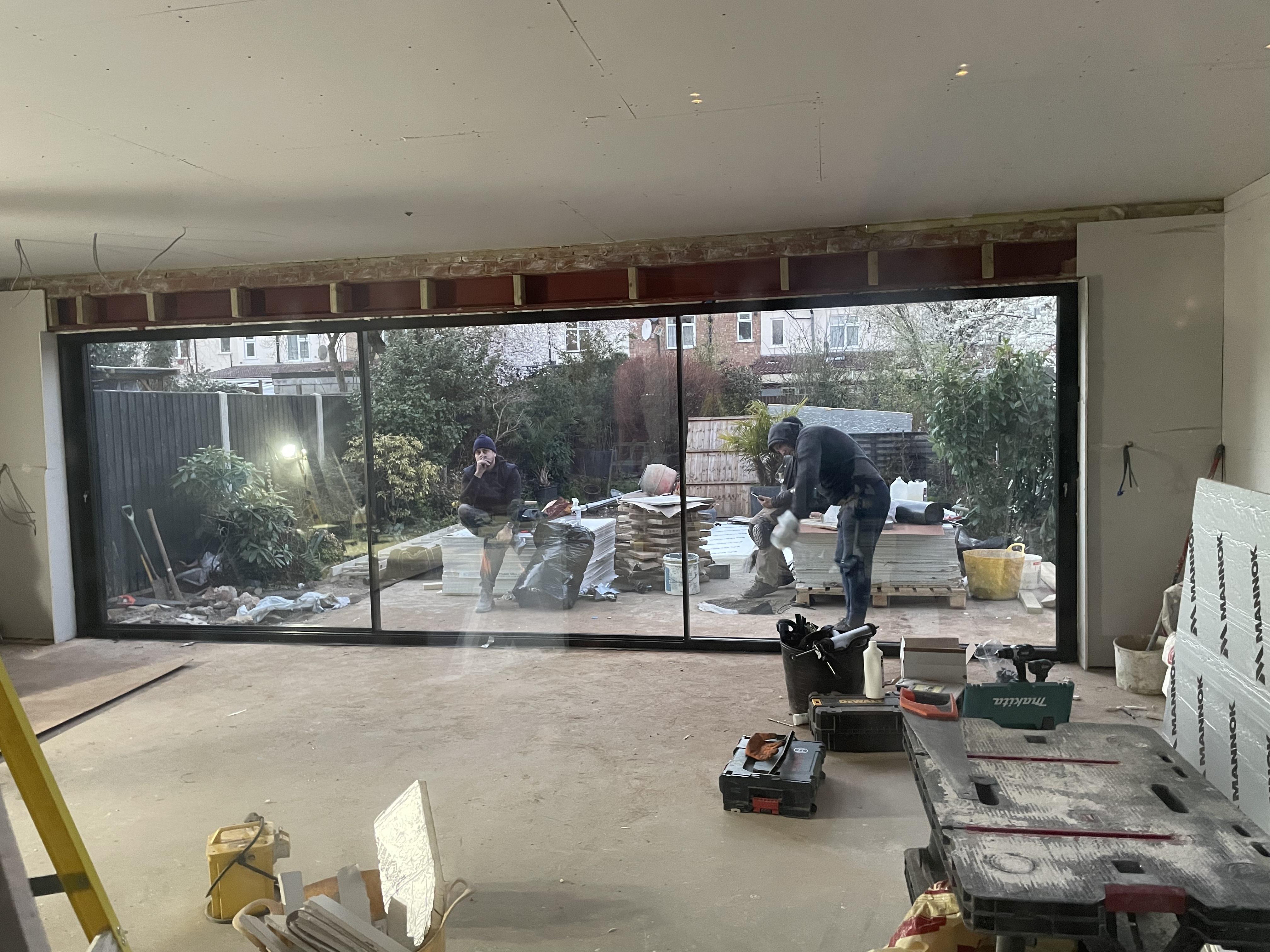

Gus Potter Posted February 26, 2022 Posted February 26, 2022 @Rebel80Good to see the slender vertical glazing bars. They look great. They look like true sliders rather than the lift and slide type. We have the Origin ones and they run pretty smoothly with similar sized panels. The locks are discreate as are your's. Like them. I think the break in the bottom rail is a potential issue. Your building is going to move under that bottom rail. You need to make sure that the drainage track channels the water outwards.. that's not going to happen once that joint opens up and translates sideways. Also as they are true bottom sliders you'll notice the bump as the bearings run over the gap in the stainless running bead. I have found ours are really sensitive and even a small amount of dirt on the running bead is noticeable. If these beads come out of alignment on plan then you'll be even more disapponted to say the least. If it was me I would be minded to ask why did they not put the joint under the centre pane and fit a coupling piece under to ensure the water is channeled outwards at all times. The track will attract a lot of water when you get some driving rain against the glass. Interesting to see your steel over. Who designed this? I wonder what is above in terms of load? The packers over the head look tight on that span particularly over the fixed centre pane. I ask as am curious how the installers have managed the deflection in the centre of the opening.

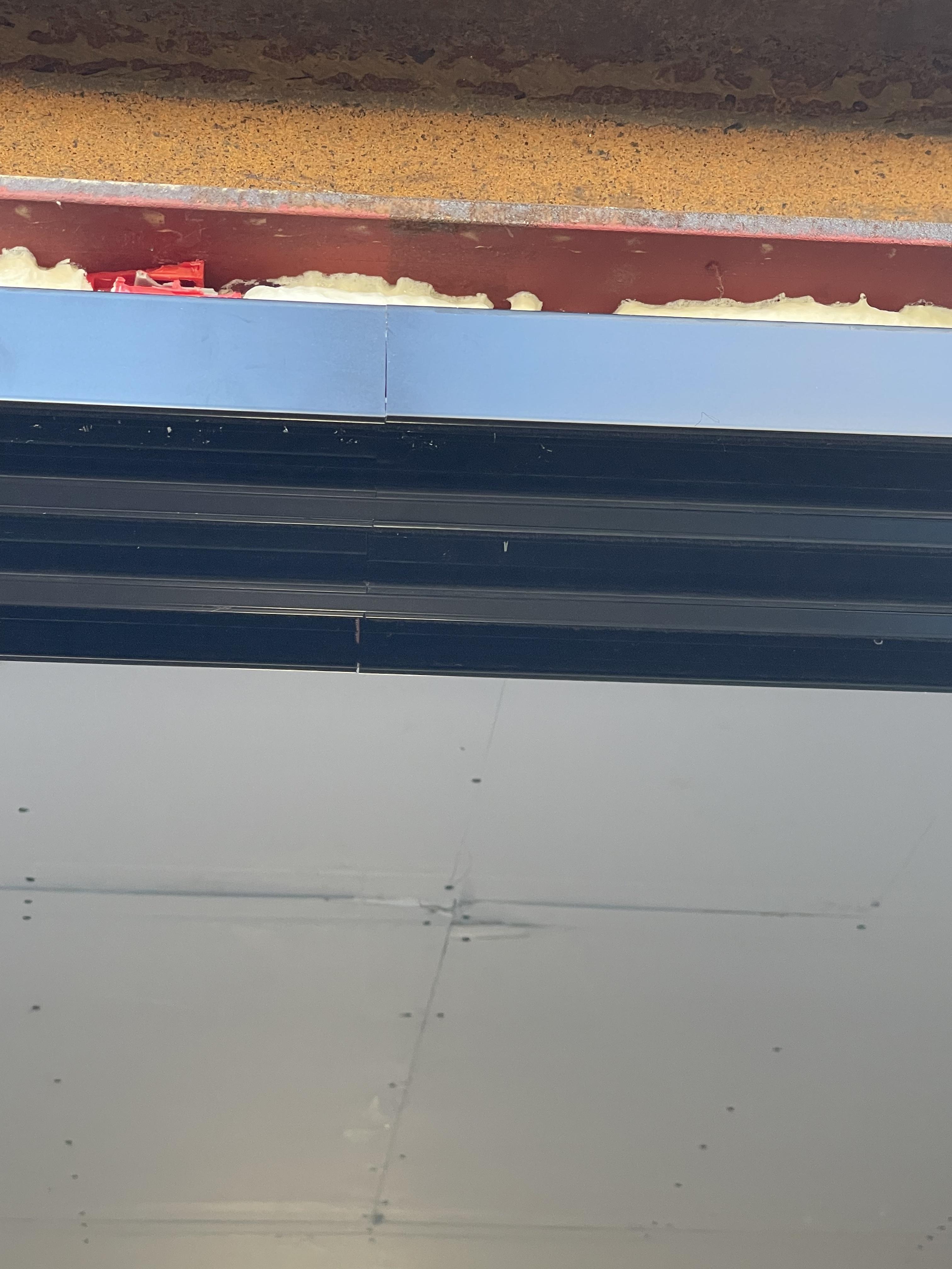

craig Posted February 27, 2022 Posted February 27, 2022 (edited) On 26/02/2022 at 19:11, Gus Potter said: The packers over the head look tight on that span particularly over the fixed centre pane. I ask as am curious how the installers have managed the deflection in the centre of the opening. They’ve used PU foam and that’s a rigid insulation so when the steel does deflect only operational issues will be experienced. That’s pretty much not done anymore and compriband is used, if they include it in installation cost or an extra. If client doesn’t pay for it not much they can do but use PU foam. I suspect they will be difficult to slide at some point. Edited February 27, 2022 by craig 1
Gus Potter Posted February 27, 2022 Posted February 27, 2022 8 minutes ago, craig said: That’s pretty much not done anymore and compriband is used, And there lies a potential problem. That is a big opening. When the wind blows on the glass the frame around about need to resist the loads. The central pane of glass is vertically spanning. The bottom rail prevents it from moving in and out. At the top there is a gap and the fixings are subject to a lot more bending force. For fixings to realise thieir full capacity they also develop a "second order" tension effect. They can't develop the tension as the compriband compresses and the frame at the top will bend upwards / twist under wind loading. One thing that stops the movement and saves the glazing companies is that the plaster board, masonry check outside / or the mastic lasts just long enough to make it very difficult for the home owner to complain. Bifold doors can be even worse as when they are open they rely on the top part of the frame to stay rigid, it does not have to be windy to cause a problem. It's a dilemma once you start to delve into it! 1
Rebel80 Posted March 1, 2022 Author Posted March 1, 2022 Hi all, thank you for messaging on this and providing some feedback. It’s been very helpful. Over the last few days I’ve spoken with over 6 other companies and they have all said that anything over 6m will require a join. The company that I brought the doors off have now filled in the gap with black silicone. So now although I can see a line, it looks ok. 2
