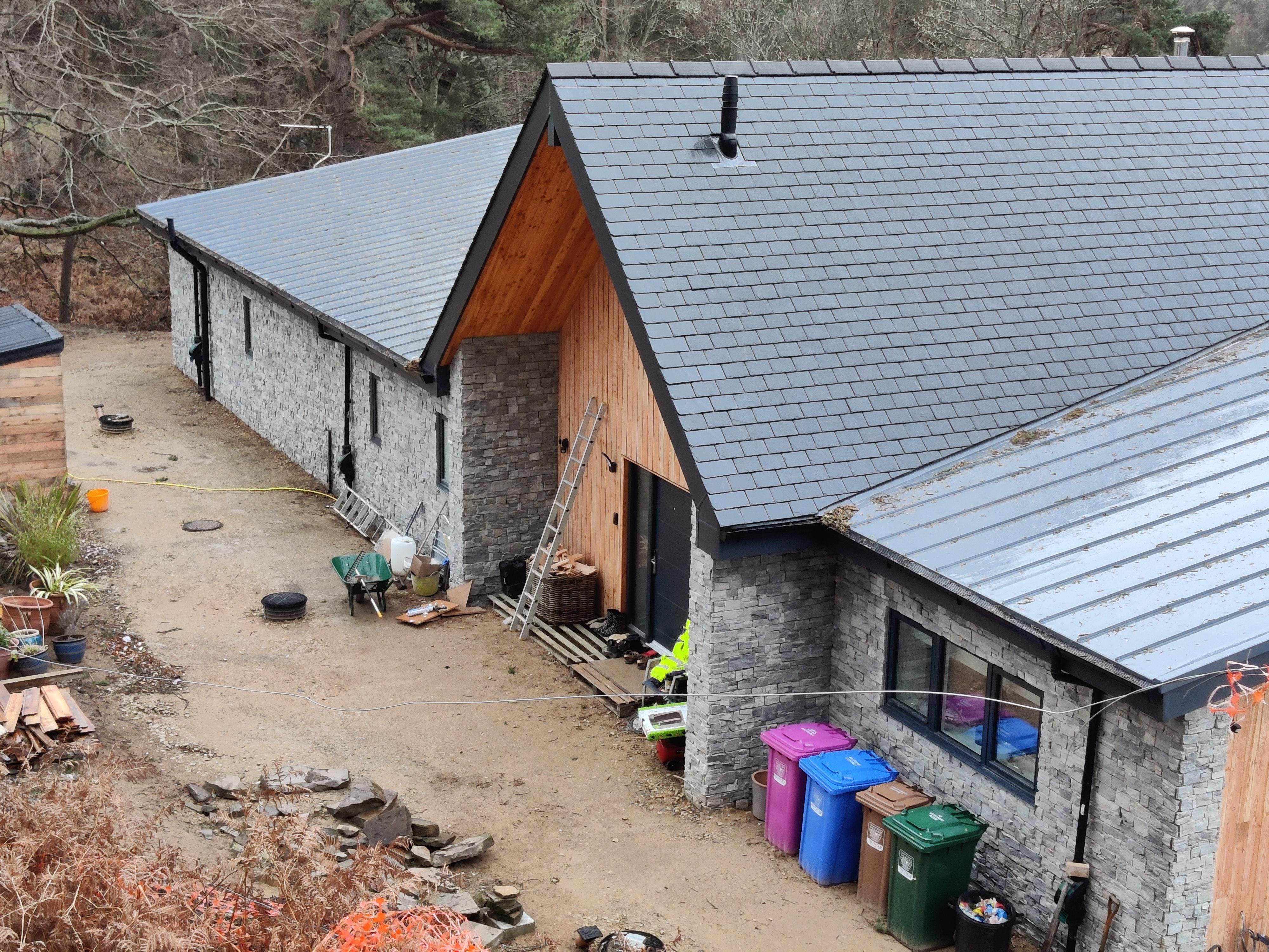

I have seen a fake standing seam done with Sarnafil (think that’s the right term or spelling) for the waterproof membrane and it was really good. Does not dent or distort with heat or nearby trees/ birds dropping things onto it. Easy to walk on and clean.
we didn’t fit it but was interested because we used to erect a lot of the big fabric tensioned roof structures
Link to comment
Share on other sites
Like everything else, a lot depends on who fits it. I did not like Sarnafil because you can get odd bits like this. On a high roof it may well look fine.
One thing about metal standing seam is you will probably get some level of oil canning. Ours can look perfect on some days then the next the light catches it or it's hot and you can see slight waves. Ours is subtle and I don't mind it. I have been told that a lot of the ones you see online have been photoshoped to remove imperfections.

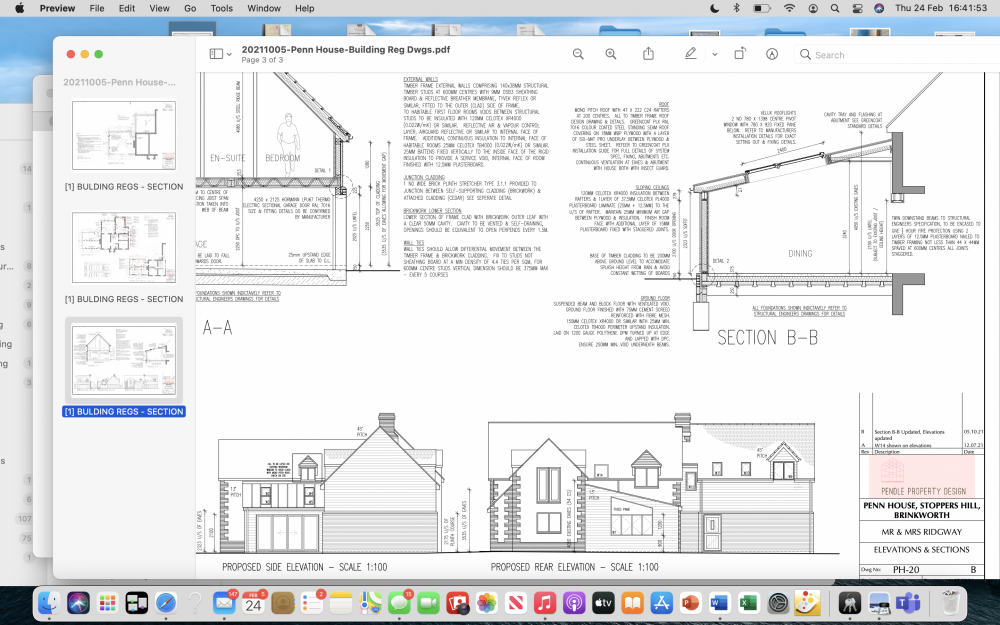

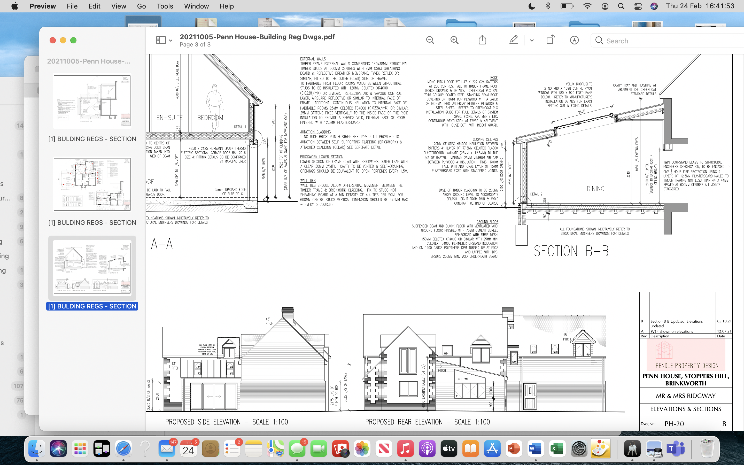

WRT the visuality of the roof, the upstairs bedroom window, and landing windows will look down on this. I will try to upload the roofing plans.

the builder is getting specialist contractors in for the roof, so not fitting himself and was looking at Sarnafil. As we passed planning with a standing seam roof, I think that Building Control might say something if we changed the look of the roof now... p.s. we are in a very rural agricultural area.
Looking at your drawings, they correctly specify the use of WBP Plywood as the substrate for the standing seam roof. If you do decide to go ahead, make sure your tf builder complies with this specification and doesn't use osb. The spec on the drawings is correct for the standing seam with a ventilated cold roof.
As it's a change of material, you may be correct in that it might require an amendment to the planning approval - are there any conditions?
You will notice the difference between standing seam and whatever the lookalike version is called, especially if you're looking down on it from a window above. Best thing as always is to see if you can look at some local installations to make a comparison and therefore more informed personal decision.
Thank you @SimonD I will double check the specification from the TFM when I get home.
Not as far as we know for planning conditions. The only people that will see the top of the roof will be us. It's not visible from our neighbours.
Yeah, a big difference there! ?
The builders have used a qualified Sarnafil contractor before for another job
