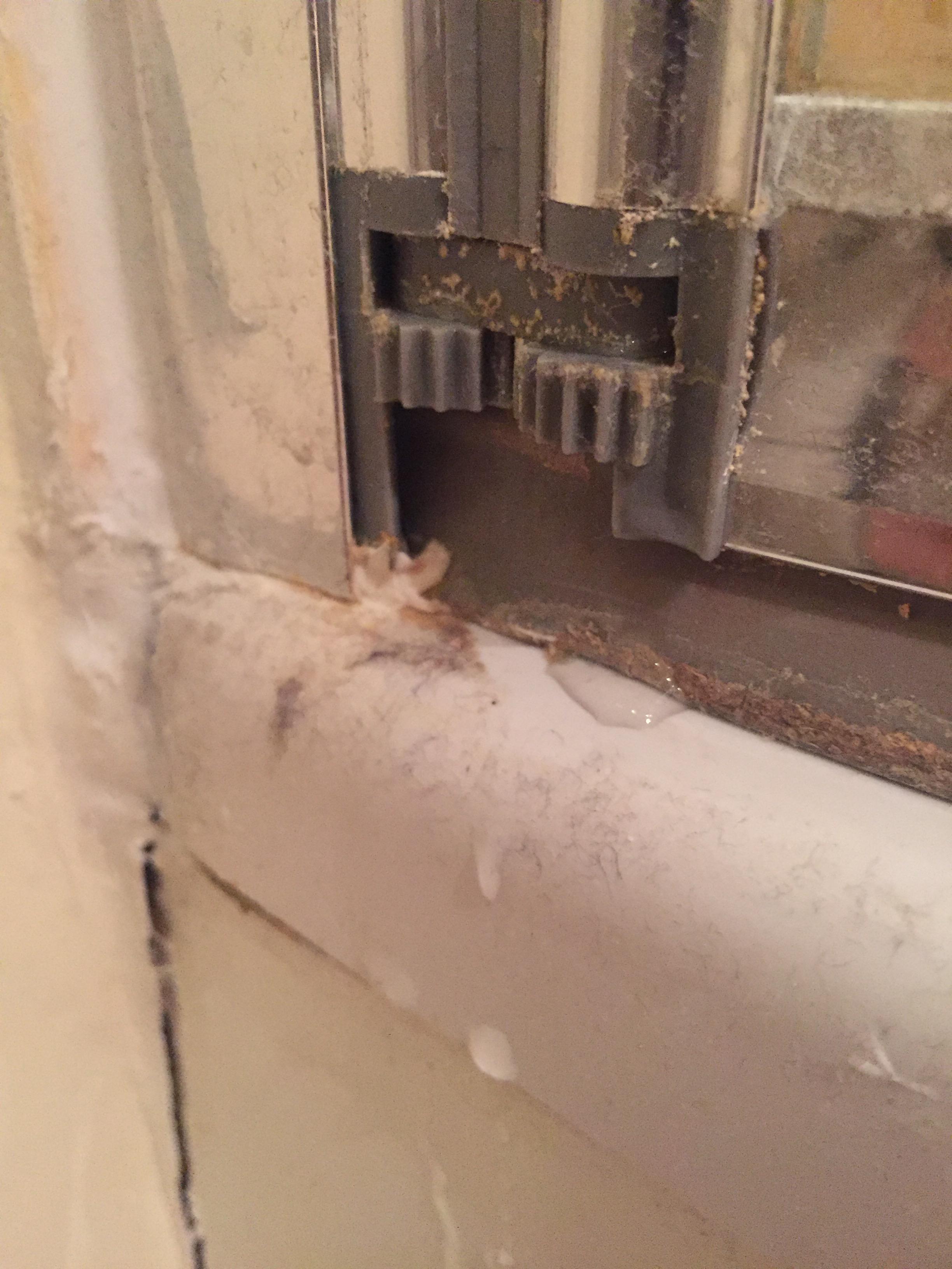

Triassic Posted May 6, 2017 Share Posted May 6, 2017 I think the pooling water is a red herring, the water in the photo is leaking from the hinge. The last shower screen I fitted had a U shaped cut out in the hinge, this U shaped cut out as there to channel any water that got into the hinge back into the bath.. I've seen these cut out fitted the wrong way round in the past, thus allowing water to leak out of the bath. Link to comment Share on other sites More sharing options...
Nickfromwales Posted May 6, 2017 Share Posted May 6, 2017 Not necessarily a red herring, as any water should, to a reasonable degree, eventually run down the deck and into the bath / drain. I do expect some water to sit there, where the tiles meet the bath, but only what the surface tension of the water will promote rather than a pool. If, and its a big if, the bath only has a 2-3mm dog ear then maybe bonding a suitably shaped plywood section up into the offending underside, jacking it up slightly with a batten wedged between it and the floor ( sitting on an off cut of 4x2 so it doesn't go south ) will get you off the hook. Don't for a second attempt to wedge anything under the actual acrylic of the bath ( eg without a bonded on plywood section ) as the batten will just punch through the bath over time. Use Sikaflex EBT ( NOT silicone ) for all the fundamental sealing work, available in clear and white, and for bonding the plywood packer to the bath underside, but use silicone as the final cosmetic / splash-proofing seal. Needless to say, the bottom course of tiles and the screen need to come off to do all of this. Its probably best if you sit down with your installer, over a cup of tea, and state that this ( you getting a resolve ) isn't going to go away, and decide how you can both work to an amicable resolve. Taking the tiles off to seal the bath to the wall should be at the fitters expense, but maybe best to offer an olive branch and pay for the tiles / adhesive / grout if they are willing to do the propping-up for the corner of the bath etc at the same time. They should have identified the bath being unfit when they installed it, as they'd have had to put a level on the end of the bath to set it into place and level it initially, so there's no excuses there just a bit of due process that's been overlooked as a minor, but is now a major. Fwiw, no acrylic baths are perfectly flat and all have slight dog ears, unless it's a Trojan cast, ( 8mm and thicker ), reinforced bath, which are nigh on perfectly flat. These can be spotted quite easily as the underside is usually green not white. Link This is the kind of bath I'd fit if having a shower over the bath Maybe time to ask about a possible returns and in-store credit at the least with VP as its not normal to have to retrospectively botch a solution to make the thing for for purpose. Link to comment Share on other sites More sharing options...
AliG Posted May 7, 2017 Share Posted May 7, 2017 I took some pictures of the screen I have in london. It was the old one that had a small space where the blue square you pointed out was. The new one has a U-shaped plastic channel on the metal post and the seal then disappears into this at the bottom trying to form a better seal as @Triassic mentions. I knew it had been leaking though, so I switched it on with the shower directed at the corner of the bath. I had assumed that the water was getting under the seal, where you see it here. In fact watching from outside the bath, once water hit the door it actually came through the hinge where the grooved wheels can be seen. The drip that you see in the picture came from there but settled at the bottom making me think the seal wasn't working properly. I suspect that when hit by a lot of water these screens will always allow some water through, I find the only solutions is to as much as possible direct the shower head away from the screen. I think @Nickfromwales fixed screen is maybe a better idea, I am not sure that the concept of a moving hinge and watertightness are very compatible. Probably depends on how often you plan to use it, ok for occasional use but not for every day use. Link to comment Share on other sites More sharing options...
Dbas Posted May 8, 2017 Author Share Posted May 8, 2017 (edited) Thanks @Triassicand @AliG, the contractor brought a different bottom seal for our screen, and with a U shape channel too, which really helps stop the leak. @Nickfromwales A wooden batten is currently used under the offending corner of the acrylic bath, haha. I'll check with the bathroom fitter that this is only a temporary measure in use till he makes the time to come back to complete the work, and perhaps to use plywood as you suggested. The old bath in this place had a wooden frame propping it up under the outer side (length wise), i wonder whether are frames used for steel baths and not acrylic ones because of how much heavier steel baths are? Our acrylic bath has brackets holding it in place at the walls, and no frames on the outer side. many thanks for all your advice. Edited May 8, 2017 by Dbas Link to comment Share on other sites More sharing options...

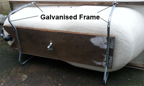

Nickfromwales Posted May 8, 2017 Share Posted May 8, 2017 We're not on the same page here Pic is just a random Internet grab The timber frame I'm referring to is factory integrated into the construction of the bath. See the image, where the legs meet the underside of the bath......they hit this timber batten. Does your bath have that batten built into both width and lengthways as in the pic? Link to comment Share on other sites More sharing options...

Dbas Posted May 10, 2017 Author Share Posted May 10, 2017 (edited) So it turns out the corner is dipping about 2mm. We currently have a wooden batten wedged underneath (pic below), and then fitter said he will change this for a piece of CLS timber. I asked for some plywood on the underside of that corner for the CLS timber to be wedged up against as you @Nickfromwales suggested, but the fitter is confident that the acrylic will not crack. In regards to your earlier question, there is no timber both in the width and lengthwise of the bath. The fitter said because the bath is so flimsy (he reckons it's about 3-4mm thick), the corner where it is dipping is probably due to the weight of the bath screen. That outer corner also has a bulge (pic below) which is rather unsettling. We asked whether the other corners of the bath will move over time if we wedge up the offending corner. The other corners are not actually held to the wall by brackets, but just by a double seal. Again, he assured us they wouldn't. I seem to be getting contradictory answers, like -- the bath is so thin and flimsy, that it is dipping and bulging. On the other hand, it is not so flimsy that it will crack or move over time, nor does it need further support at the corners..... I am not convinced just one piece of CLS timber will solve this issue. Some questions: 1. To prop up with CLS timber, the fitter only needs to remove the 1 and 1/2 tiles above that side of the bath (pic below) and not the whole bottom row of tiles on all sides? 2. The other corners of the bath are held to the wall by a double seal. Are they really not going to move? 3. Should we change to a 6mm thick acrylic bath? Regarding #3 the bath: the fitter is convinced that the problem is the quality of bath -- either because it is so thin, or it has a manufacturing defect (which he said would be a hassle to get VP to exchange). We bought this bath on the advice of the contractor, we asked him about the quality and durability of the bath, and he repeatedly assured us that this bath wouldn't give any problems. Had he advised us to pay slightly more for a thicker acrylic bath, we would gladly have done so! Can we tell the contractor and insist -- the bath is unsuitable, and we will pay the difference for a sturdier bath? It will definitely be difficult to get him to agree, as who then would be responsible to pay for the workmanship? And if we strip off the whole bottom row of tiles to change the bath, there's no telling how the plasterboard behind will hold up. But we certainly don't want the headache of having more problems with the bath in the near future! Advice is much, much needed. Thanks in advance. Edited May 10, 2017 by Dbas Link to comment Share on other sites More sharing options...
Nickfromwales Posted May 10, 2017 Share Posted May 10, 2017 Ok. The bulge in the bath is most definitely because the batten is causing the bath to distort. I think this is all pointing in one direction......bye bye bath. I also think thats a lot more than a 'couple' of mm dog ear. . Some pills for your fitter to swallow..... 1) He advised you to purchase that bath. 2) He stated its robust etc 3) he stated its wonky and weak enough for the screen to bend the bath ; contradicting #2 4) Srceens screw into the wall channel and by no means should ever weigh the bath down as that would crush the seal strip so makes #3 a load of bullshit 5) He should have identified the defects prior to final fixibgvthe bath, end of subject. For you.... 1) You haven't landed the best fitters, but they've come back to address the problems which shows at least some integrity. That's obviously helped by the fact there's money owing. 2) Approach VP immediately yourself as the bath is unfit for purpose and suffers from obvious manufacturing defects. Time to argue that one out but try and agree on a credit towards buying a Trojan Cast ( reinforced ) bath from them rather than a refund. If they offer a refund then great, but I think you'll need to settle on middle ground TBH. 3) Insist the new bath is fitted to a wall mounted batten that runs for the 3 full sides that meet the wall, a standard that I observe for every bath I fit ( the brackets they've used always go in the bin on my jobs ). 4) Get the bath set into Sikaflex EBT and levelled accordingly. Leave that for a good 12 hrs to cure and then use the same to fundamentally seal the bath to the wall. Replace the tiles and use a coloured silicone to seal the bath to the tiles ( cosmetic / splashproof seal ). 5) Get the fixed screen / curtain combo and enjoy. These guys fit bathrooms and charge for it. Best they do it properly or leave the money there for someone else to come behind them. It's your confidence in them that's the deciding factor. Link to comment Share on other sites More sharing options...
