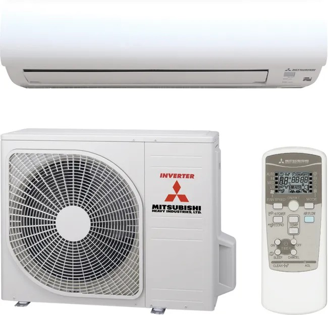

saveasteading Posted October 29, 2023 Posted October 29, 2023 I vote for this sort of thing, and plenty of insulation. Simple, efficient, diy, cheap and will quickly warm the air. 1

saveasteading Posted October 29, 2023 Posted October 29, 2023 1 hour ago, Canski said: thought A2A units need to be installed by a FGAS I don't think so, but others know better than I. I took the photo off a Spanish/French diy store website because I knew there would be loads. €650 to buy, or €1,200 installed so that doesn’t sound difficult.
