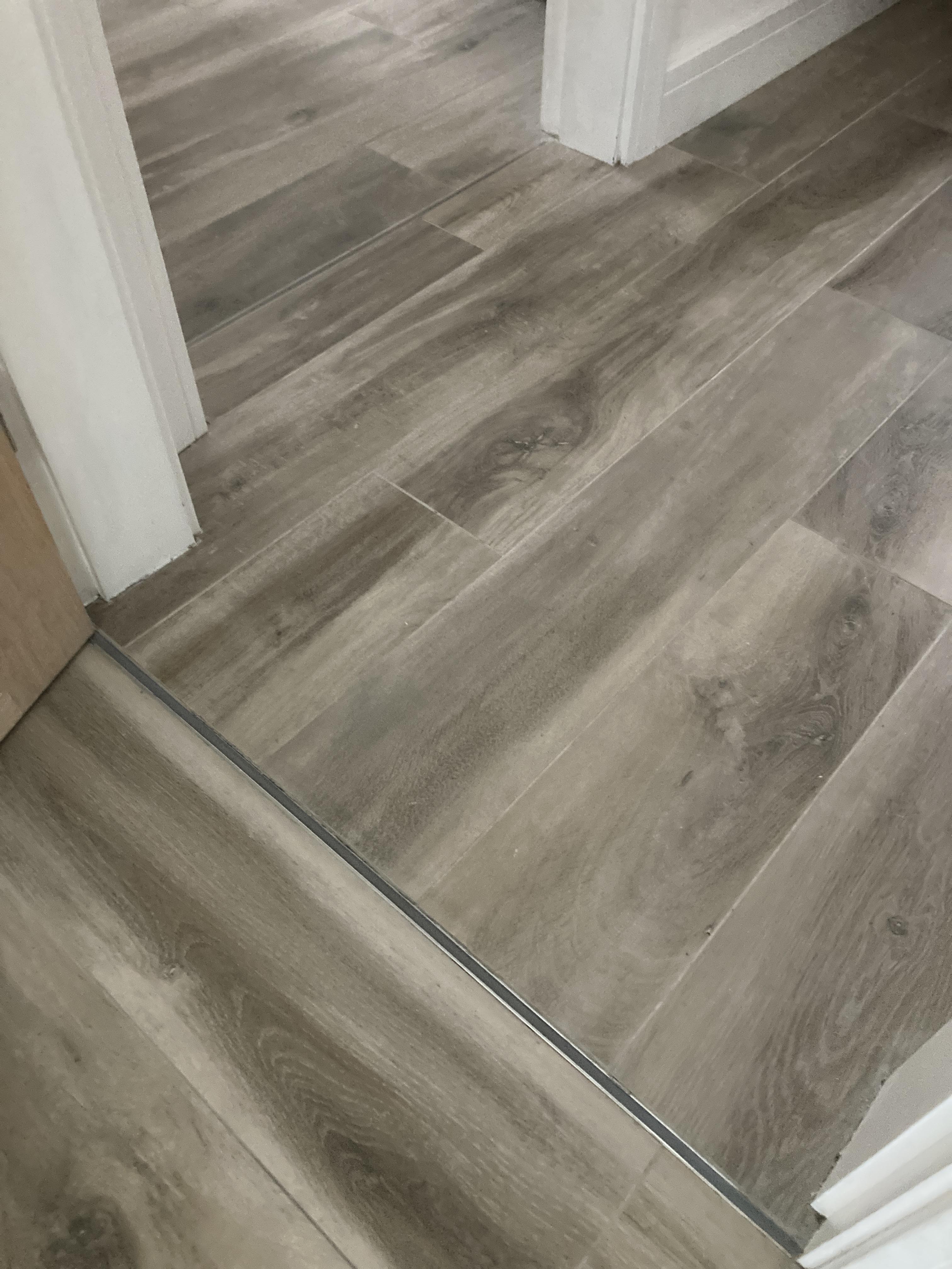

nod Posted February 12, 2022 Share Posted February 12, 2022 1 hour ago, Porthole said: Many thanks Nick - that's really helpful. Tiler is installing ditra anyway so that's good. We'll make sure heating is turned down!!! I thought it was a bit high - should trust our instinct next time. Make sure tiler puts expansion joints across EVERY doorway 1 Link to comment Share on other sites More sharing options...
Nickfromwales Posted February 12, 2022 Share Posted February 12, 2022 Low temp slab can usually get away without expansion joints, but deffo good insurance with screed. ?? Link to comment Share on other sites More sharing options...
nod Posted February 12, 2022 Share Posted February 12, 2022 11 minutes ago, Nickfromwales said: Low temp slab can usually get away without expansion joints, but deffo good insurance with screed. ?? We always put them in regardless of UFH and matting There should be expansion joints in the screed also Nearly always crack in doorways Link to comment Share on other sites More sharing options...
