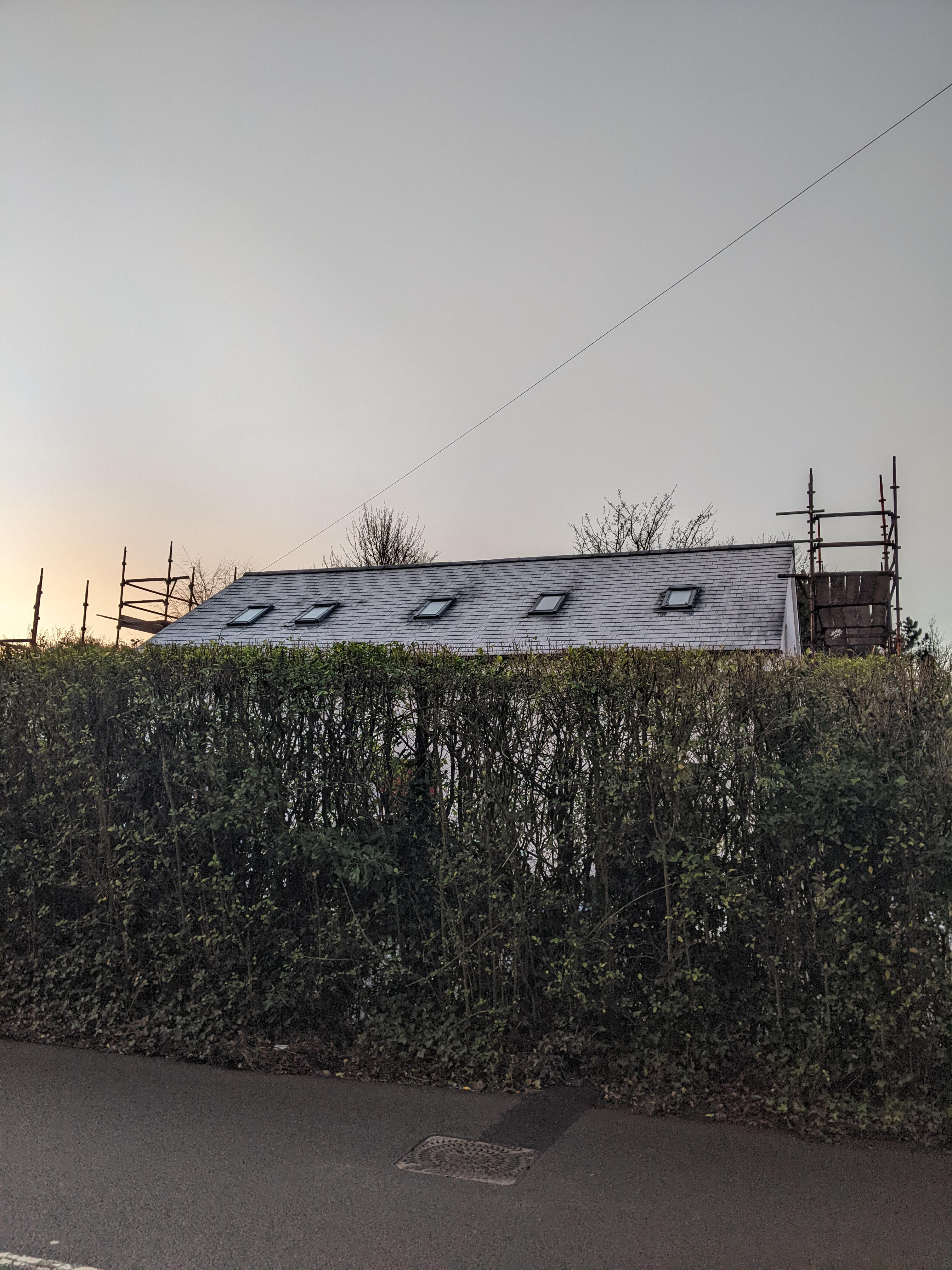

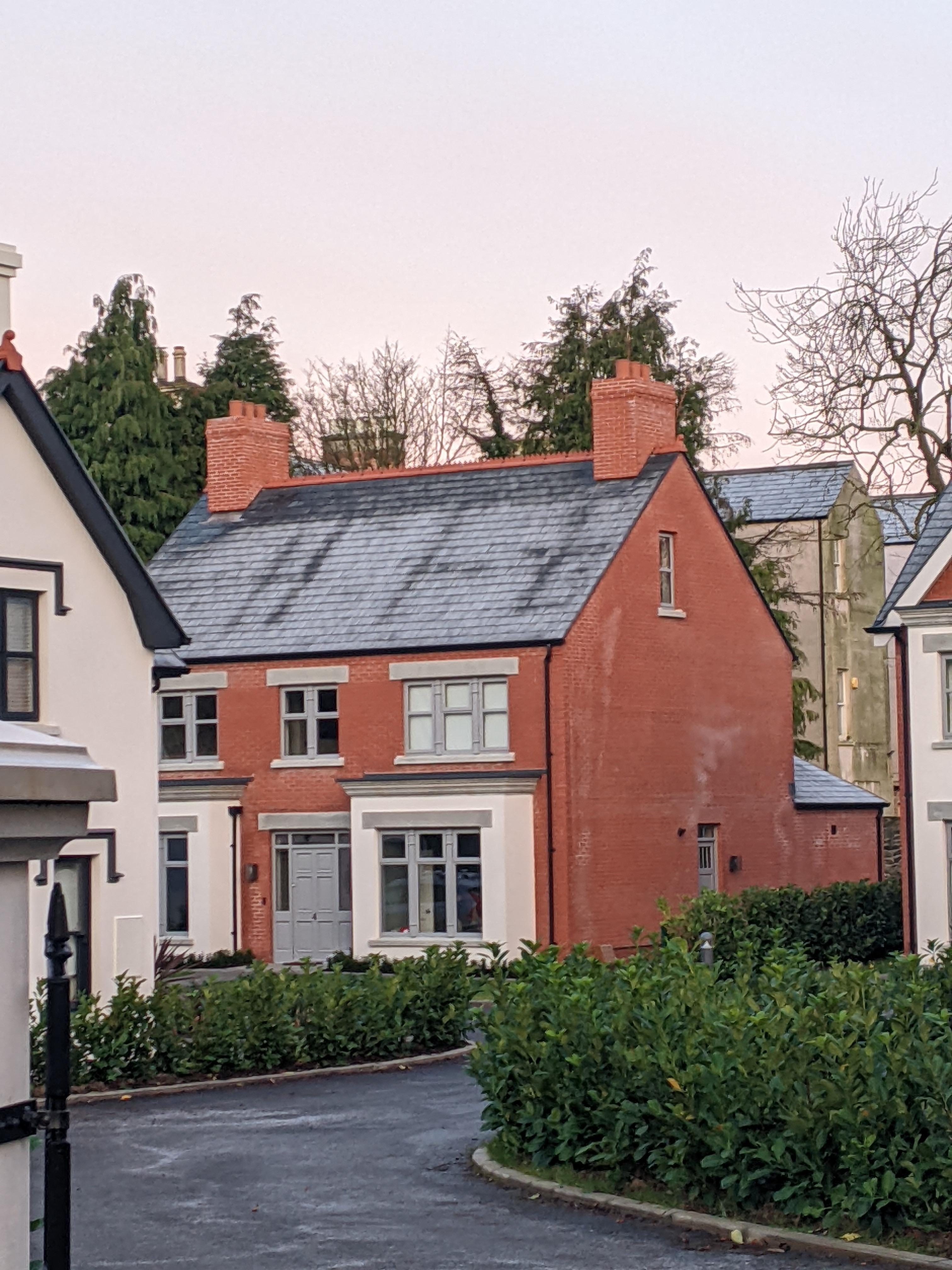

Conor Posted February 11, 2022 Posted February 11, 2022 Brand new £850k "bespoke" developer home 50m from our plot. Vast majority of homes in the area still had their full coat of frost at this time. Maybe this guy has the gas on 24x7 and the thermostat set to 25c??!!! (The chimneys are fake fibreglass jobs, I don't think the houses have open fires)

Marvin Posted February 11, 2022 Posted February 11, 2022 20 minutes ago, Conor said: Brand new £850k "bespoke" developer home 50m from our plot. Vast majority of homes in the area still had their full coat of frost at this time. Maybe this guy has the gas on 24x7 and the thermostat set to 25c??!!! (The chimneys are fake fibreglass jobs, I don't think the houses have open fires) Loft extension leaking heat..
Conor Posted February 11, 2022 Author Posted February 11, 2022 9 minutes ago, Marvin said: Loft extension leaking heat.. Bet the insulated the roof as far as the loft ceiling and didn't bother putting any into the loft/ridge. I know the builder he's a good guy, high quality work and does higher end stuff. Makes you wonder what goes on at the sites where they don't care at all. 2

Marvin Posted February 11, 2022 Posted February 11, 2022 (edited) 44 minutes ago, Conor said: Bet the insulated the roof as far as the loft ceiling and didn't bother putting any into the loft/ridge. I know the builder he's a good guy, high quality work and does higher end stuff. Makes you wonder what goes on at the sites where they don't care at all. Could be a leaky loft hatch..... People buy by form, and suffer with function. Looks great Actually a sack of s... Edited February 11, 2022 by Marvin Add info
tonyshouse Posted February 11, 2022 Posted February 11, 2022 I have loads of pics of snow and frost on roofs, there are lots of variables but some useful information can be gathered
Cpd Posted February 11, 2022 Posted February 11, 2022 10 hours ago, Conor said: I'm disappointed with the performance of the roof lights Were they velux ? Did you use the insulation kits they provide ? I insulated my own as I went so that I could be sure it was well done.
Conor Posted February 11, 2022 Author Posted February 11, 2022 Just now, Cpd said: Were they velux ? Did you use the insulation kits they provide ? I insulated my own as I went so that I could be sure it was well done. No, keylight. They are fitted as per the instructions but we added 50mm insualtion around the reveal before plaster boarding.
