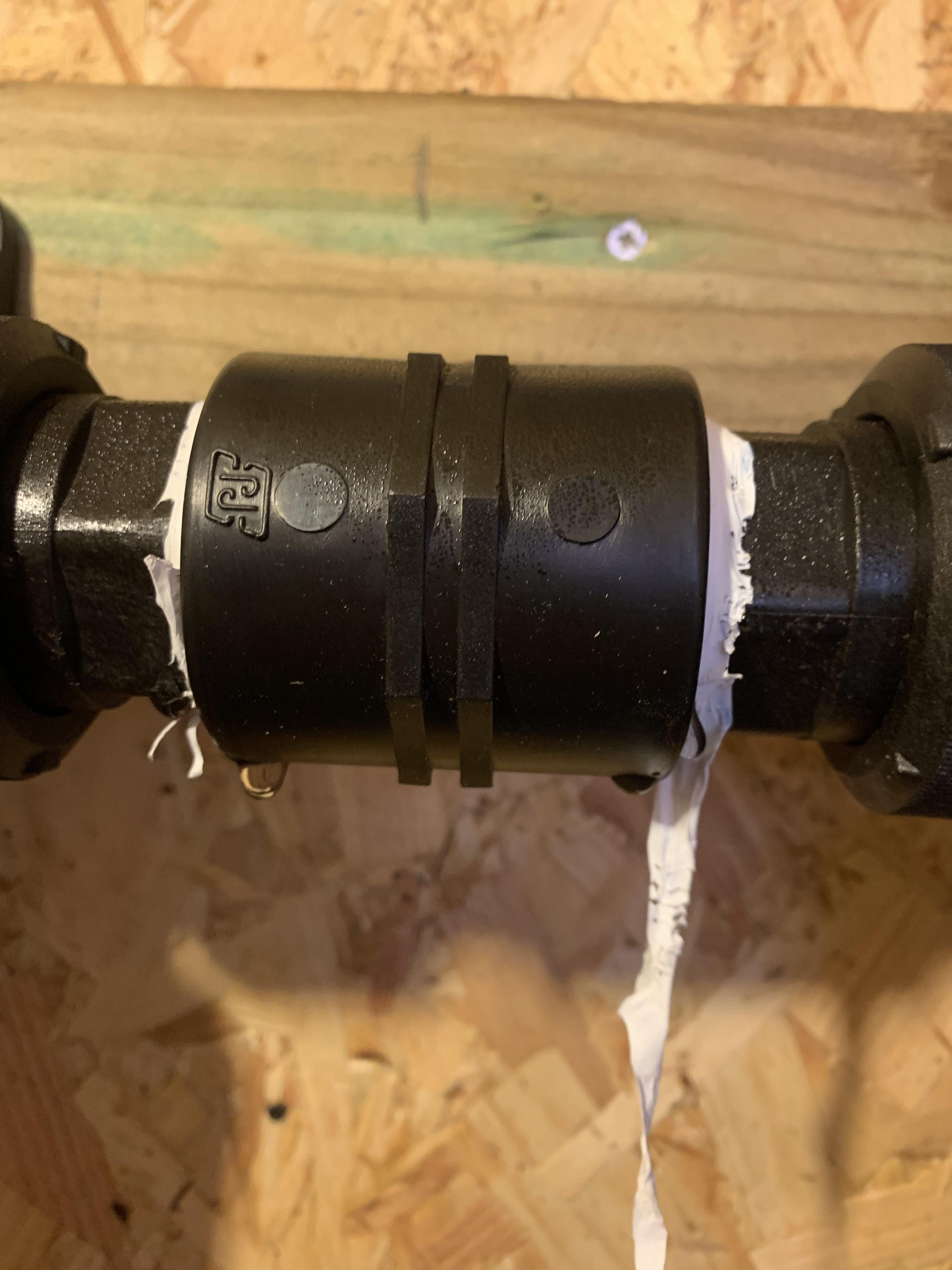

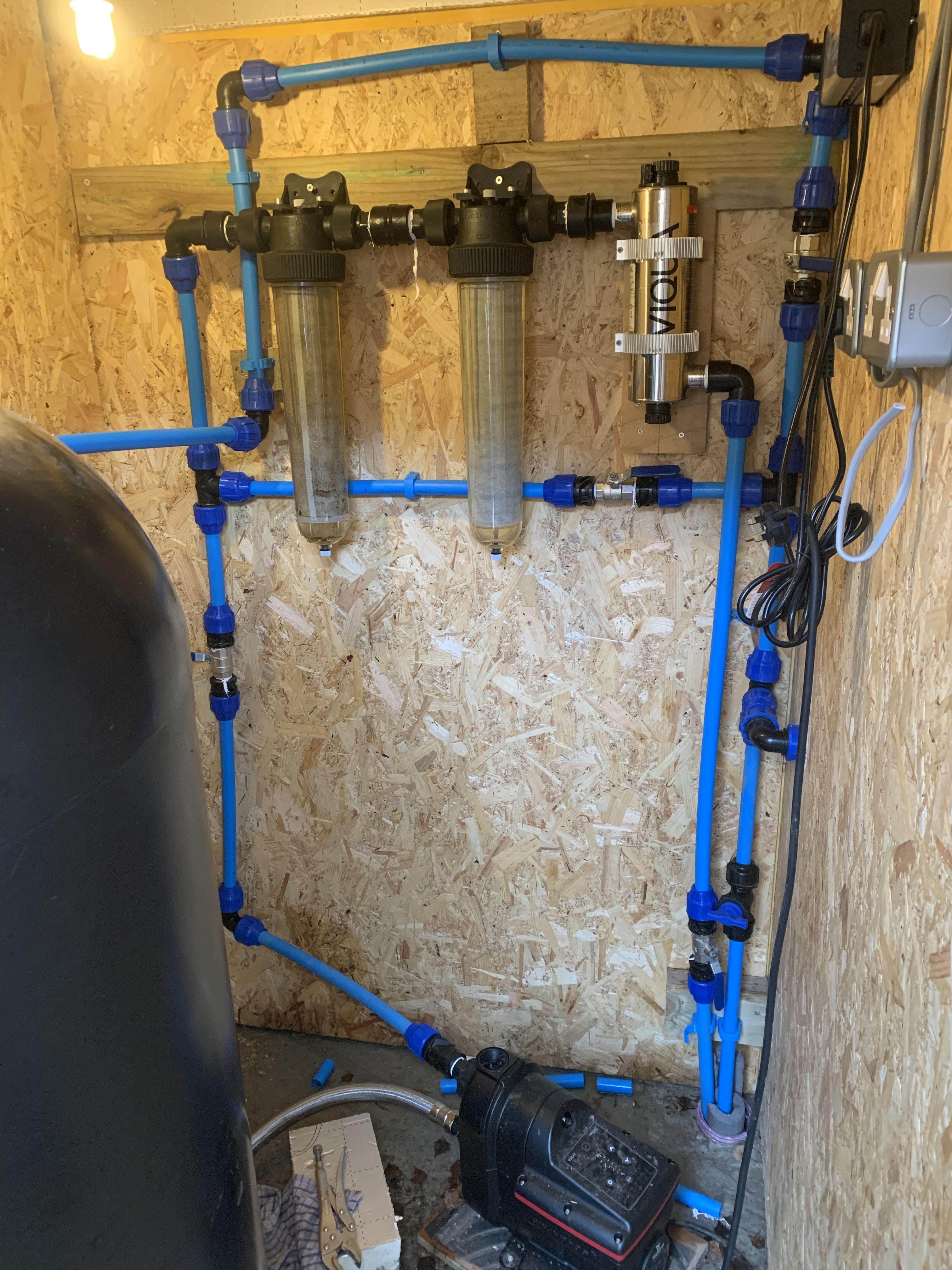

Easain Posted February 8, 2022 Share Posted February 8, 2022 I’m building a uv water treatment and break tank with pump in an outbuilding as we are on private supply. I cannot get these joints to seal with lots of ptfe tape. I have seen others on the forum use these joints so I presume it would work. Any advice appreciated . Link to comment Share on other sites More sharing options...

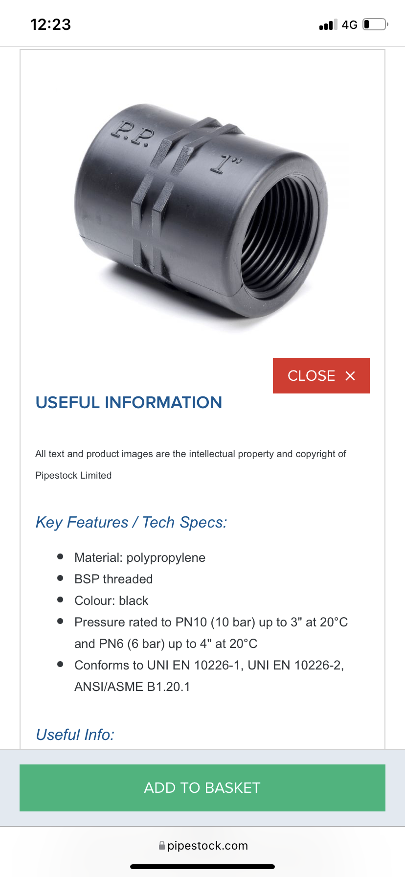

Cpd Posted February 8, 2022 Share Posted February 8, 2022 (edited) Are you sure you have the right threads on both sides ? i used the same make valves as the fittings without a problem…. if your mixing brands of fittings this may be a problem but not something I came across. i have just checked my coupling between the two particles filters and it’s exactly the same as yours and mine does not leak, so I can only assume you have not got enough PTFE tape….. strange Edited February 8, 2022 by Cpd Link to comment Share on other sites More sharing options...
markc Posted February 8, 2022 Share Posted February 8, 2022 Has to be a thread mix match Link to comment Share on other sites More sharing options...

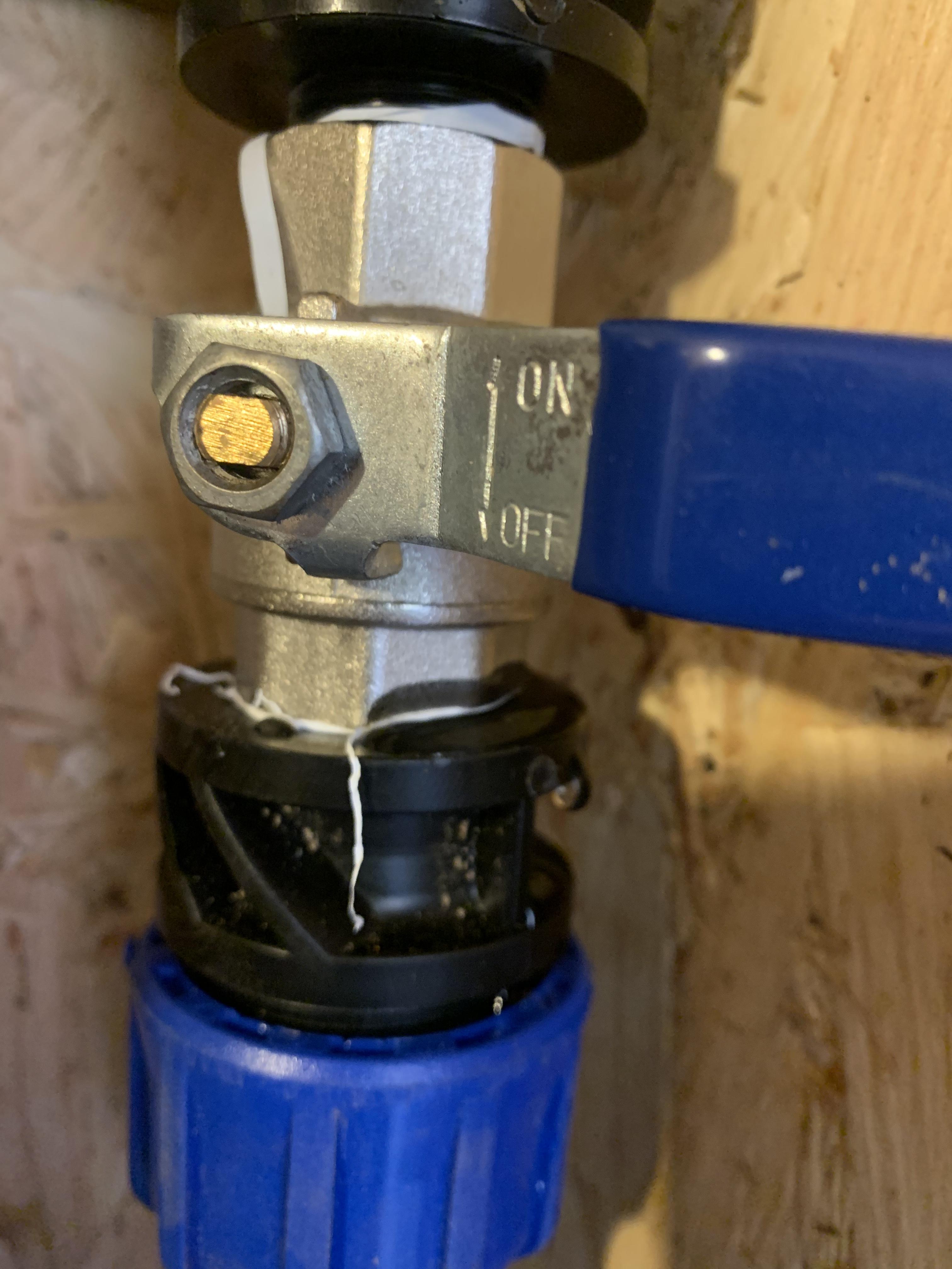

Easain Posted February 8, 2022 Author Share Posted February 8, 2022 @Cpd I presumed everything was a parallel thread as there didn’t seem to be other option for connections - I seems that all my threaded connections are seeping even when plastic/plastic or plastic/metal. Link to comment Share on other sites More sharing options...
markc Posted February 8, 2022 Share Posted February 8, 2022 Hmmm, did you wrap enough turn of PTFE to make the joints tighten up as then were wound in? Secret is to create a taper with the tape so the joint becomes progressively tighter and locks up before bottoming on the socket Link to comment Share on other sites More sharing options...
Easain Posted February 8, 2022 Author Share Posted February 8, 2022 @markc thanks, I think this will be my next thing to try yes . had wondered if there was anything thicker then ptfe tape I could try? after connecting everything I realised I didn’t leave enough room between the roof to fit the uv bulb in so need to dismantle and re jig it all anyway ? Link to comment Share on other sites More sharing options...
Gone West Posted February 8, 2022 Share Posted February 8, 2022 3 hours ago, Easain said: had wondered if there was anything thicker then ptfe tape I could try? There are two types of PTFE tape, the standard plumbing type and the gas grade type which is much thicker. Link to comment Share on other sites More sharing options...
JohnMo Posted February 8, 2022 Share Posted February 8, 2022 If you need to do more than 3 wraps with your PTFE, your threads do not match. Check everything you have bought is compatible. Link to comment Share on other sites More sharing options...
