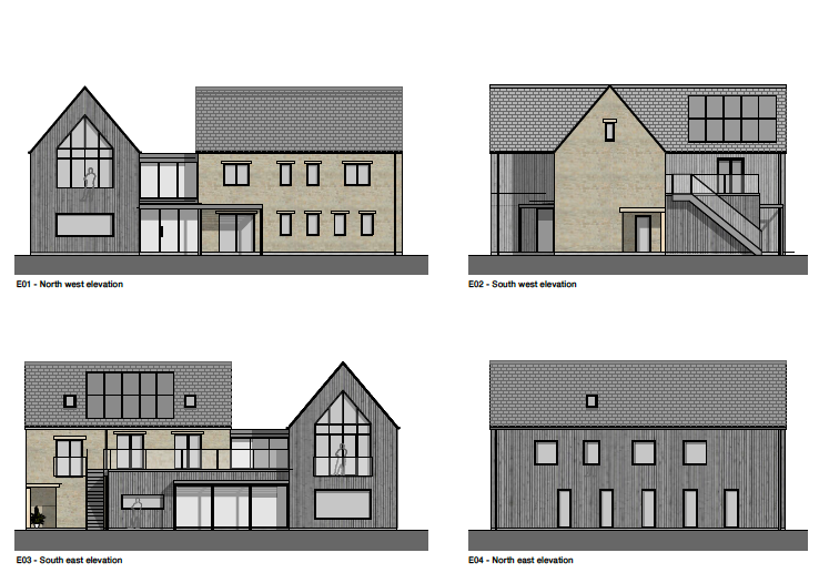

We are at the point of deciding whether we opt for a fixed price from our builder or employ him (with his company) as the Project/Site Manager for our new build project (demolish bungalow and build 2 storey house).
We accept that for a fixed price at this time he will have to build in a risk/contingency amount in the price because of the uncertainty over material prices over the period of the build - 48 weeks.  He's set this at around 15%.
The alternative is to pay him a fixed sum to project manage the build - with his team plus subbies.  He will control the day to day work to stick to an agreed schedule, make sure all the trades work well together (and earn their money) and assure the quality of the work.  He will also source all the materials, arrange Building Control visits/sign off etc.
We will have an open-book meeting with him each week where he will report on how things are going - showing us the exact spend against the projected costs.  If we are over, we either decide what can be saved from elsewhere in the build or dip into the 15% contingency that we will hold.
Our concern is - will he be as motivated to stick to schedule and price if he is project managing?   And if not, how do we incentivise him to do so?
Grateful of thoughts?
