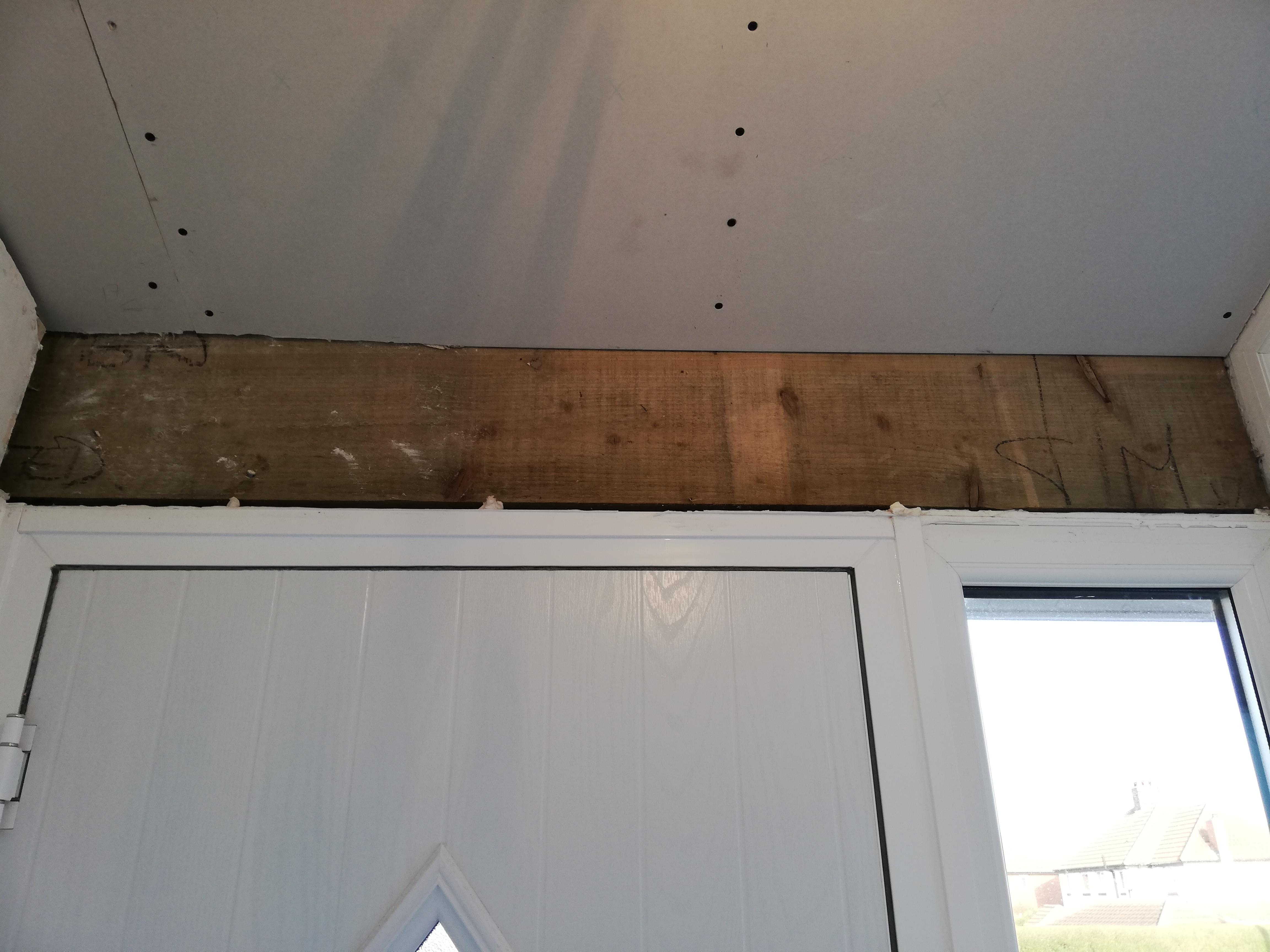

TheMick Posted February 1, 2022 Share Posted February 1, 2022 Hi everyone, I have plasterboard many a time but not come up against something like this. So above the door on a small porch which was added to the house at a later date. There is timber frame about 3" or 80mm thick as shown in photo. Does anyone know if screwing plasterboard directly onto this would cause any issue? If I batten it will bring it all proud of the door. Thanks for your help. Link to comment Share on other sites More sharing options...
Nickfromwales Posted February 1, 2022 Share Posted February 1, 2022 No issues there at all. “Carry on!” Link to comment Share on other sites More sharing options...

TheMick Posted February 1, 2022 Author Share Posted February 1, 2022 Thanks for your responses. I was worried that perhaps plasterboard directly on and then skimmed might crack with vibration from the opening and closing of the door. I might be looking to deep into it as it's just not natural to me to not batten. Link to comment Share on other sites More sharing options...
