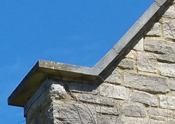

SuperPav Posted January 27, 2022 Posted January 27, 2022 How much am I overthinking this? Cavity wall, 100mm aerated block inner, 125mm stone outer, 125mm average cavity, full fill with icynene. Roof is a room-in-roof with vaulted ceiling, 200mm rafters hung off glulam ridge beam. At the gable ends, there will be stone coping (450mm wide). This needs to rest on both leaves, thus bridging the cavity, but also the upstand where the leaf flashing goes on the inner leaf is exposed to cold air anyway, so either way, the top of the inner leaf gets cold. This obviously just transfers down along the wall. 1) How much of a problem is this in reality (the house is far from passive house standards, this is a second storey add-on onto an existing old bungalow)? 2) Do I need to run a single pitched or stepped course of Marmox thermoblock to somehow decouple the upstand from the inner leaf below? I'm not as fussed about the actual amount of heat loss as much as I am about potential interstital condensation on the inner blockwork at the top of the gables alongside the pitched rafters which are insulated.... Same with the kneeler blocks at the bottom of the gable, which would normally bridge the cavity, something I'm trying to avoid. I'm ready to pay £500 in thermoblocks for the 3 gables if it would help and I can figure out how to actually get it laid, but don't want to do it if it's marginal as the budget is quite tight anyway....

Radian Posted January 28, 2022 Posted January 28, 2022 This looks like a 'cold roof' How are the rafters ventilated? Of more immediate concern to me is your cavity closer. Your copings will have mortar joints so the underlying surface will see a fair bit of water. You have 75mm flashing over the inner leaf only. You need a waterproof layer capping off the entire span. 1

Radian Posted January 28, 2022 Posted January 28, 2022 We built our house in 1997 and the Architect left the details of setting the copings to the masons. The very first snag we ran in to was water appearing around window reveals in the gable wall. This was because the coping stones were simply set to span across the cavity on slates with no overlap. Evidently they thought water wouldn't make it to the joints. Huh. The whole lot was stripped off and re-laid on a continuous roll of lead. This has to be turned down over the edges I'm afraid (no problem on the roof side) but water will seep into your external stonework if you hide it back in. Up to you. I don't know how it could safely be made much prettier. As for thermal bridging, we have a cold loft space so there's no issue. 1

SuperPav Posted January 28, 2022 Author Posted January 28, 2022 That was my first thought, the problem is Marmox is 65mm thick, which itself isn't enough for the upstand. Sticking a diagonal course of masonry on top of the marmox on a 42-43 deg slip plane doesn't seem right, so would I just keep the marmox block down with timber and just screw all the way through it to the masonry below. In which case I might as well use the PIR as much cheaper than a marmox board, given there is hardly any loading on this. I'm also now interested where the hell originally the idea of coping gables came from historically? Surely running the roof tiles to the end would have been more robust, cheaper and easier for all involved. It's not like this saves on any materials (e.g. lead etc.) that would've been hard to come by in the past. Was it purely a design thing??
Radian Posted January 28, 2022 Posted January 28, 2022 4 minutes ago, SuperPav said: I'm also now interested where the hell originally the idea of coping gables came from historically? Surely running the roof tiles to the end would have been more robust, cheaper and easier for all involved. It's not like this saves on any materials (e.g. lead etc.) that would've been hard to come by in the past. Was it purely a design thing?? There are numerous reasons. I think Parapet roofs were mainly used as a way of preventing the spread of fire between buildings but they can also reduce wind loads on the roof. Ours was the whim of an Architect and we liked the look of it. Too bad the trades that put it up were out of their depth.
