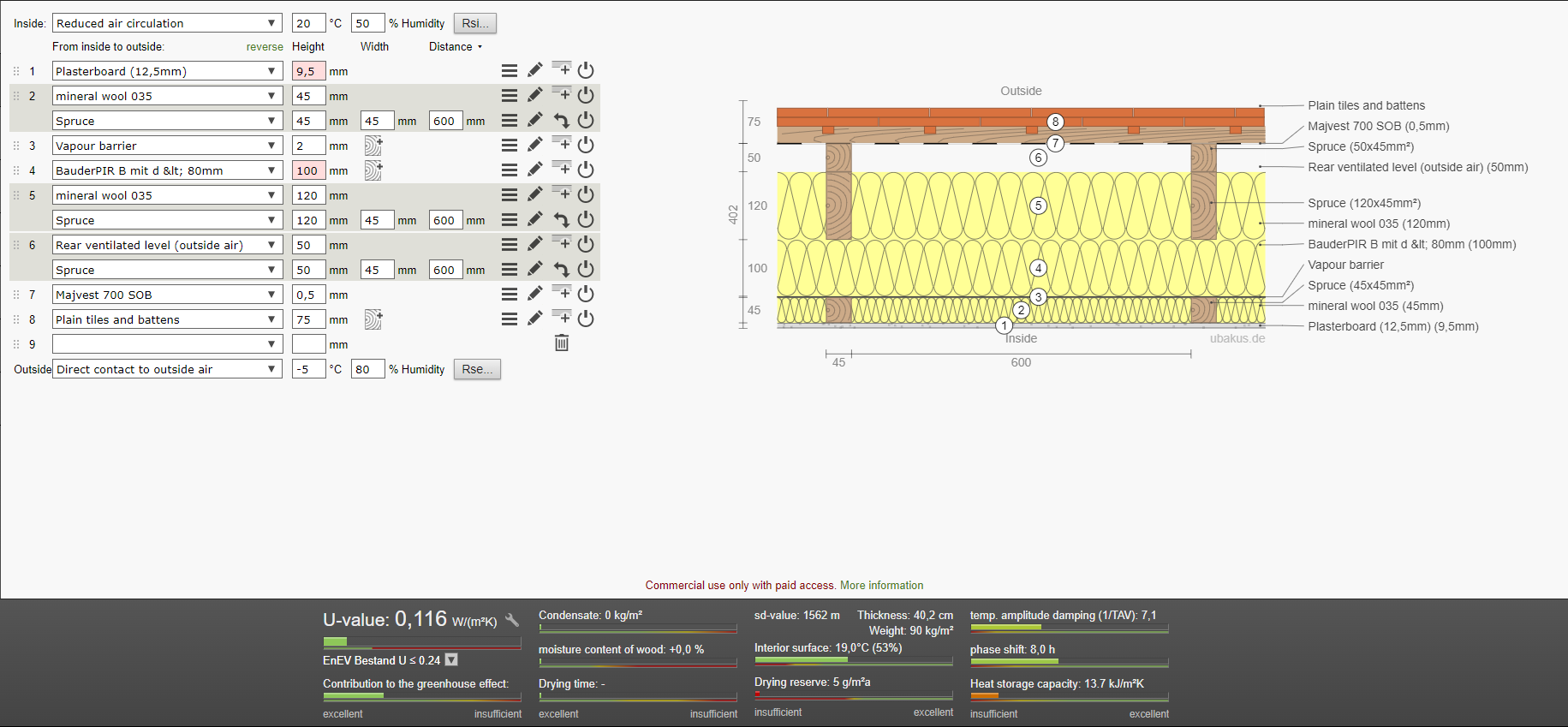

F113tch Posted January 26, 2022 Author Posted January 26, 2022 On 26/01/2022 at 10:19, Iceverge said: I would keep away from PIR in the roof. Especially as it's a cold one. Mineral wool will be much cheaper and far easier to fit. Blown cellulose is a top choice if you can get it. It's what we used. Expand I have vaulted ceilings - would this lend itself to a mineral wool installation please? For information, the rafters are 170mm deep, therefore allowing a 20mm air gap, I can fit up to 150mm of insulation between the rafters. I can also add up to 80mm of insulated plasterboard beneath the rafters. I was advised by the architect not to fit insulation on the 1st floor which is a block and beam construction. Was this good advice please?

Iceverge Posted January 26, 2022 Posted January 26, 2022 Your options are limited so. Mineral l wool between the rafters would be easier to fit than PIR. Then a continuous layer of pir and then a vcl. The a battened and insulated service cavity.

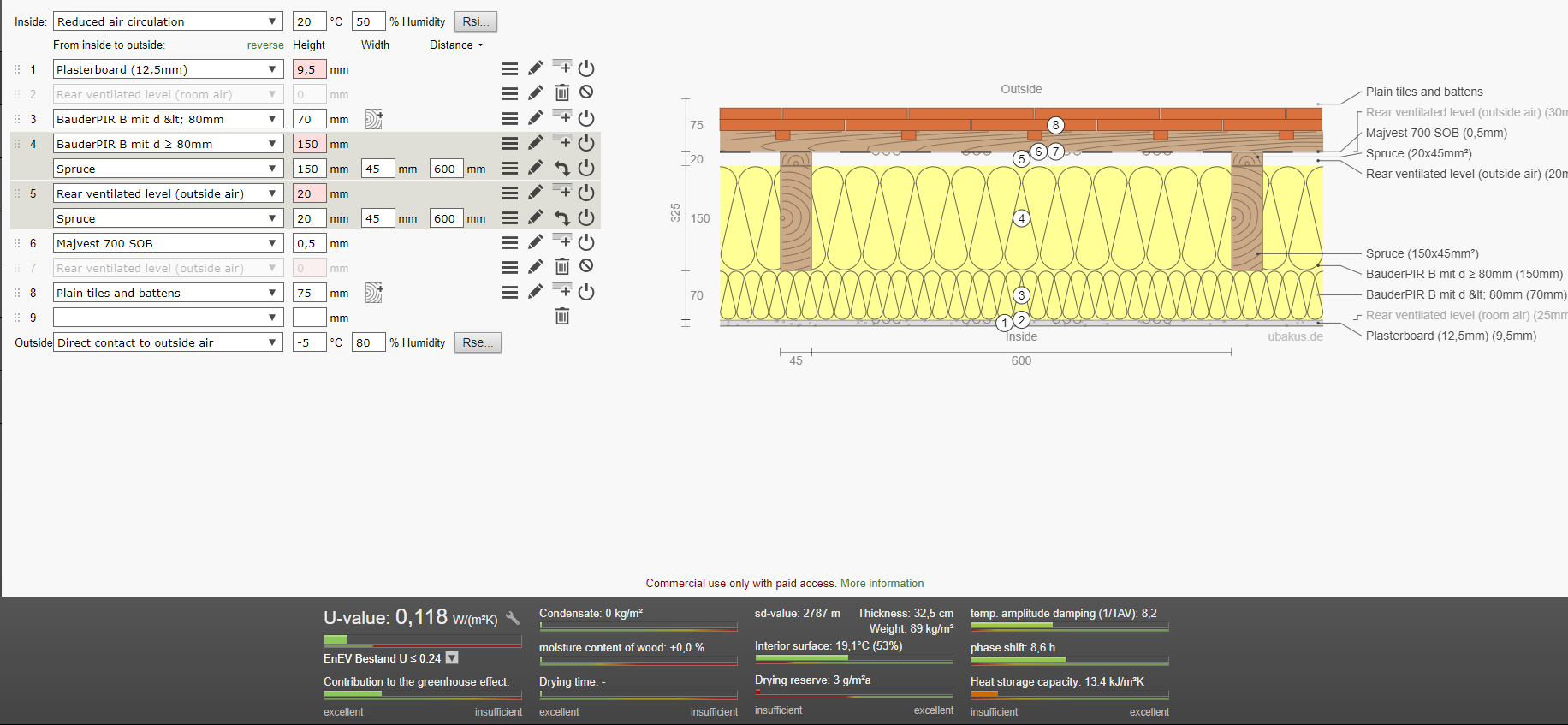

F113tch Posted January 27, 2022 Author Posted January 27, 2022 On 26/01/2022 at 23:41, Iceverge said: Mineral l wool between the rafters would be easier to fit than PIR. Then a continuous layer of pir and then a vcl. The a battened and insulated service cavity. Expand As my rafters are 170mm deep, `I can fit a maximum of 120mm of insulation between then to give a 50mm air gap. Mineral wool, or equivalent, I assume would be much easier to fit than PIR and, again I assume, will be easier to get much closer fitting (less air gaps), but the U-values are higher than for the same depth of PIR. I am open to suggestions though!
Iceverge Posted January 27, 2022 Posted January 27, 2022 On 27/01/2022 at 19:50, F113tch said: I assume would be much easier to fit than PIR and, again I assume, will be easier to get much closer fitting (less air gaps), but the U-values are higher than for the same depth of PIR. Expand Correct. Your current option. Insulation materials alone ex fitting ex VAT £48/m2 Alternate option. Roof is thicker by 75mm. Not sure if that will effect you. Insulation cost + battens + vapour control layer + plasterboard. is about £44.30 per m2 so not a huge saving. It'd be easier to get good airtightness and fit services however.
F113tch Posted January 27, 2022 Author Posted January 27, 2022 Thanks for sending through. I have just read on here that, as I have used a breathable membrane, I do not require an air gap, therefore I could use 150mm mineral wool between rafters and then PIR beneath the rafters. I have exposed oak trusses so the maximum thickness I can go to beneath the rafters, including the plasterboard is 80mm. Would the above give a U-Value that Building Control would accept? Is there any reason not to fasten insulation to the underside of the timbers and then fasten plasterboard to the insulation as this looks a cheaper solution than insulated plasterboard but is effectively the same? Or is it!? Also, looking at the above you have sent through, can you help me understand when and where vapour barriers go please? Thanks, Steve.
