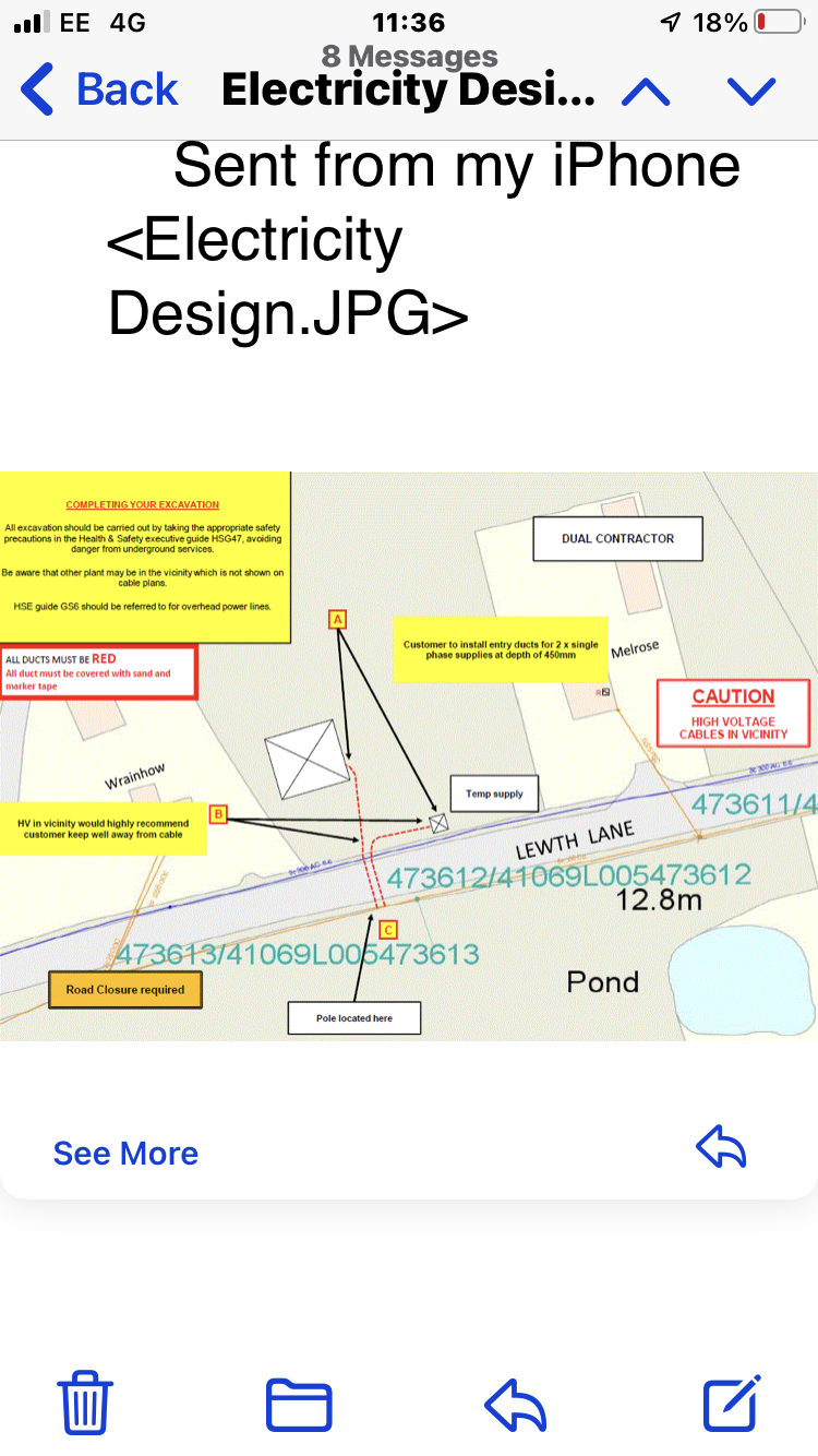

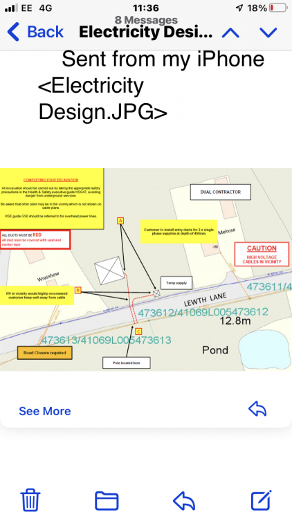

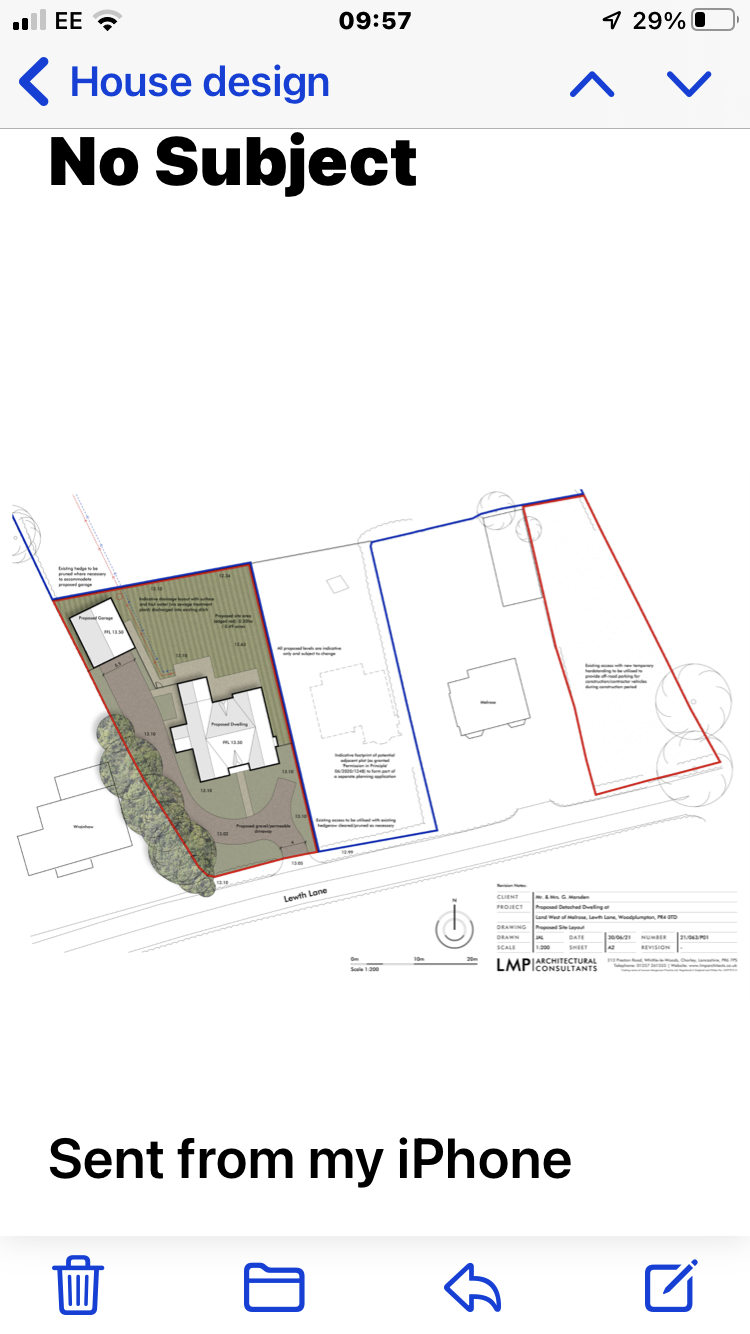

nod Posted January 22, 2022 Author Share Posted January 22, 2022 1 hour ago, PeterW said: Suppose it depends on the redundancy you want - I would get a 3Ph install to a dedicated kiosk just inside the gate and then run a phase to the garage with a charge point on it, another to the house, and then have the 3rd as a “spare” which could provide a dedicated charge point somewhere on the driveway if needed. I know that Western Power are now installing 3Ph by default around here for all new connections which is more than likely to support car charging. I really should have sorted this out months ago but have been so bogged down with planning issues Would you mind marking up where you would bring the power into the house and the routes to the garage please Link to comment Share on other sites More sharing options...
PeterW Posted January 22, 2022 Share Posted January 22, 2022 @nod yep will do. Have you had a quote from UK Power Networks to install single or 3 phase ..? I’ve got a link to your PP somewhere so will use the site plan - have you got a water connection .? And no gas ..? Link to comment Share on other sites More sharing options...
nod Posted January 22, 2022 Author Share Posted January 22, 2022 16 minutes ago, PeterW said: @nod yep will do. Have you had a quote from UK Power Networks to install single or 3 phase ..? I’ve got a link to your PP somewhere so will use the site plan - have you got a water connection .? And no gas ..? As always Thank you Pete Link to comment Share on other sites More sharing options...
