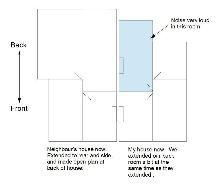

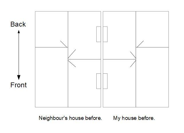

JMPS Posted January 20, 2022 Share Posted January 20, 2022 Hi Our neighbours recently had a pretty significant single storey extension built, going out a few metres at the back and wrapping round the side. With that new space at the rear, they opened it up to include the old back room and kitchen, so they have one large open plan area. This new open plan area has tiled flooring, and there are very few soft furnishings as they have a long line of bi-folds out to the back, so not really suited to curtains. Prior to the work being done, we could hear very little indeed from their side - the old back room was smaller, carpeted, and had curtains. Since the work though, the noise is pretty awful - some of it (for instance furniture being moved and scraping the floor) seems to reverberate around their side, but still comes through as sound rather than shaking, etc. Just general conversations are incredibly loud too though - we can often make out exactly what is being said at a fairly normal level of conversation, and if they're being louder (having guests around, etc) then it's difficult to even watch TV as the sound from next door overpowers the sound from the TV. We raised it as an issue after the work was all completed and we realised what it was like, and they installed some slatted wood soundproofing panels to the walls on their side, and although that had an effect to a degree, the noise is still too problematic to put up with. Has anyone else been in this position and managed to resolve it satisfactorily? I've looked on loads of sites where people offer all kinds of solutions, but it seems pretty hit and miss. It often appears that it's pretty much guesswork as to how to resolve things, and a lot of money can be spent without any real improvement. Are there specialists out there that can actually pinpoint accurately what the issue is, and then guarantee a fix? Any help would be greatly appreciated, JMPS Link to comment Share on other sites More sharing options...

JMPS Posted January 22, 2022 Author Share Posted January 22, 2022 Thanks Adrian. Unfortunately not - I'm in the North West. I've attached a couple of pictures to show the changes. Link to comment Share on other sites More sharing options...
MAB Posted January 23, 2022 Share Posted January 23, 2022 I see they have removed their chimney breast, they consist of a lot of mass and bricks in 1930's semis and if not removed carefully can increase sound passing through a party wall. Just a thought, also is your fireplace open or bricked up? Link to comment Share on other sites More sharing options...
Adsibob Posted January 23, 2022 Share Posted January 23, 2022 23 hours ago, JMPS said: Thanks Adrian. Unfortunately not - I'm in the North West. I've attached a couple of pictures to show the changes. Shame you didn’t soundproof the party wall at the time you extended. 1 Link to comment Share on other sites More sharing options...
JMPS Posted January 24, 2022 Author Share Posted January 24, 2022 Our fireplace isn't bricked up, but it has a gas fire in it. Unfortunately sound problems weren't even a consideration for ourselves or our neighbours when the work was being done - disappointing that the builders, architects, etc didn't raise it. Link to comment Share on other sites More sharing options...
