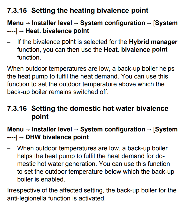

ColB Posted January 18, 2022 Share Posted January 18, 2022 (edited) 5 hours ago, AdyHoggs said: Hi, My Vaillant heat pump system is timed to come on during the night, it normally comes on as planned and I wake up with a warm house, this Hi Ady, What's your 'Heat bivalence point' set to? Might want to make sure it's set to -20 if you've got no backup heating system. Edited January 18, 2022 by ColB 1 Link to comment Share on other sites More sharing options...

AdyHoggs Posted January 18, 2022 Author Share Posted January 18, 2022 (edited) 29 minutes ago, ColB said: Hi Ady, What's your 'Heat bivalence point' set to? Might want to make sure it's set to -20 if you've got no backup heating system. Hi ColB, It was set to -15 I’ve now changed it to -20 on your advice. Both times this has happened it has been a foggy night, would this affect the heat pump. BTW what is the heat bivalence point, is it the outside temperature? Edited January 18, 2022 by AdyHoggs Link to comment Share on other sites More sharing options...

ColB Posted January 18, 2022 Share Posted January 18, 2022 (edited) 50 minutes ago, AdyHoggs said: Hi ColB, It was set to -15 I’ve now changed it to -20 on your advice. Both times this has happened it has been a foggy night, would this affect the heat pump. BTW what is the heat bivalence point, is it the outside temperature? When the outdoor temp is lower than the bivalence point, the backup boiler kicks in. If yours is set to -15 then I don't think it was your issue. Worth watching this video and compare the suggested settings toward the end. https://www.youtube.com/watch?v=3KVs7oHynEM Edited January 18, 2022 by ColB 1 Link to comment Share on other sites More sharing options...
