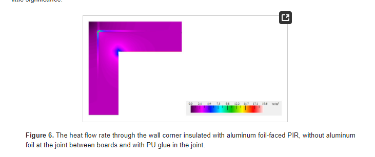

Preferably you would need to pre age the boards to ensure they had already shrunk before installation. Take care to carefully tape all nicks and cracks in the foil facing to prevent gas migration. Also you would need to account for the thermal bridging of the foil face of the insulation at corners.
