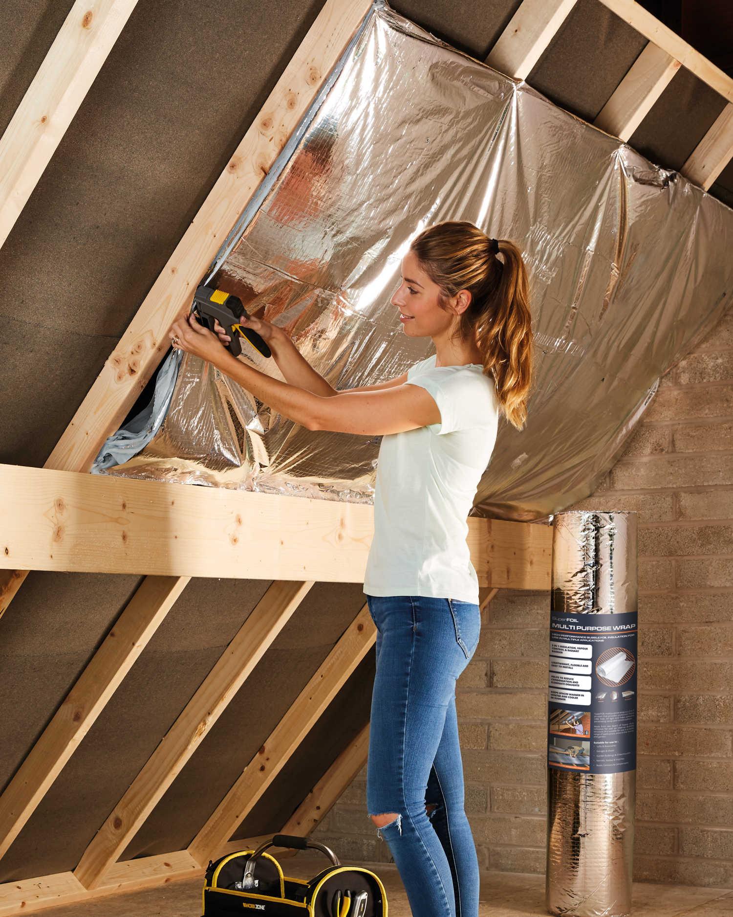

Aldi Special on superfoil SF6
 Aldi are currently slinging "airtight multilayer foil insulation designed by SuperFOIL with the DIY customer in mind"
According to the SF6 data sheet its Water Vapour Resistance is 1200MNs/g which makes it vapour tight in addition to being airtight.
I understood that this was a no-no in the kind of application they're pushing here?  WIth an R-value of just 1.9 that's going to be a cold surface for vapour to condense on.
Am I missing something?

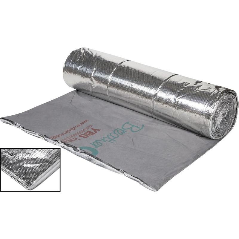

However, this product caught my eye because I'm considering investing £630 for 6 rolls of YBS BreatherQuilt 2 in 1 Multi Layer Insulation Blanket which has a very low vapour resistance (0.15MNs/g) to drape over the top of 300mm rockwool to give me a maintainable surface and boost the total R-value a little. Just a little...
...I really only want the perforated foil layer as the r-value of this blanket is 1.6 whereas the 300mm rockwool underneath should be around 6. And I suspect that when laid flat the blanket drops to more like 1.

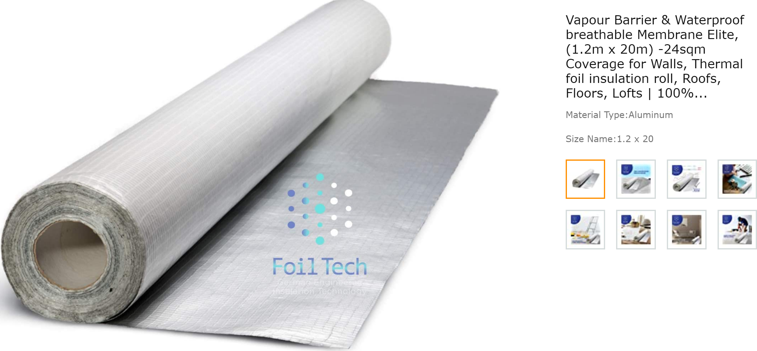

Annoyingly I also found exactly what I want - if only it really were breathable:
2038976355_Screenshot2022-01-1112_45_01.thumb.png.704fef13c3f40e702248cd78cf060c02.png

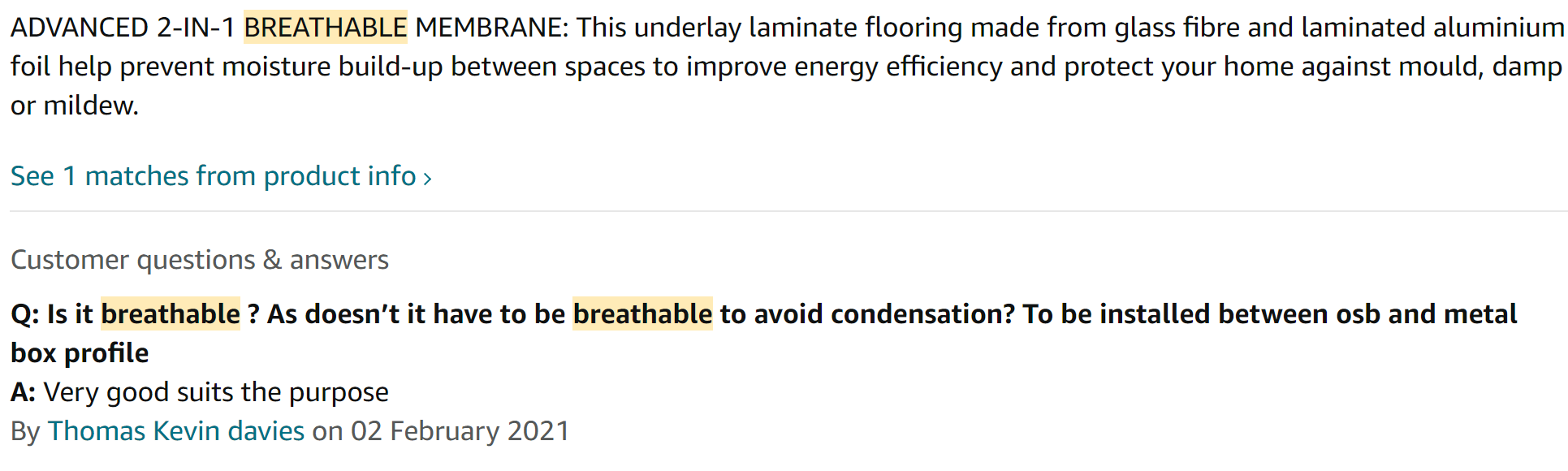

"Vapour Barrier & Waterproof breathable Membrane" must mean air breathable? After all, if it's a vapour barrier then what's it breathing? Air sans water vapour? I guess that might be possible but from the look of it nothing's going to get through. I just love the customer Q&A on this very point:
1399289550_Screenshot2022-01-1112_58_30.thumb.png.6dd83b60a5c4926127e08f07e7ae1beb.png
Very helpful ?
