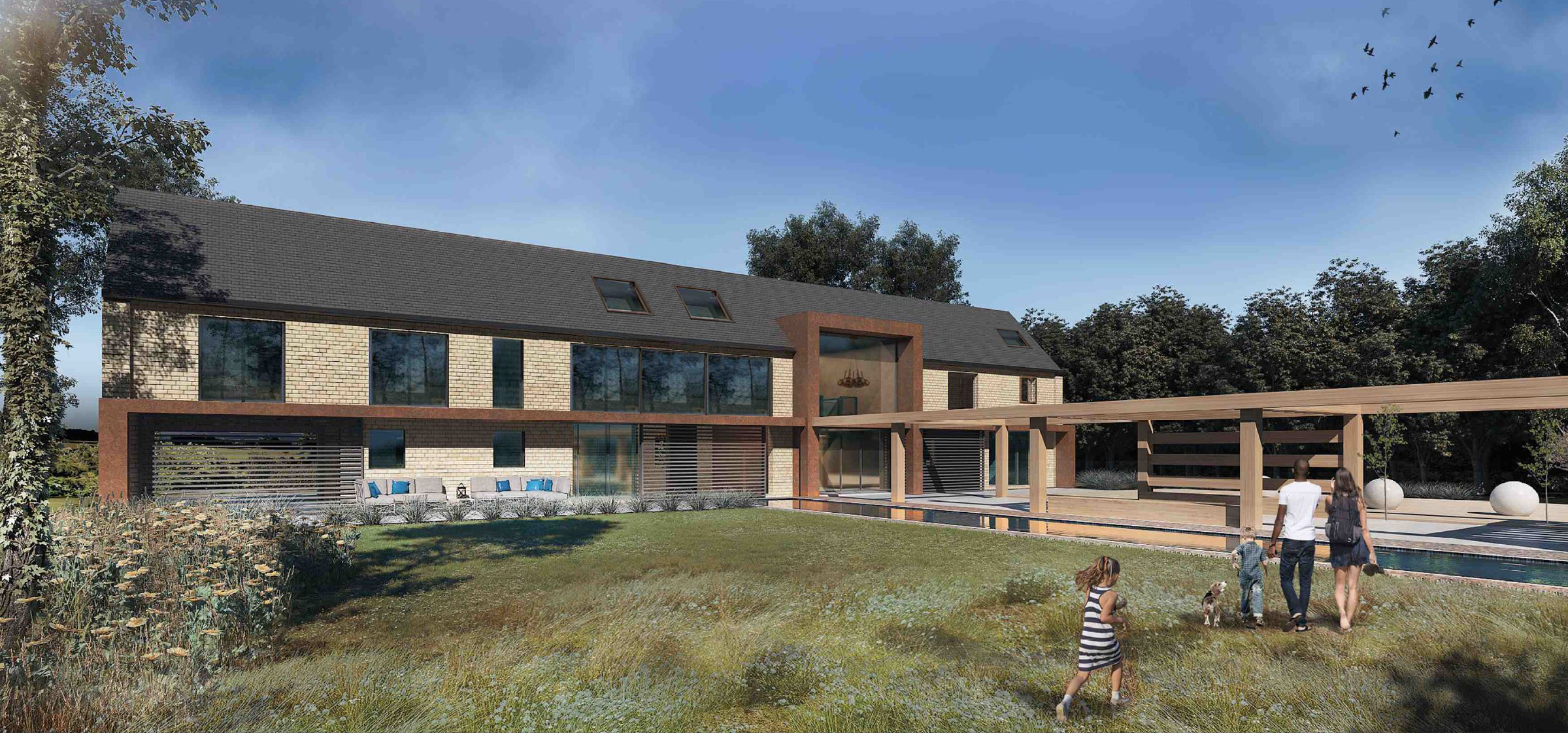

Zmarie Posted April 18, 2022 Share Posted April 18, 2022 On 10/01/2022 at 15:52, thefoxesmaltings said: Hi everyone, Just a quick introduction to our project - we're doing our first self build and will be project managing ourselves. We've got lot's to learn as we go, and so would love to connect with others who are also along the journey or recently completed. If you're interested in following our journey, we're documenting everything on instagram which has plans and more; our profile is here: @thefoxesmaltings Below is a 3D render our architect produced of our project. If anyone has questions on any part of our process so far (securing planning in an AONB/Green belt etc.) feel free to ask and we'll help if we can. Wow. This is a serious 'grand design'. Have just followed on instagram - project looks amazing, would love to build something like this. How long did planning take you out of interest and was it easy to achieve? Link to comment Share on other sites More sharing options...
thefoxesmaltings Posted April 19, 2022 Author Share Posted April 19, 2022 On 18/04/2022 at 07:36, Zmarie said: Wow. This is a serious 'grand design'. Have just followed on instagram - project looks amazing, would love to build something like this. How long did planning take you out of interest and was it easy to achieve? Planning total end to end was 4 years, but mostly handled by our architect. I'd be suprised if anyone told you it was easy to achieve planning under Paragraph 79 (Now 80) as there are some very strict (and quite vague) guidelines on what is a suitable proposal. I would recommend finding a great local architect who has a proven track record if success and/or planning consultant to assist. 1 Link to comment Share on other sites More sharing options...
