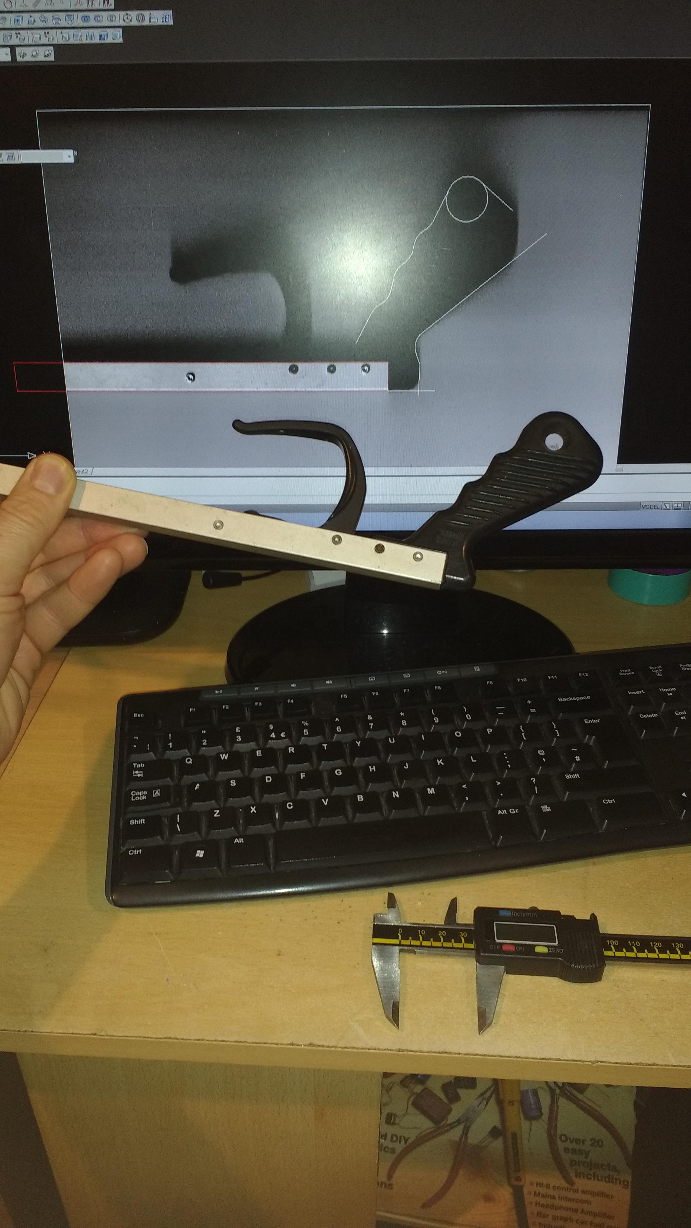

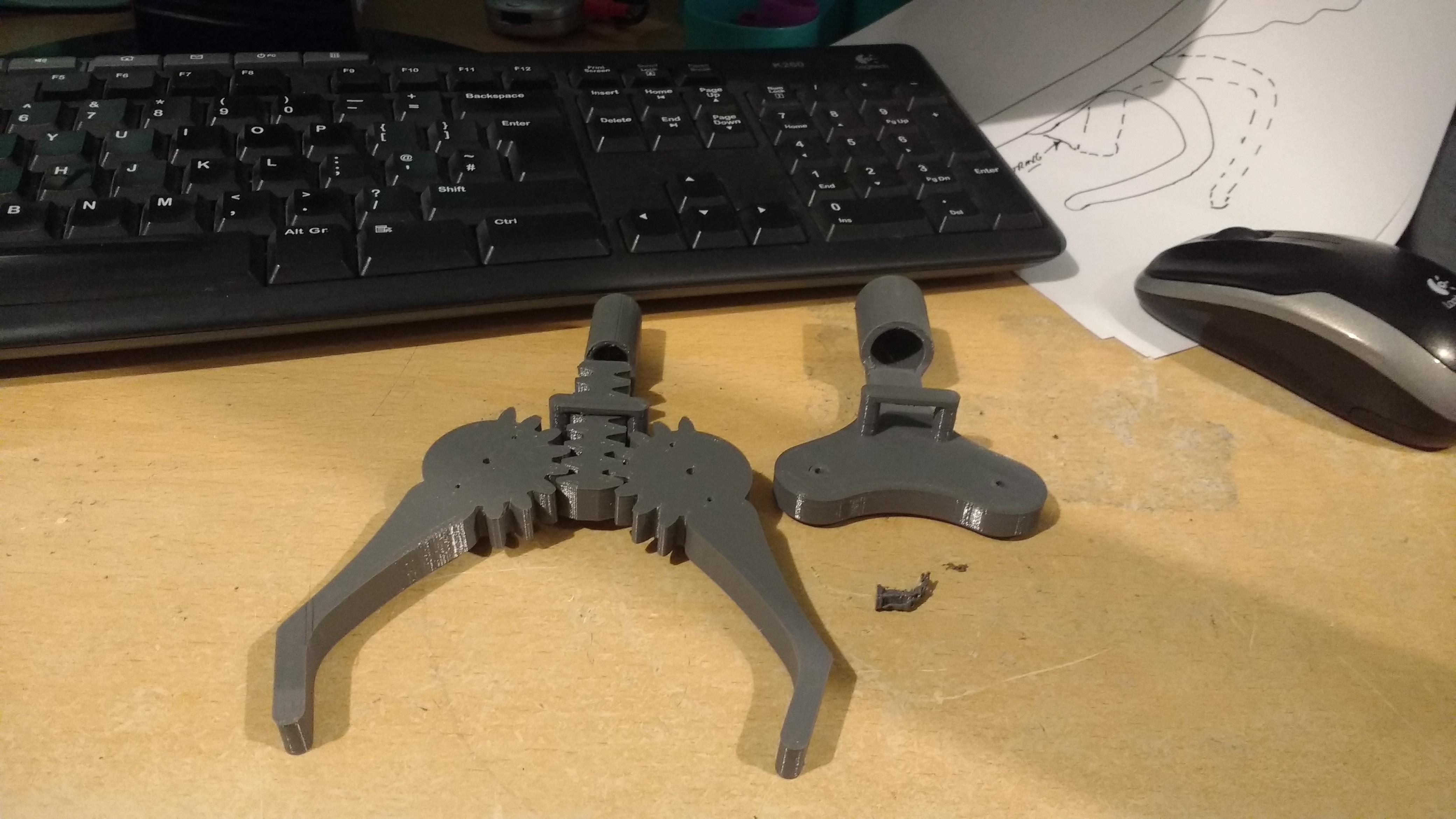

Found a business end, claw thing on Yeggi that uses a 10 or 15mm dia tube as the main shaft. Printed both options but it'll be based around 15mm copper pipe:

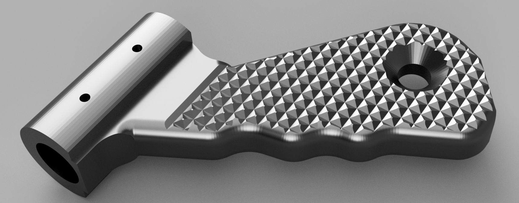

There was no design for a handle though so I came up with this. Just a render here, being printed at the moment. My lad did the chequering on the model I did:

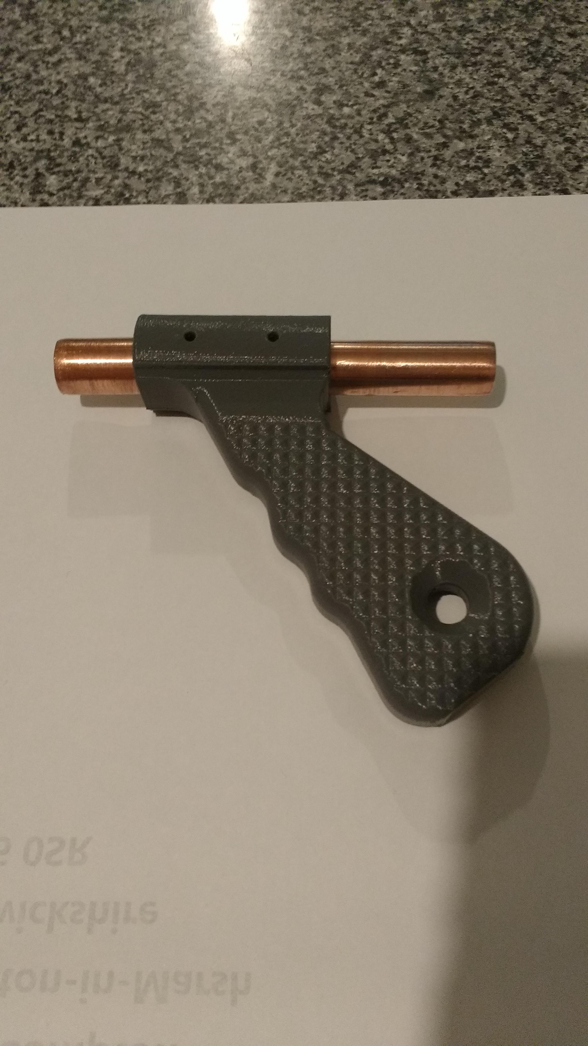

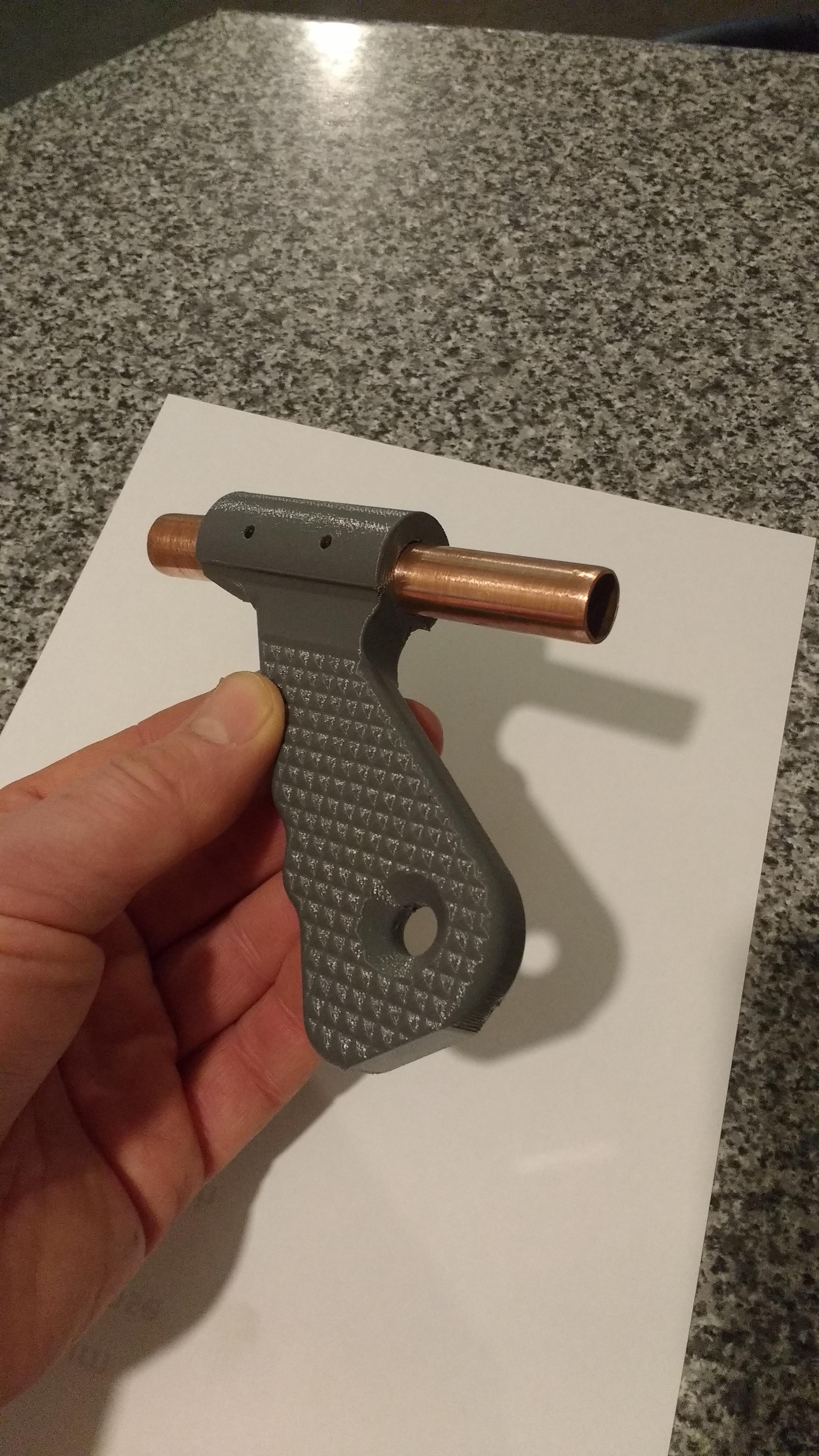

Posted

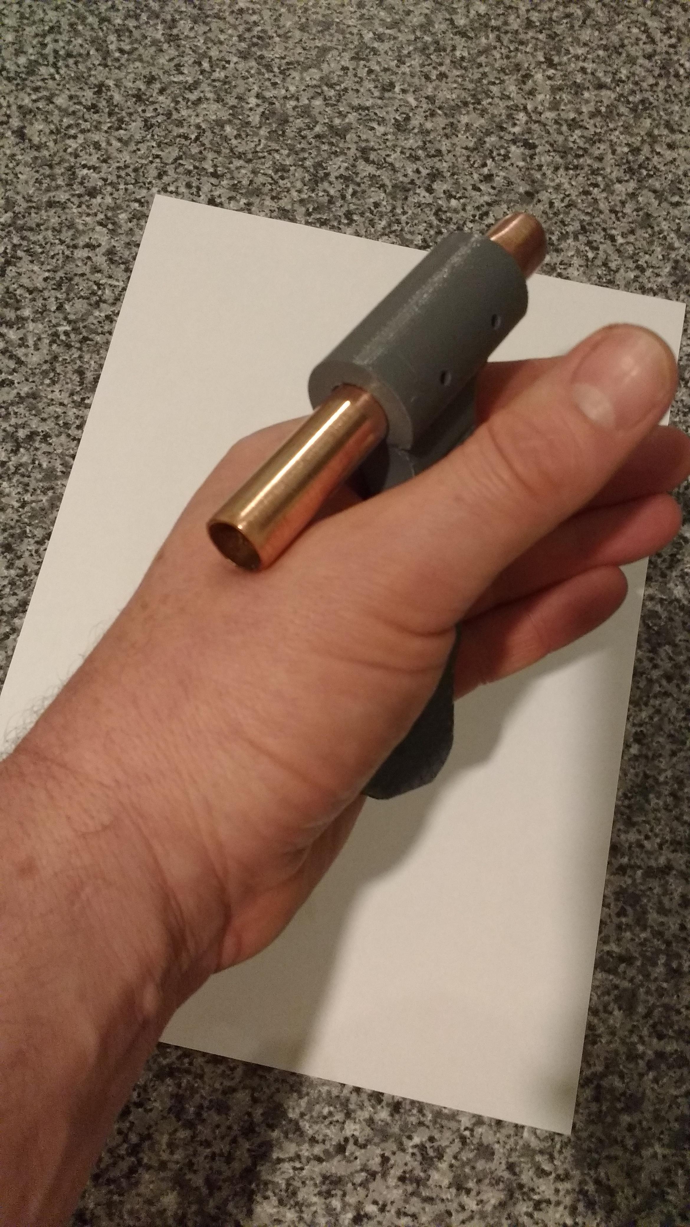

The MK1 handle is printed and the 15mm pipe is a lovely transition fit. Likely a tad loose but PETG is inherently a bit hairy I find, so that helps with grip. The holes in the grip will make it a doddle to drill through the copper and fit some roll pins to hold it together. I might even just use split pins so I can field strip it with just a Leatherman... ?
Really happy with the chequering effect my lad managed on the grip.

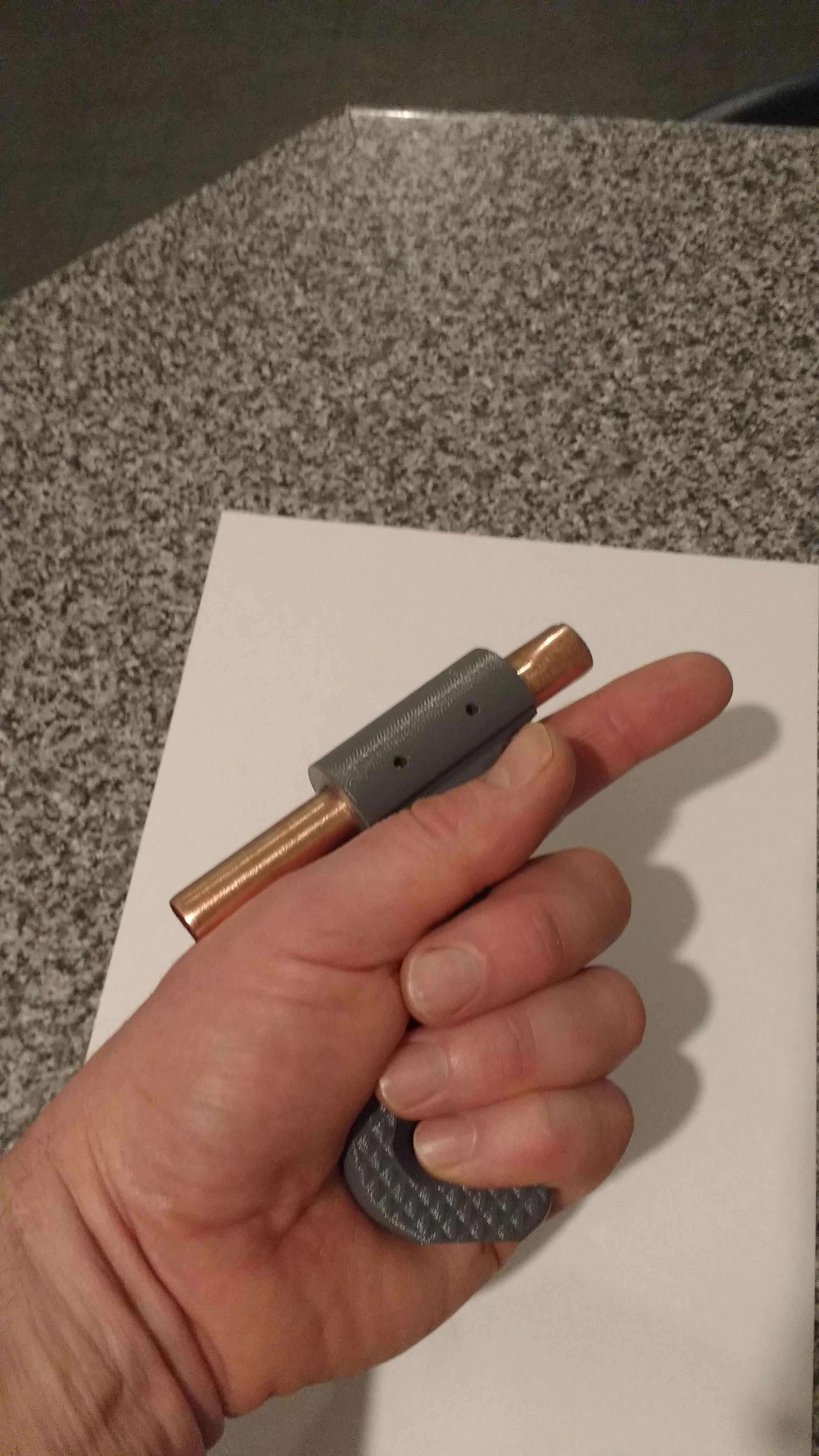

However...
The ergonomics leave a bit to be desired. I have really big hands so should really scale this up a bit. I think it looks a bit lost:
If I extend the copper out the back, up to a wrist brace, then it pushes into the flesh between thumb and forefinger. I wonder if that will rub and / or leave me with a green mark? It needs to be perfect so it's the envy of other trash pickers like an Ulfbehrt sword...
Options are to make the grip bigger, lessen the grip angle maybe or raise the tube higher. As I designed the grip by laying a real trash picker on a flatbed scanner and tracing round the image in AutoCAD I'm happy for a first go.

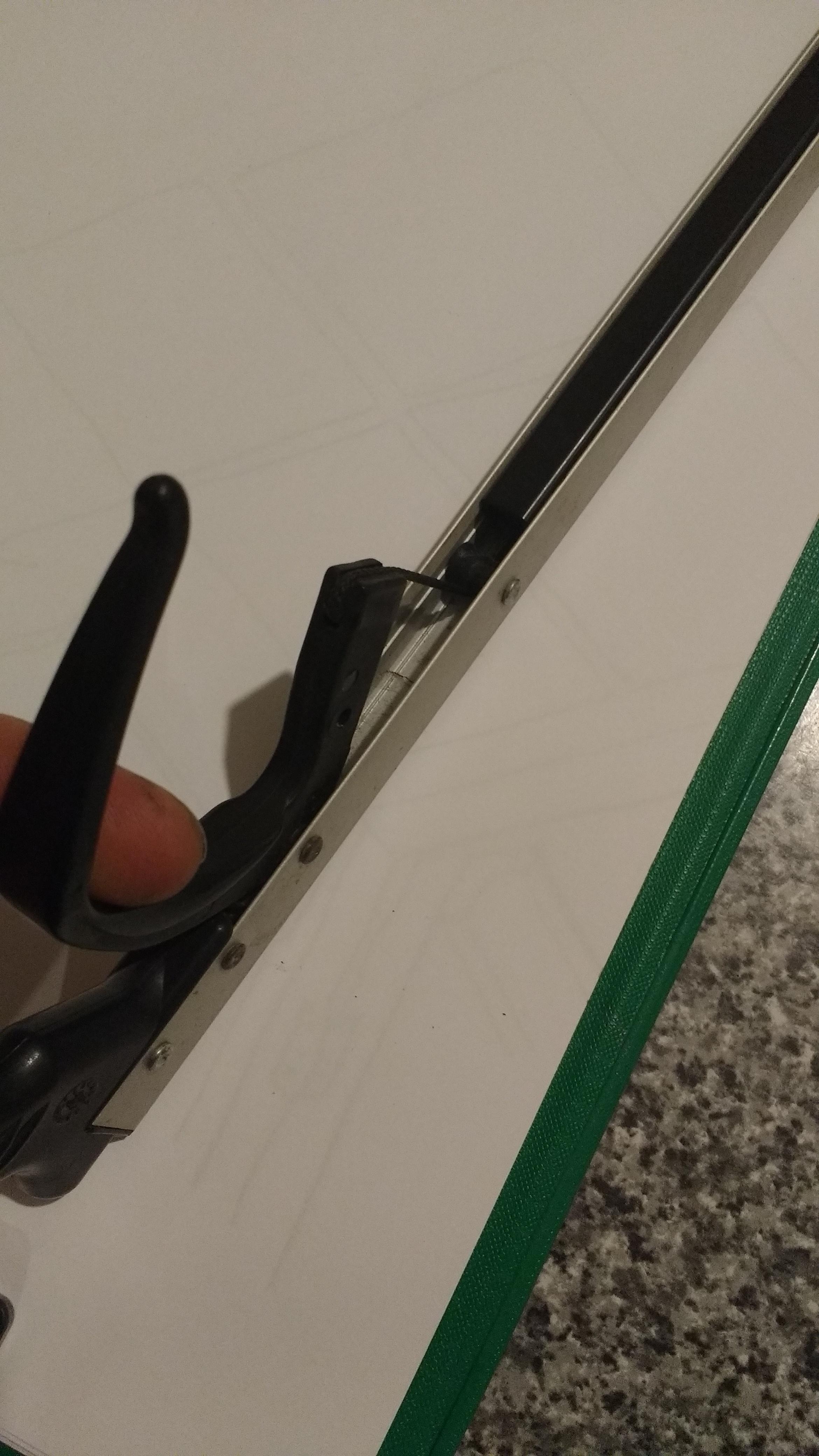

Trigger next I guess.
Posted
That's very cool. Was it using a parametric CAD like OpenSCAD?
Posted
I did the basic 3D model in AutoCAD and exported as an STL.
My lad tweaked it and added the chequering in Fusion 360 I think.

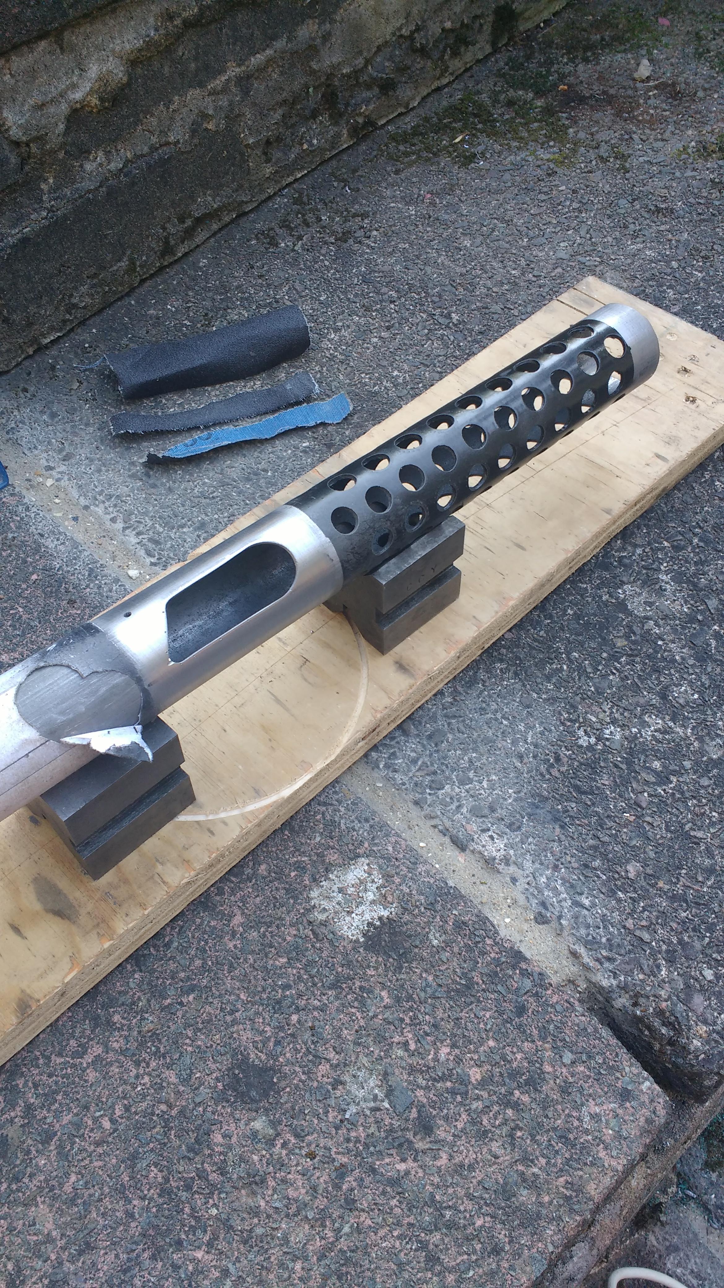

Posted
So now I have to figure the trigger (that rhymes ?).

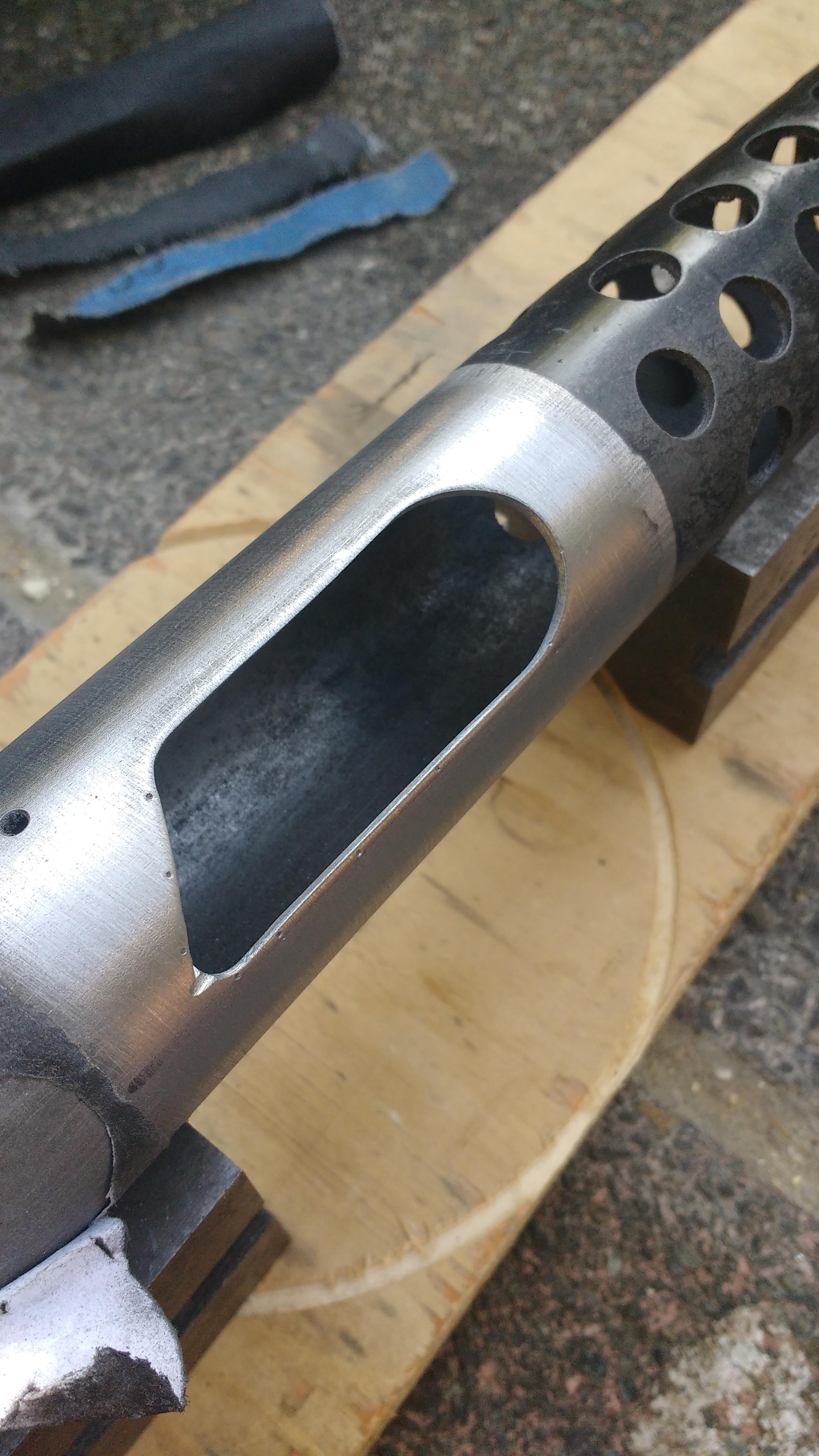

In the original box section type it's quite simple as the inside faces of the box side walls provide a bearing surface for the plastic trigger:
Shouldn't be insurmountable though. A bit of time on the CAD should have it figured. I'm thinking it'll be a case of cutting a slot with a Dremel in the underside of the copper pipe. It's amazing what you can do with a Dremel and all the various cutting discs and grinding stones, that and some needle files:
I need to sort that bottom corner where I overshot with the grinding tool.
(Yet another unfinished project ?)

Posted
Looks cool. The way I would do it in Fusion 360 (or any other cad) is to design one dimple then use the pattern tool to create a grid of dimples. It's the same tool used to make a line or rectangular pattern of identical holes.
Posted
Think he extruded a line of triangles on the X axis, then the same on the Y. To get like a "mat" of pyramids.
Posted
Yeah that sounds reasonable as well.
