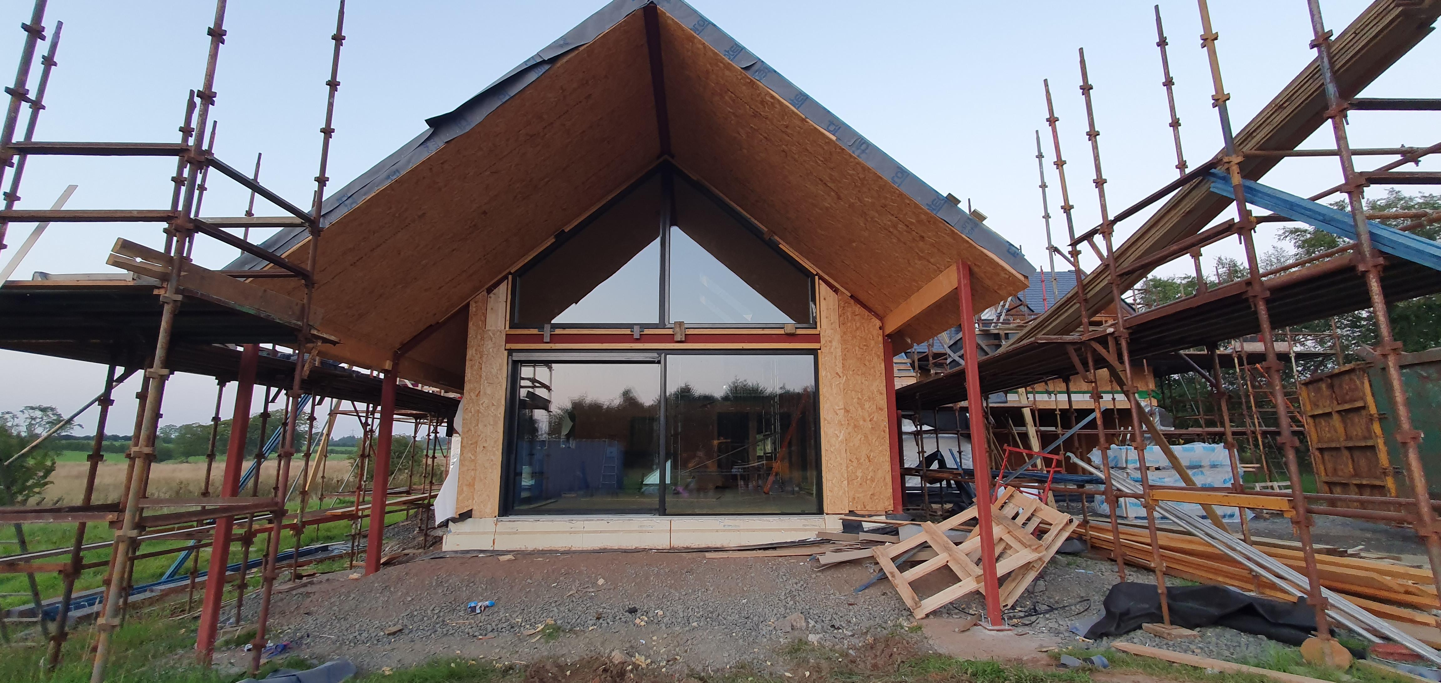

WWilts Posted December 20, 2021 Share Posted December 20, 2021 (edited) Would like differing roof overhangs on south and north elevations. Rafter pitch identical on each elevation. Hipped roof How to deal with soffit design? Edited December 20, 2021 by WWilts Link to comment Share on other sites More sharing options...
tonyshouse Posted December 20, 2021 Share Posted December 20, 2021 Draw the soffit first then the rafters then decide how to support the rafters above the inner skins of the walls 1 Link to comment Share on other sites More sharing options...

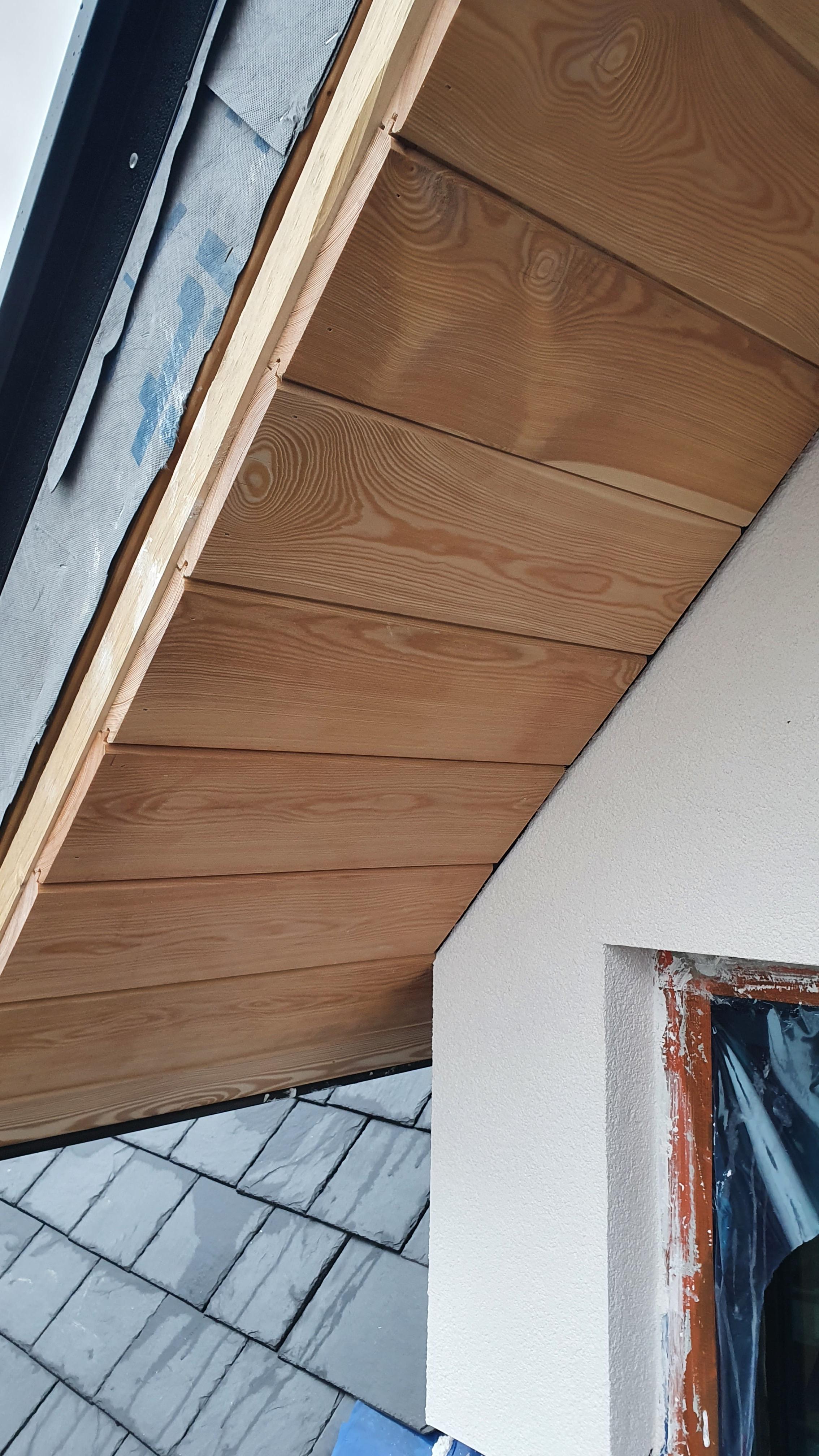

SuperJohnG Posted December 20, 2021 Share Posted December 20, 2021 (edited) Sounds a pain in the arse. ? I have different roof overhangs on an elevation. No hip though mine ends as a glazed gable with big overhang. But you could do a angled soffit to make it work, that's what I have but mostly for the look, I didn't want pork chop soffits box ends. Edited December 20, 2021 by SuperJohnG Added picture 2 Link to comment Share on other sites More sharing options...
Russell griffiths Posted December 21, 2021 Share Posted December 21, 2021 This does depend on how much you are talking about overhang wise, and also roof pitch. With a steep roof 30degrees plus you find that the wider your soffit the further the roof line comes down the walls, sometimes coming down as far as the tops of the upstairs windows. Its really all down to your roof and house design. A bit too general to answer without a diagram. I have soffit depths that range from 450mm to 1800mm. 1 Link to comment Share on other sites More sharing options...
