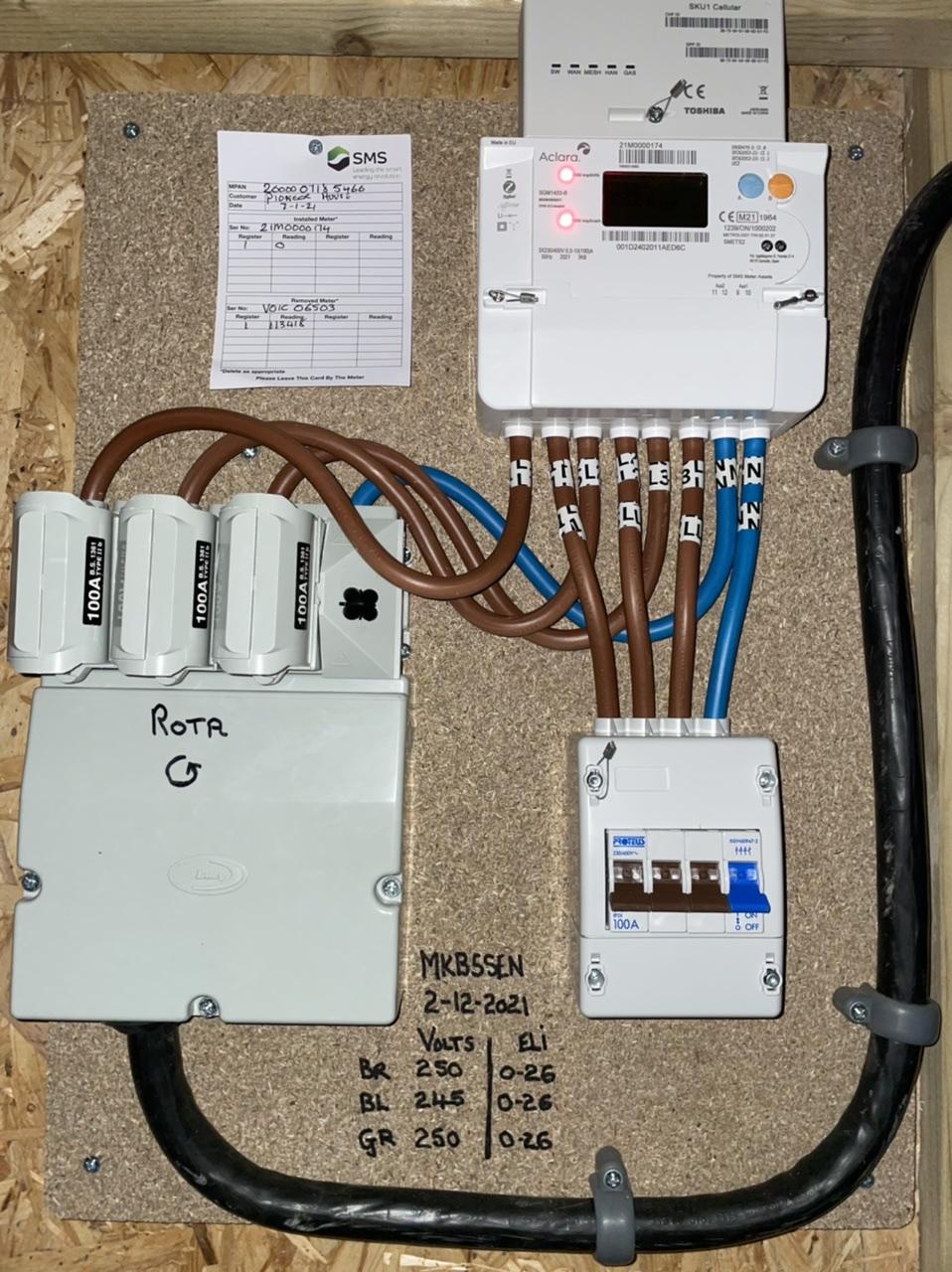

ashthekid Posted January 13, 2022 Author Share Posted January 13, 2022 Update: Attached is the 3 phase meter setup which I believe a smart meter. My plan is to stick with the 1 phase SolarEdge inverter and assign it to the phase that will have the ASHP on as that’s likely to be the biggest draw. Would I be correct in assuming that? I suppose aI could put the main elelctric cooker and few appliances onto that phase as well. Then just have all lighting and minimal loads onto another phase. Would that seem logical? Link to comment Share on other sites More sharing options...
Dillsue Posted January 13, 2022 Share Posted January 13, 2022 3 hours ago, ashthekid said: My plan is to stick with the 1 phase SolarEdge inverter and assign it to the phase that will have the ASHP on as that’s likely to be the biggest draw. Would I be correct in assuming that? Your ASHP is likely the biggest load but used at a time when youre generating the least. PV is not likely to make much of a space heating contribution in the winter, unless you have a big array. If you want the best self consumption put everything on the same phase and stagger your demand over peak generation hours with anything left going through your diverter. Link to comment Share on other sites More sharing options...
joth Posted January 13, 2022 Share Posted January 13, 2022 Yeah it looks like a v2 smart meter with the Toshiba comms hub (per Ovo). You had said you were on an analogue meter, this changes things! SMETSv2 polyphase meters use net-metering, so you can split loads and PV across the phases however you want - you'll be billed based on the net usage across all phases. Having one phase per "building" makes sense, and then drop the PV into whichever phase is on the building where the inverter sits. Ideally the inverter should be as close to the meter head as you can, to reduce the voltage differential across the line to the inverter, which can cause it to cut out if you're in a location that regularly runs over 250V. The scribbling at the bottom of the meter board does indeed make it look like you are. (Volts = 250, 245, 250). Link to comment Share on other sites More sharing options...
