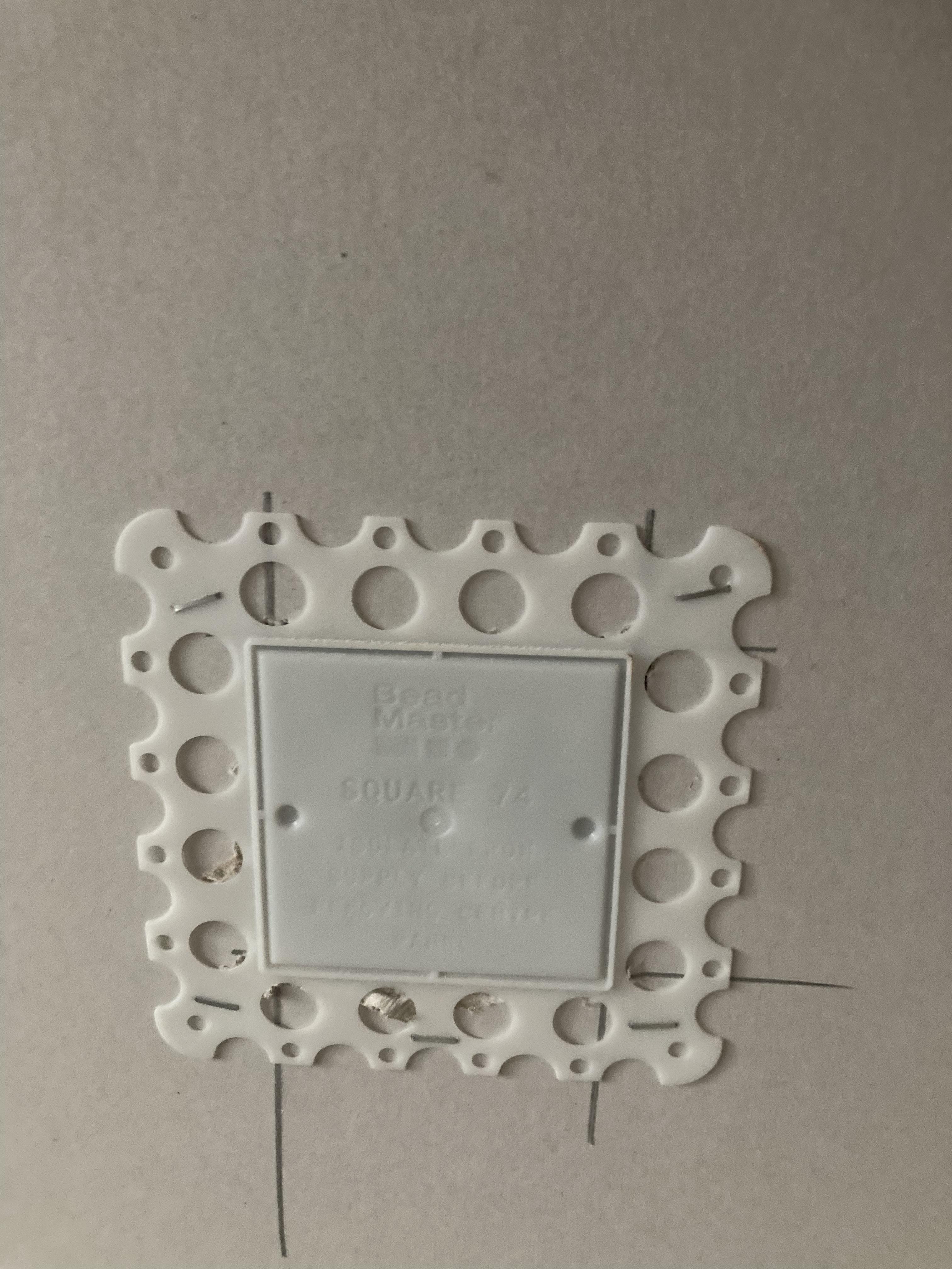

nod Posted December 8, 2021 Posted December 8, 2021 Whilst we been installing these for years on the commercial jobs More and more house builders are asking for the Easy to self install Keeps everything tidy and encourages your boarder to cut the boxes out neat Also your electrician will be happy 50 quid per house 1

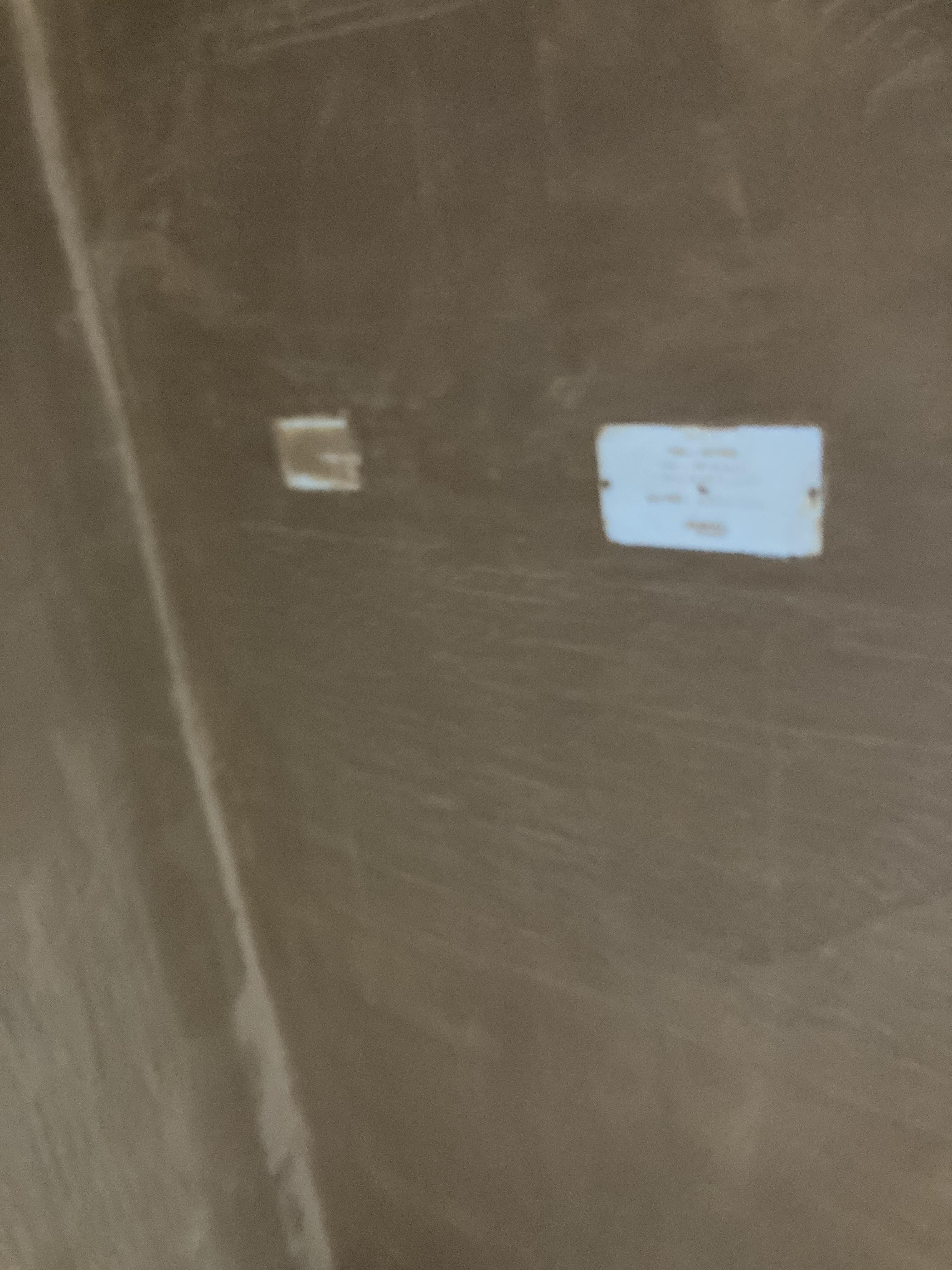

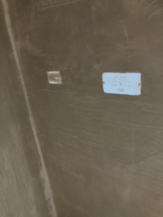

ProDave Posted December 8, 2021 Posted December 8, 2021 Have you got a link? I presume that stays on when the spread comes and the "perforated" bit gets plastered over? and the middle bit is a blank to stop the hole filling up? does it work with any back box or does it incorporate the back box (can't see with the cover plate on)?

nod Posted December 8, 2021 Author Posted December 8, 2021 54 minutes ago, ProDave said: Have you got a link? I presume that stays on when the spread comes and the "perforated" bit gets plastered over? and the middle bit is a blank to stop the hole filling up? does it work with any back box or does it incorporate the back box (can't see with the cover plate on)? Correct Dave Just use the same screw lugs Skim I’ve then give it a gentle tap Leaving a nice clean edge and wires and box just as the spark left them ?
