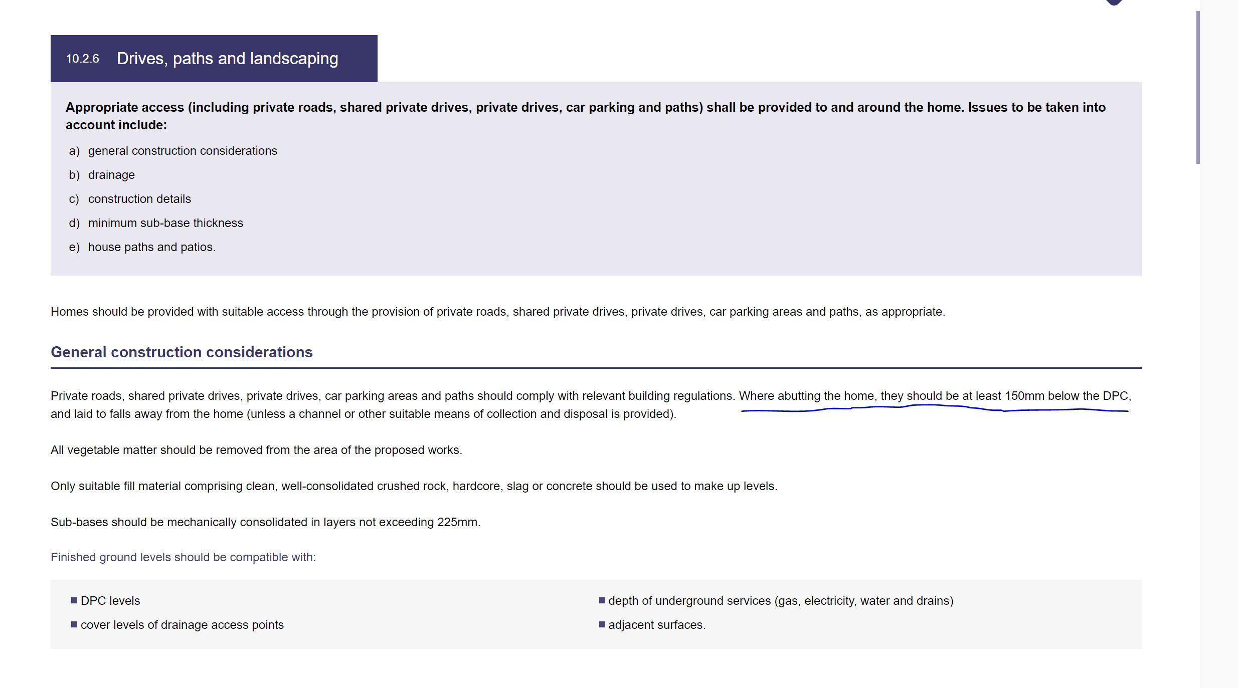

Dave Jones Posted December 6, 2021 Posted December 6, 2021 you really need 150mm below DPC unless you have a tray.

Dave Jones Posted December 6, 2021 Posted December 6, 2021 150mm below dpc (2 bricks). Maybe easier to make a feature step for the doors ? a linear drain wont stop rain splashing above the DPC, you may be ok and it not get too much weather on it to worry about then again you may not.

rh2205 Posted December 6, 2021 Author Posted December 6, 2021 (edited) We can live with 1 brick below dpc and the floors are set at dpc level. Is a linear drain or pea shingle the least risky as I don’t think we can move to a step option so we will have to hope for the best. That means the patio will be just below the silver door strip on the image. Edited December 6, 2021 by rh2205
