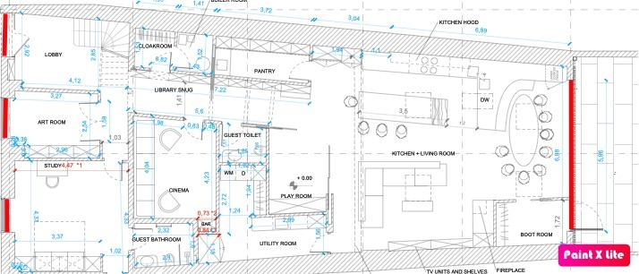

JohnMo Posted December 4, 2021 Share Posted December 4, 2021 MEV allows multiple extracts to a single outlet. In that case you ventilate the wet rooms and possibly the ones with no other ventilation. The inlet flow would then come window trickle vents and cross flow through the house. Or go dMEV, these have a fan in each wet room and have always running, low energy fans, with boost from light switch or humidity sensor. Put through wall vents (on internal walls) in the unventilated rooms. For this to work you need an air gap at the bottom of all internal doors. You window trickle vents work as MEV. Best to draw your house layout, look at where to have air going out already, where you have air coming in (window vents etc) and then can make a guess at where the air flow to and from, and see what room have no ventilation. Ventilation wants to go across a room where possible. Link to comment Share on other sites More sharing options...

ashthekid Posted December 4, 2021 Author Share Posted December 4, 2021 Here is the floorplan for the ground floor. I've marked in red the only windows we have with trickle vents. To the south there is the directly connected neighbour so no chance of any wall outlets and to the north is the neighbours garden and the solid wall from the pantry all the way to the west is an old chalk cob wall that will be impossible to have an outlet. The only place possible for an outlet is the north wall between cloakroom and boiler room. And because we are in a conservation area I cannot just have loads of modern outlets. Link to comment Share on other sites More sharing options...

PeterW Posted December 6, 2021 Share Posted December 6, 2021 Go out through the roof…? MVHR would be your friend here as you can put multiple extract points on a single plenum and fan unit. Was this not planned into BRegs submission ..? Link to comment Share on other sites More sharing options...
Dave Jones Posted December 7, 2021 Share Posted December 7, 2021 a cheaper version of mvhr is the vent axia multivent. Can pull from 3/4 rooms and dump via wall/ceiling vent. approved for building control and only a few hundred quid. https://www.vent-axia.com/range/lo-carbon-sentinel-multivent-plus Link to comment Share on other sites More sharing options...
ashthekid Posted December 7, 2021 Author Share Posted December 7, 2021 Yes MVHR would be ideal if it wasn't so expensive. I had already briefly looked into it and no company would do a small section MVHR setup, only whole house and that was running into the thousands then. Sadly I can't afford that. I can't go through the roof with any new outlets but can certainly try and merge ducts into existing roof outlets. If that's allowed by building reg standards. Link to comment Share on other sites More sharing options...
