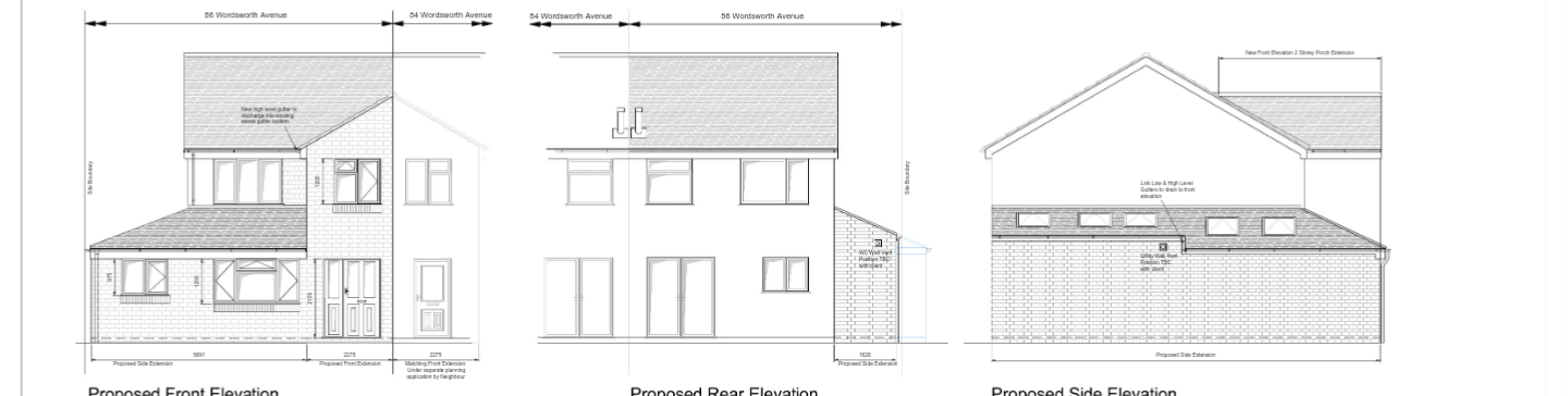

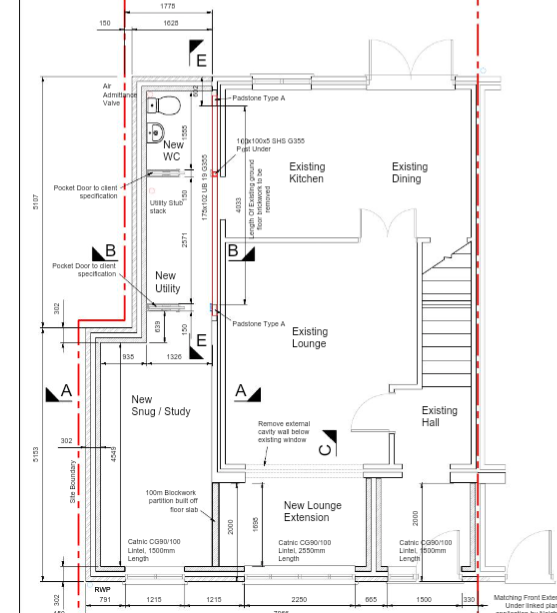

Needing to place order for brick and block work for our extension drawings attached.
Is anyone able to offer estimates on quantities needed. From DPC.
I have calculated the amount but would like to cross check with those more experienced than I.
I believe 3325 bricks and 558 blocks don't want to over order but of course do not want to leave the bricklayer short

m2 of wall minus openings x60 +10% some brickies are very wasteful, I make them use both halves of cut bricks and turn broken bricks into cuts ot halves. Seen 20% waste on big sites
blocks same but probably have to order whole packs of both bricks and blocks

Prior to approaching our brickie I had calculated the numbers previously stated of 3325.
He has estimated 4200 which I know will account for wastage but not sure if this is over cautious.
Pallets are 390 qty
9 pallets would provide 3510 bricks (185 bricks "waste")
Just after other people's views before I go back to him as I don't want to unfairly challenge the numbers.
