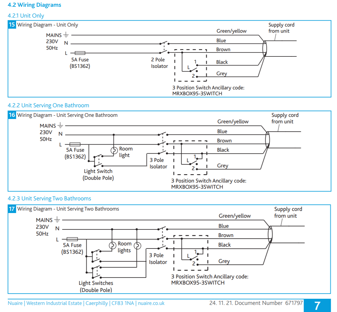

I managed to bag one of these at a bargain price a while back and now looking at first fix electrics and think it's worth running some cable for boost switches in case the internal humidity sensors don't act fast enough or if "emergency" boost is required.
I have a MRXBOXAB-ECO4 manual (will need to get one more as the design is for 2 units largely due to duct run lengths). These units will serve:
Unit 1: 2 x en-suite bathrooms + 1 separate WC + kitchen + utility
Unit 2: 2 x en-suite bathrooms + 1 separate WC
I'd like to have something simple so not wanting to link this up with home automation. ideally I'd have a retractive switch in each en-suite (possibly also WCs) and in the kitchen to trigger boost for a set duration. I can't see in the manual if that is possible - there is mention of the eco-smart sensor connectors and optional switches etc which looks like buying some more Nuaire bits - which is OK if needed but may be nicer switch options. Doesn't look like enough info in the manual to see how you can wire up a simple momentary switch to trigger a boost as far as I can see but if anyone has already done this or can see a way that would be super helpful.

The install guide isn't so helpful seems to refer to wiring into the lighting circuits for boost when bathroom light is on. Feels like there should be a more in-depth guide also covering the grey wire which I think is for the max boost trigger (with black being normal boost)

mid position with no feed as ‘normal’, black is boost and grey super boost..?

Traditional - momentary switches in each location with a switched live connected to some sort of central component that will allow any of the inputs switched to trigger the switch live to the MVHR on the boost line (for now just thinking about using the std boost). Just not sure what the intermediate thing would be called?

You can use a latching or timer relay if you don’t want to use HA - this would do it. You can set the on time for as long as you want (10 mins etc) the do all the switches in parallel.

I'd suggest going with the Shelly relay option acting as the boost controller with physical switch inputs thus giving 'standalone' functionality with no external dependencies. You could program different boost durations for short vs long switch presses if you wish.
If you then wanted to add event-driven HA control later just get HA to request the boost via Shelly's HTTP API.
