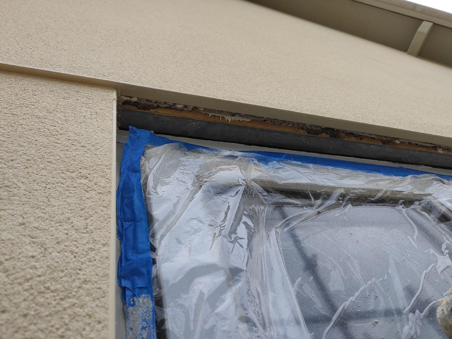

MortarThePoint Posted November 24, 2021 Posted November 24, 2021 We have render coming down onto a bellcast bead above windows. There's a gap between the bead and the lintel. Can anyone recommend something fill this gap?
Russell griffiths Posted November 24, 2021 Posted November 24, 2021 Upvc window trim, colour to match windows or render.
MortarThePoint Posted November 24, 2021 Author Posted November 24, 2021 17 minutes ago, Russell griffiths said: Upvc window trim, colour to match windows or render. Could do. I think that could be hard to get looking neat. I was hoping to use some form of caulk or something. If black, I could then paint the lintel black. If ivory could match render. Needs to be exterior grade though obviously
Mr Punter Posted November 24, 2021 Posted November 24, 2021 I can't work out why there is a gap, but it may be good to cloak the lintel and the gap it in whatever material the windows are finished in.
Dave Jones Posted November 24, 2021 Posted November 24, 2021 5 hours ago, Russell griffiths said: Upvc window trim, colour to match windows or render. yup this, will look fine.
MortarThePoint Posted November 24, 2021 Author Posted November 24, 2021 4 hours ago, Mr Punter said: I can't work out why there is a gap, but it may be good to cloak the lintel and the gap it in whatever material the windows are finished in. The lintel doesn't quite come to the face of the blockwork and then the render bead is pressed into the render basecoat. The gap is about 8mm.
