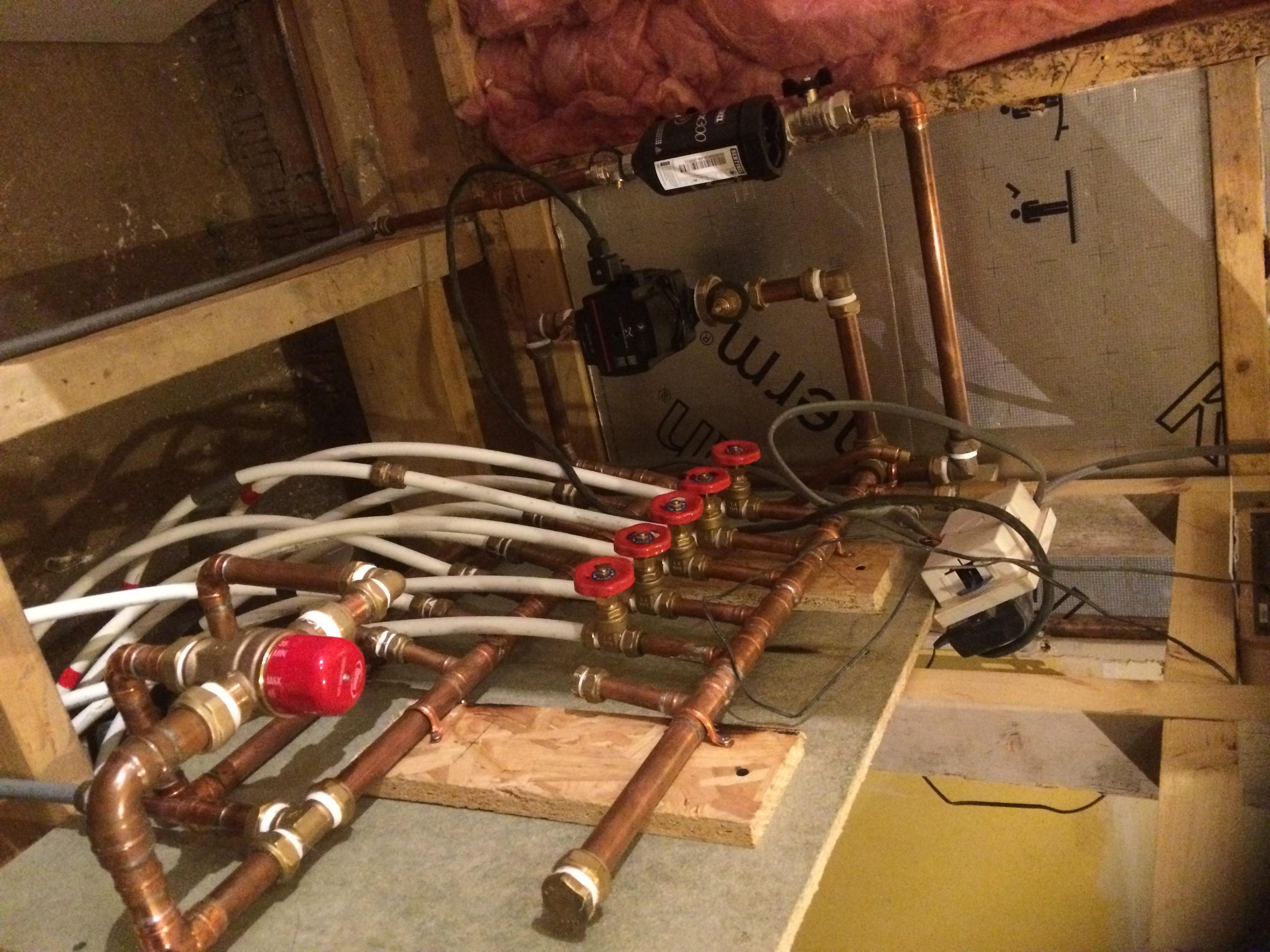

Gus Potter Posted November 21, 2021 Posted November 21, 2021 6 minutes ago, Nickfromwales said: I did a full heating install in a 300m2 build, with insulated raft, and it ran at 18.5oC with an outside air temp of -7 with a £35.77 3kW Willis heater. There were 2 installed, but one tripped out over the xmas away period and I discovered it upon my return to site. That was with 2x 200mm open vents through the roof to atmosphere ( where we were due to connect the MVHR unit later downstream ). As above, if the fabric & ventilation heat losses are managed you can heat with VERY little input, so the 15kW device will more than suffice. I would put the UVC on W-plan ( hot water priority ) so it can focus on heating OR hot water vs the 2 combined. You mention a "heat only" boiler, but I'd recommend a "system" boiler so you get the expansion, pump and pressure gauge etc all in one box. Heat only will require a lot of kit outside the boiler so is unnecessarily complicated IMO. Plenty around from £600 upwards, but the Worcester Bosch for a grand is a decent machine with a very low modulation. Intergas and Viessmann IIRC offering as low as 1 1/17th!! Nick Thank you for you posts.. learn something new all the time. I posted this a while ago but I made a DIY temporary UF manifold.. it's working great although I had a pro plumber to do the boiler as I was out of my depth with the gas. I've not touched it since getting it working about a year ago.. few controls.. just shows you how simple a UF heating system can be.. and cheep to maintain. Less valves, electronics.. it's good cost effective engineering. If you are not bald with the above have a look below. xxx
Nickfromwales Posted November 21, 2021 Posted November 21, 2021 Yup. The only thing missing is flow gauges so you can set the flow rates, but you can do that with a bit of maths ( length of loops vs % that you open each gate valve ) so all good. Nice Reliance TMV on that rig, so that will be plenty reliable for sure.
